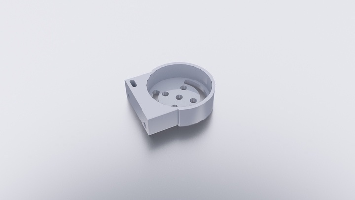

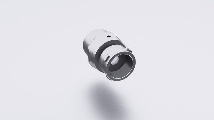

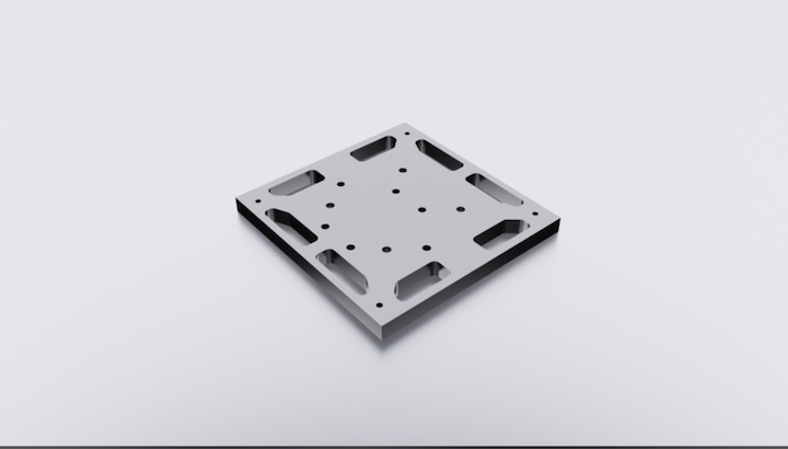

For the purposes of this article, we will consider a part to be either: high, medium, or low complexity. A part is medium complexity if all the complexity levels established are a mixture of medium and low complexity. A part is high complexity if any of the high complexity levels are established. A low complexity part doesn’t have any medium or high complexity levels established. Here are some rendered examples of parts to give you a visual comparison:
Low Complexity | Medium Complexity | High Complexity |

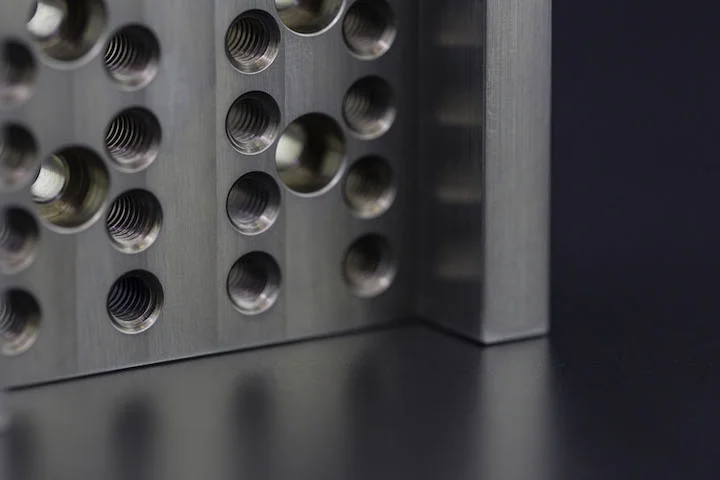

Holes
![Complex Fictiv part with numerous holes](https://www.fictiv.com/wp-content/uploads/2023/01/CNC-Materials_1018-_Steel_5349.jpeg)
Machining deep holes, cavities, or taps also requires specialized tooling, an experienced machinist, and cautionary machining settings. These deep features also are more likely to cause tool breakage.
High Complexity Holes:
- Deep holes, cavities, or taps defined by a depth: diameter of ≥10:1
- and/or more than 15 individual holes
How to Reduce this Complexity:
- Reduce the depth-to-diameter ratio
- and/or reduce the number of holes

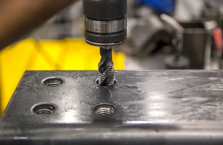

Threads
![tapping a hole in a metal part](https://www.fictiv.com/wp-content/uploads/2023/02/tapping-a-hole-in-a-metal-part-.jpeg)
One of the simplest methods for producing threads is via a CNC machine using a pre-set thread milling program. The program guides the CNC machine to cut or tap the thread profile into the material, typically after drilling a hole. Thread milling programs also account for the diameter of the thread, the thread pitch, the thread angle, and the length of the thread. Standardized threads have readily available tooling that conforms to UNC, UNF, M, MF, and ACME standards. Non-standardized threads require special tooling and custom thread milling programs.
High Complexity Threads:
- Non-standardized: custom, proprietary, obsolete, or industry-specific
- Choose only standardized threads (this makes life much easier)
- Provide tooling for non-standardized threads

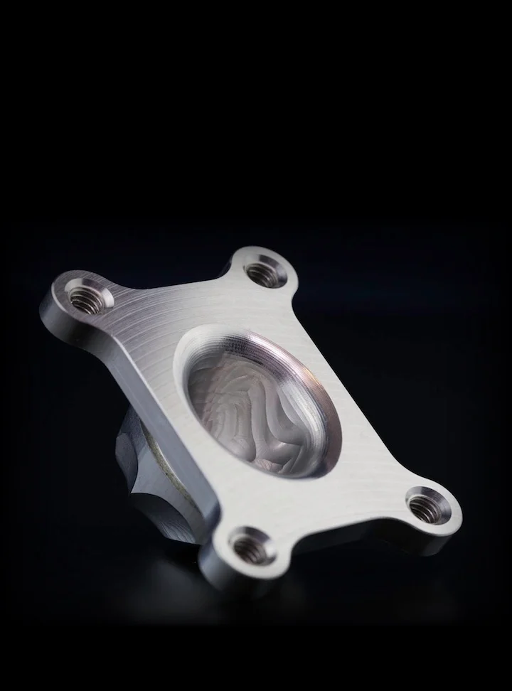

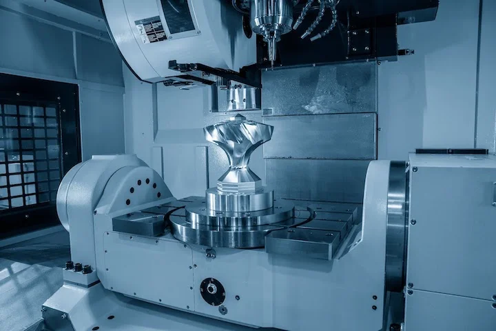

Surface Curvature
![CNC machining a part with complex surface curvature](https://www.fictiv.com/wp-content/uploads/2023/02/CNC-machining-a-part-with-complex-surface-curvature.jpeg)
Curved surfaces are more difficult to inspect and can be more difficult to machine. A curve is defined as a continuous line without any straight segments. For example, circles, ellipses, parabolas, and hyperbolas.
High Complexity Surface Curvature:
- Compound curves or a significant amount of angled machining
Medium Complexity Surface Curvature:
- Less than 30% of the surface area is angled
Low Complexity Surface Curvature:
- Exclusively vertical and horizontal walls and <10% of the surface area has slanted sizes, no compound curves
- Reduce the number of surfaces with angles

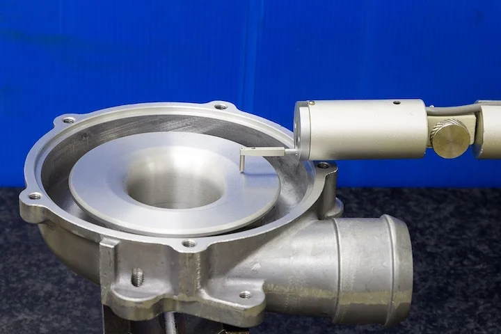

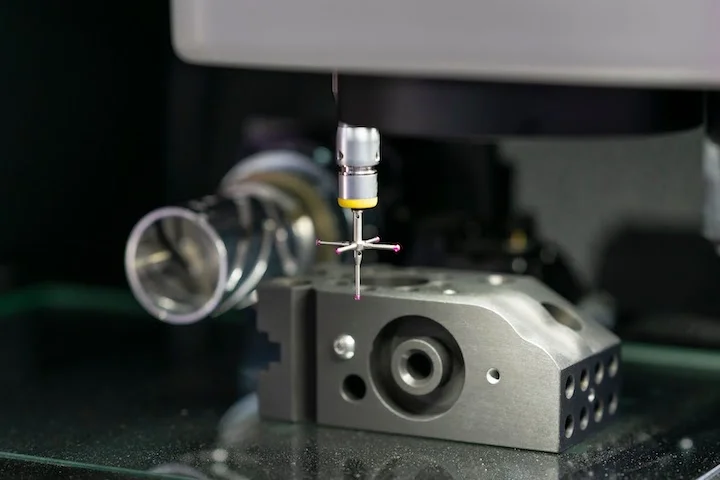

Tolerancing
![CMM measurement of a complex part](https://www.fictiv.com/wp-content/uploads/2023/02/CMM-measures-part-dimensions.jpeg)
Tolerances have the biggest impact on part complexity. Tight tolerances means more precise machining, more intensive quality control measures, more sophisticated measuring equipment, and typically more inspections.
Pro-Tip: Check out our tolerance analysis calculator to perform a tolerance stack up analysis with just a few clicks.
High Complexity Tolerances:
- Any tolerance is <0.002 mm
Medium Complexity Tolerances:
- All tolerances are >0.002mm
Low Complexity Tolerances:
- All tolerance values are >0.06mm
- Only use tight tolerances where absolutely necessary

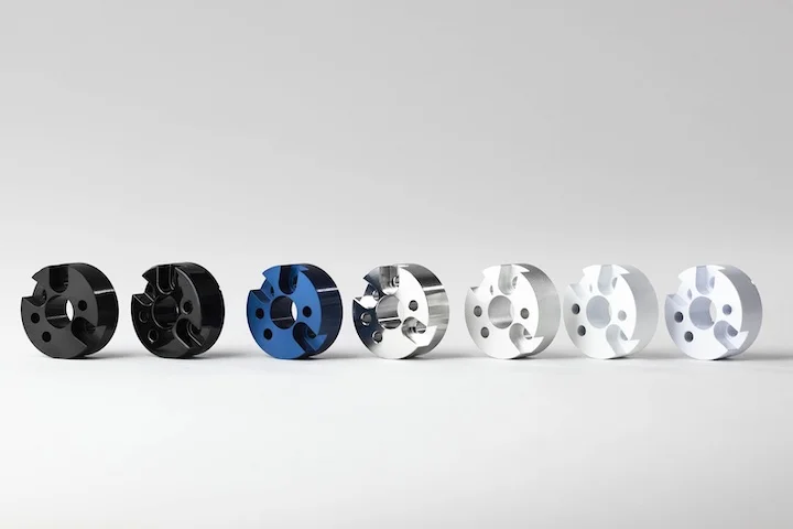

Finishing
![finishing options offered by Fictiv](https://www.fictiv.com/wp-content/uploads/2023/02/finishing-options.jpg)
Often, material options aren’t ideal for your application. Maybe your parts must withstand a corrosive environment, high wear, extreme temperatures, or just water. Finishing encompasses all surface modification of parts to provide them with extra benefits or altered properties. Finishing includes: passivation, anodizing, painting, plating, bead blasting, heat treating, and many more.
Pro-Tip: Check out the Ultimate Guide to Finishing CNC Machined Parts , it’ll help you pick the best finish for your application!
High Complexity for Finishing:
- Any finishing requirements
- There’s a whole world of materials; many new materials don’t require finishing
- When necessary, choose simple finishing processes or ones that are more environmentally friendly (they tend to cost less)
