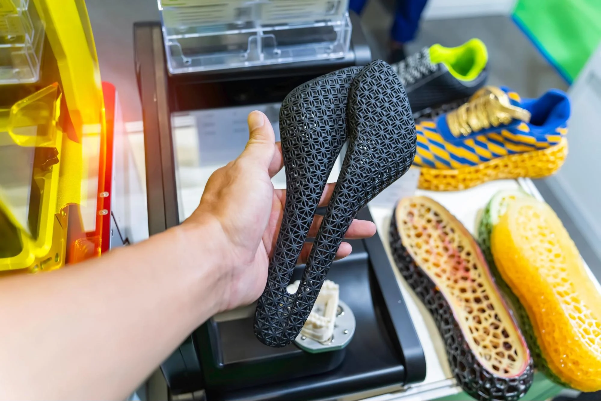

TPU material used for 3D printing bike seats and shoe soles.

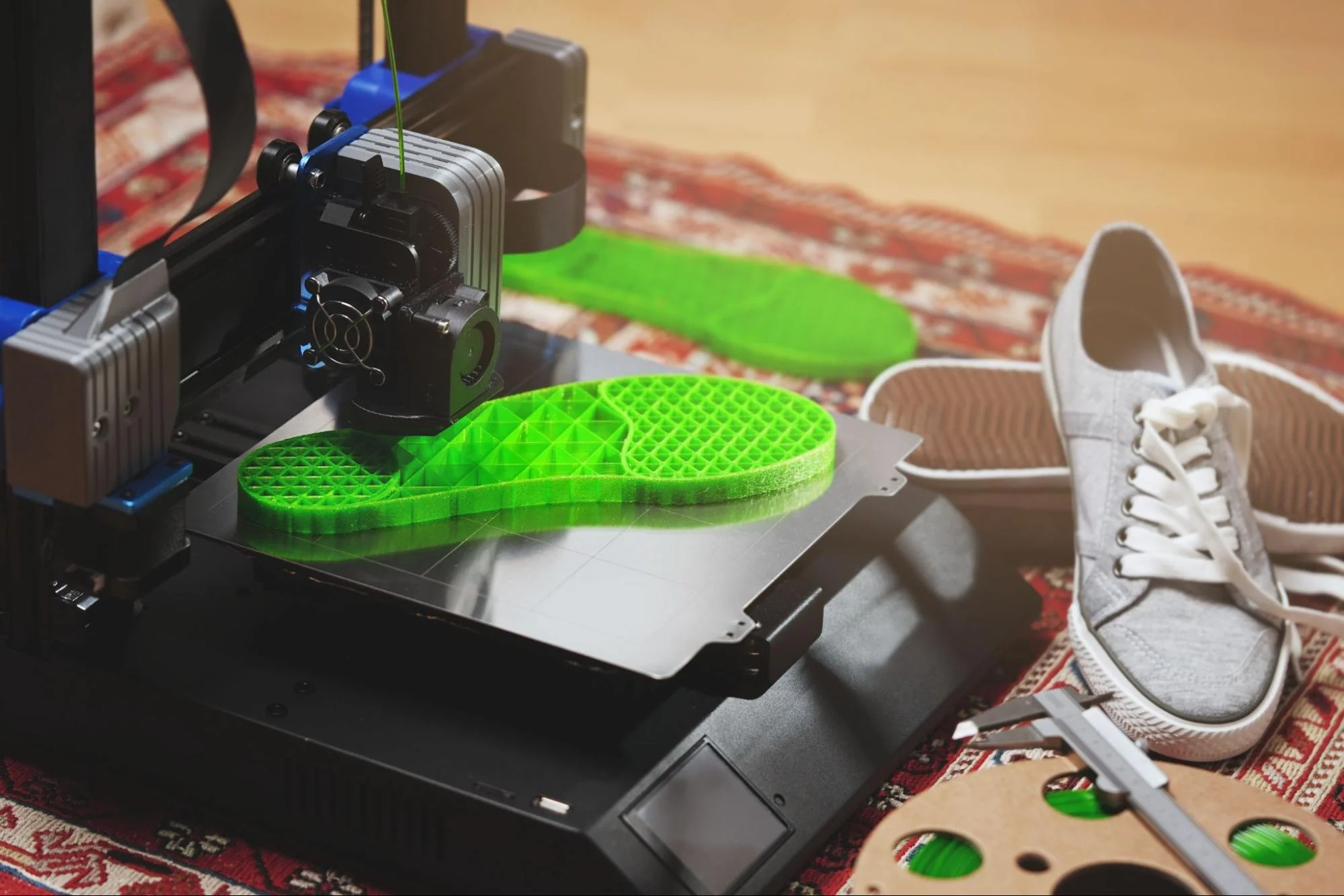

FDM Printing With TPU
FDM printing with TPU filament is arguably the most accessible way to print flexible parts. It’s practical on desktop or hobbyist machines, but can also be used in industrial printing applications.
However, printing TPU with the FDM process requires careful tuning of print settings, such as feed rates and bed temperatures. This is because the filament is soft and elastic (making it more susceptible to buckling or retracting improperly). For best results, use a direct-drive extruder, short filament paths, slow speeds, minimal retraction, solid bed adhesion, and proper part supports.
Strengths: Affordable, easy to learn, low machine cost, good for making flexible prototypes or low-volume parts.
Weaknesses: Anisotropic strength (varying according to direction), slower printing speeds, potential print issues (stringing, filament buckling), and lower strength compared to SLS-printed parts.

SLS Printing With TPU
SLS uses a laser to sinter successive layers of a bed of TPU (or other material) powder in a pre-programmed pattern to create parts. This process offers high accuracy, isotropic mechanical properties (i.e., similar strength and elasticity along all material axes), no need for support structures, and suitability for high-volume production.
Strengths: Higher accuracy, better material properties (isotropic), suitable for functional end-use parts, complex geometry (e.g., lattice structures, internal channels).
Weaknesses: Higher cost, requires a specialized industrial printer, and surface finish may need more post-processing than FDM prints.

FDM Settings for TPU Printing
  • Nozzle (extruder) temperature: ~220–250°C (depending on filament brand).
  • Bed temperature: ~40–60°C (for good adhesion).
  • Print speed: 15–30 mm/s is often recommended for the filament feed to prevent stringing, warping, or under-extrusion.
  • Retraction: Minimal or ideally none (because flexible filament tends to jam if retracted too much).
  • Cooling: Use moderate cooling. Excessive cooling of early layers can inhibit bed adhesion. Use a low fan speed after the initial layers.
