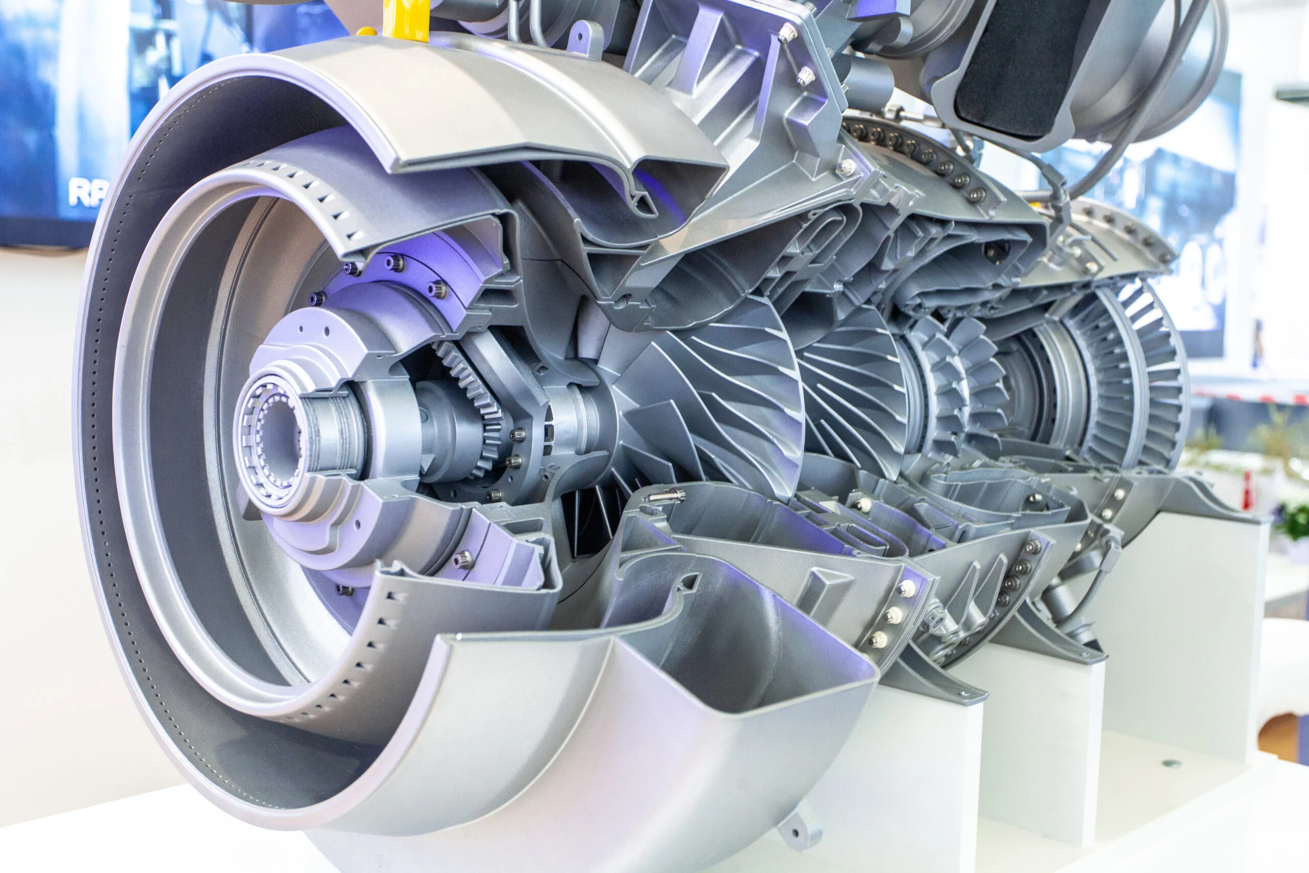

Aerospace Market Segments and Their Manufacturing Requirements
Aerospace manufacturing requirements vary with the aircraft or vehicle, operating environment, certification basis, production volume, mission, and consequences of failure.
aerospace plane engine cross section
