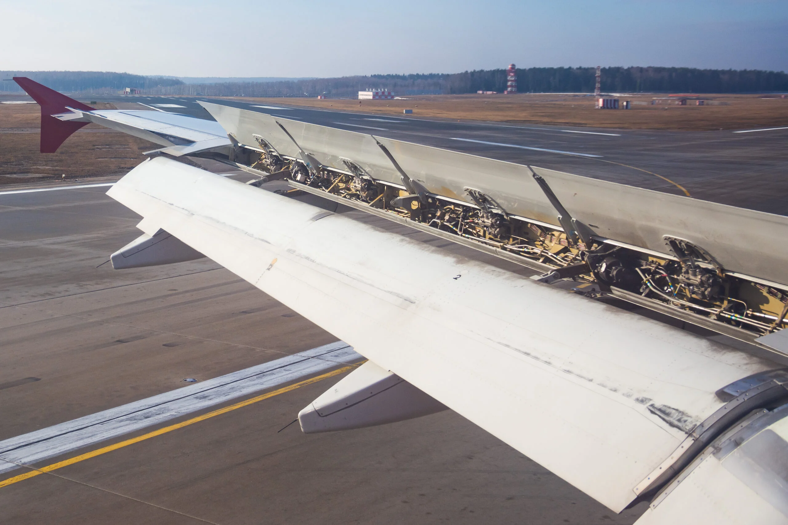

Sheet metal used for airplane wings aerospace materials
Airplane wing sheet metal

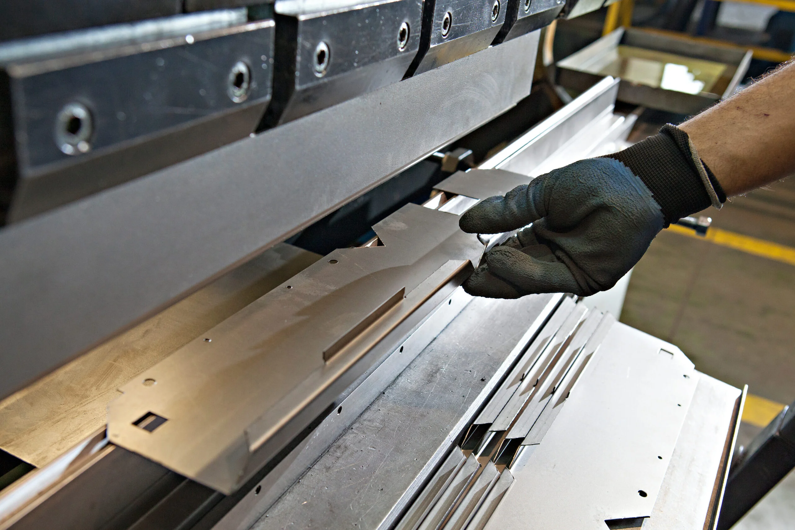

Sheet metal bending with press brake

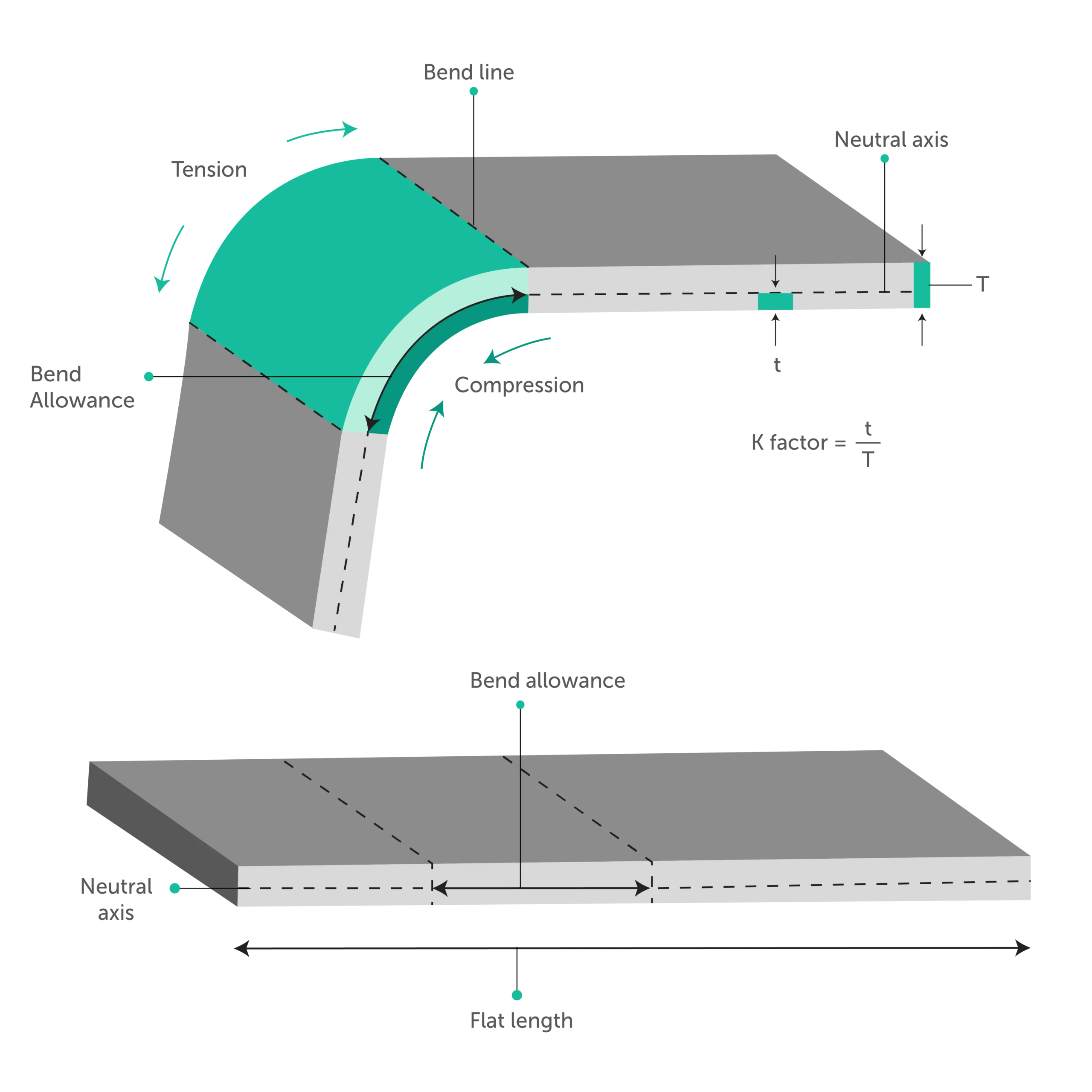

Minimum Bend Radius and Temper
Minimum bend radius is a function of thickness and material condition. A starting point for ductile alloys such as 5052-H32 is:
inside radius (r) ≥ material thickness (t)
The actual value is derived from alloy, temper, grain direction, thickness, and material datasheets/certification. Higher-strength tempers require larger radii.
Bend-to-Hole Clearance
Features positioned too close to a bend can distort, as material flows during forming. A practical starting guideline allows a distance of at least 2t + r from the bend centerline for holes under 25 mm. Larger holes can impose greater clearance needs. This is especially important around fastener patterns, where a distorted/displaced hole can become a potential fastener fail point.
Grain Direction
Rolled sheet exhibits anisotropy (directionally-dependent mechanical properties). Bending across the rolling direction minimizes resultant cracking risk. This becomes increasingly critical as material strength rises, or bend radius decreases. For fatigue-critical parts, grain direction is a controlled manufacturing parameter, not driven by nesting optimization.
Springback
Springback in 5052 tends to be comparatively predictable. Hardened aluminum alloys, stainless steel, and especially titanium demand increasing compensation. First-article inspection (FAI) is critical because manually forcing a misbent component into place is forbidden in aerospace applications due to the residual stresses introduced. Angular dimensions must have appropriate tolerance bands based on material type, thickness (t), grain direction, and the forming process limits.
Bend Allowance
Sheet metal bend allowance
