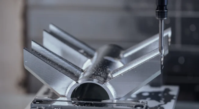

CNC machining supports design complexity, but titanium poses special challenges.
Tips for CNC Machining Titanium
Titanium can be machined with CNC milling, turning and lathing, drilling and boring, utilizing a multi-axis precision machine. Each process involves different operations and has benefits and challenges.
- Milling uses rotating tools to shape parts and requires managing speeds and coolant levels to prevent tool wear.
- Turning and lathing rotate the titanium workpiece while a stationary tool shapes it. It’s ideal for cylindrical parts but requires careful handling to avoid excessive vibrations and ensure a smooth finish.
- Drilling and boring are two similar processes. Drilling creates precise holes using sharp bits. Boring enlarges these holes and is used to meet tight tolerances.
- 5-axis machining is the most advanced process, allowing the titanium workpiece to move along five different axes. Because it can create intricate parts with fewer setups, it’s particularly useful in aerospace and medical applications.
