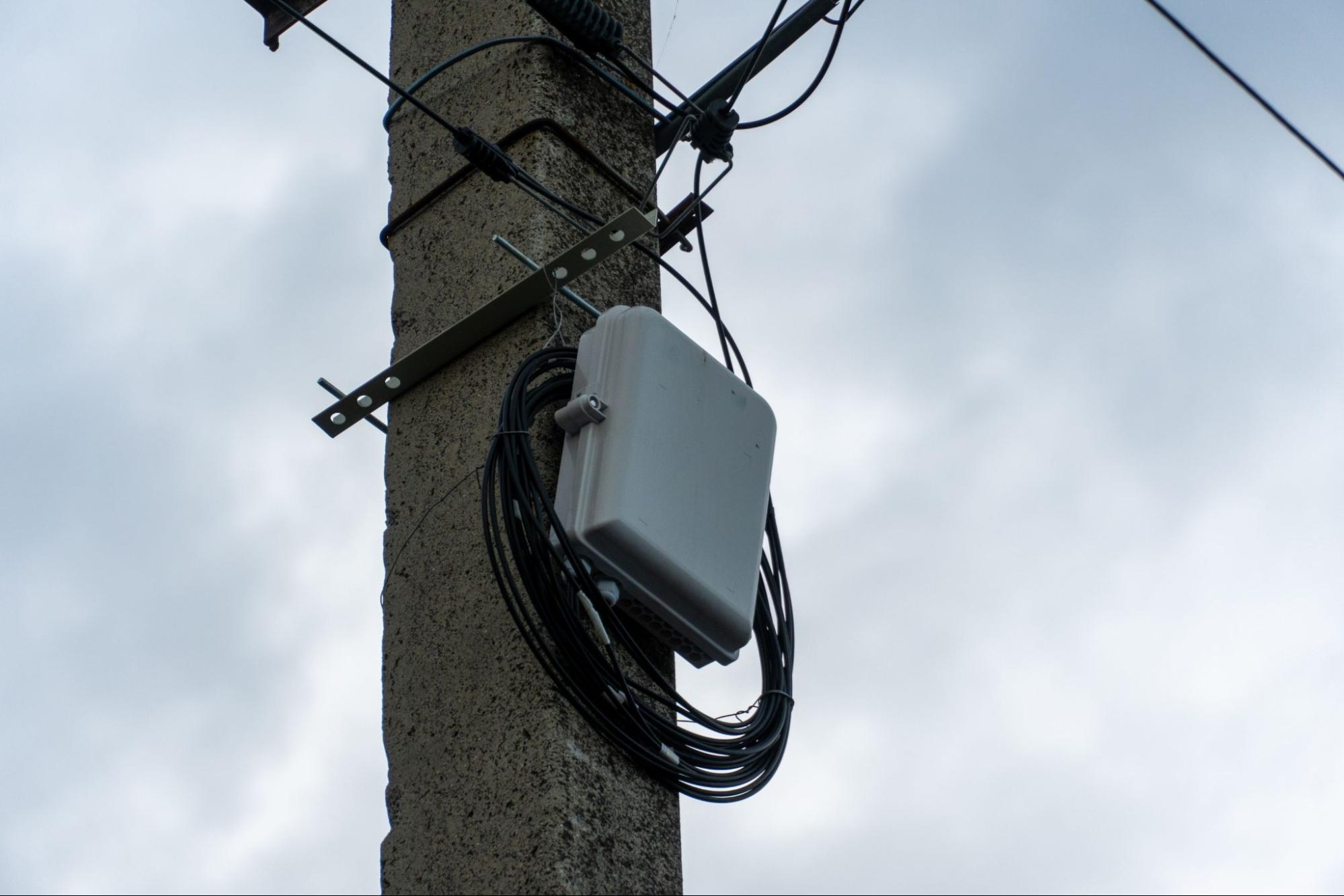

Rugged Enclosure Design & Sealing Strategies
Effective enclosure and sealing design for extreme conditions begins with understanding how the assembly’s materials behave under load, temperature, and environmental exposure. Seals, fasteners, and enclosure components must work together to maintain protection over time.
Two commonly referenced protection standards are Ingress Protection (IP) ratings and National Electrical Manufacturers Association (NEMA) enclosure ratings. IP ratings define the degree of protection an enclosure provides against the entry of solid particles and liquids. NEMA ratings also address ingress protection, but include additional requirements related to corrosion resistance, environmental durability, and enclosure construction guidelines for specific industrial applications.
Understanding the difference helps engineers select specifications that match the actual service environment rather than relying on ratings that may address different operating assumptions.

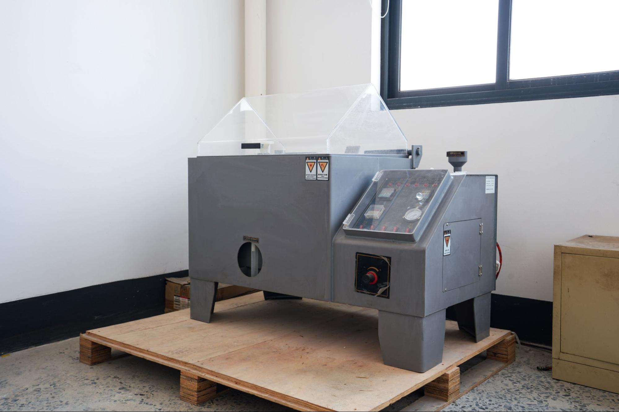

Validation & Environmental Testing
Because multiple stresses can interact, environmental validation should combine modeling and testing. Modeling predicts issues like constrained thermal expansion, while targeted tests confirm durability under realistic conditions. Accelerated life testing (ALT) simulates long-term degradation by exposure to higher temperatures, humidity, corrosion, or vibration over a compressed time frame.
Thermal cycling chambers reveal expansion mismatch failures. Salt spray testing exposes corrosion pathways, and ingress testing verifies sealing performance. Environmental validation aligns with product development phases—such as Engineering Validation Testing (EVT), Design Validation Testing (DVT), and Production Validation Testing(PVT)—with each phase building design confidence before moving forward.
Sealing performance depends on controlled parameters: groove depth precision, surface flatness, and coating thickness uniformity. Production variation beyond DVT limits can undermine prototype reliability. Define the environmental validation plan, methods, criteria, and sample sizes before tooling release. Prove performance with data, never assume it.
