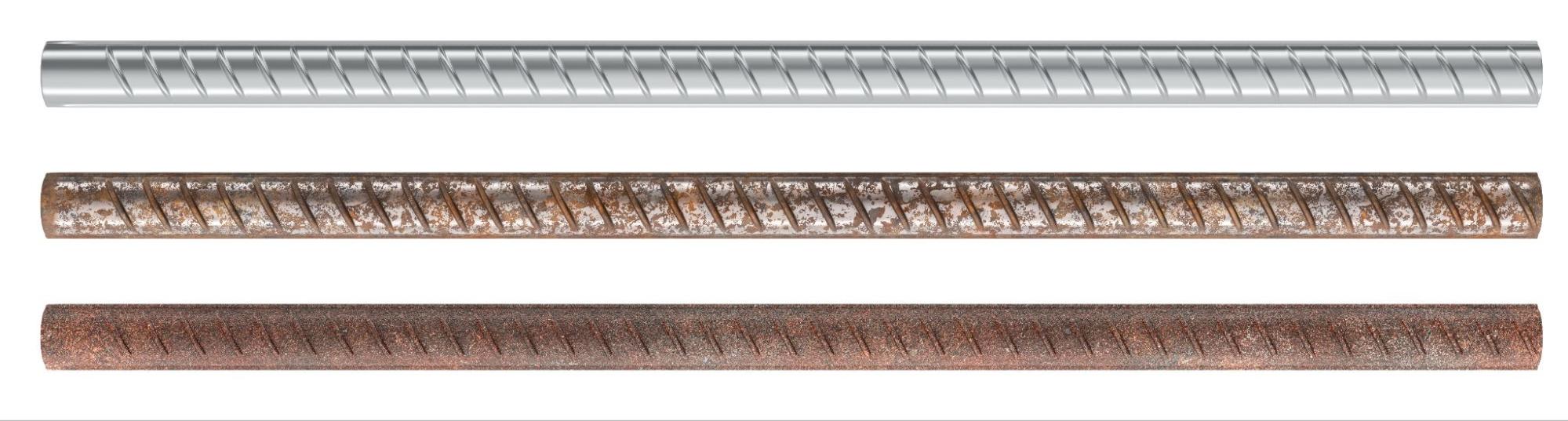

Corrosion Resistance of Common Metals
These rankings prioritize corrosion resistance, performance in acids/bases, saltwater durability, and humidity resistance. This table assumes no coatings unless noted.
Some materials resist rust and corrosion better than others.
RankMaterialOverall ResistanceRelative CostCost–Performance Insight
1Titanium (Ti-6Al-4V)Excellent$$$$Ultimate corrosion resistance at a premium cost
2Stainless Steel 316Excellent$$$Best value for harsh or marine environments
3Stainless Steel 304Very Good$$Great general-purpose corrosion resistance
4BrassGood$$Corrosion-resistant, easy to machine
5CopperModerate–Good$$Conductive but oxidizes
6Aluminum 6061 (anodized)Moderate–Good$$Anodizing greatly improves durability
7Aluminum 6061 (raw)Moderate$Lightweight, limited chemical resistance
8Aluminum 7075Fair–Moderate$$Strength-focused, corrosion-prone
9Tool SteelPoor–Fair$$High strength, requires coating
10Carbon SteelPoor$Lowest cost, worst corrosion resistance
Design Tip: When using dissimilar metals in assembly, consider galvanic compatibility to prevent accelerated corrosion.

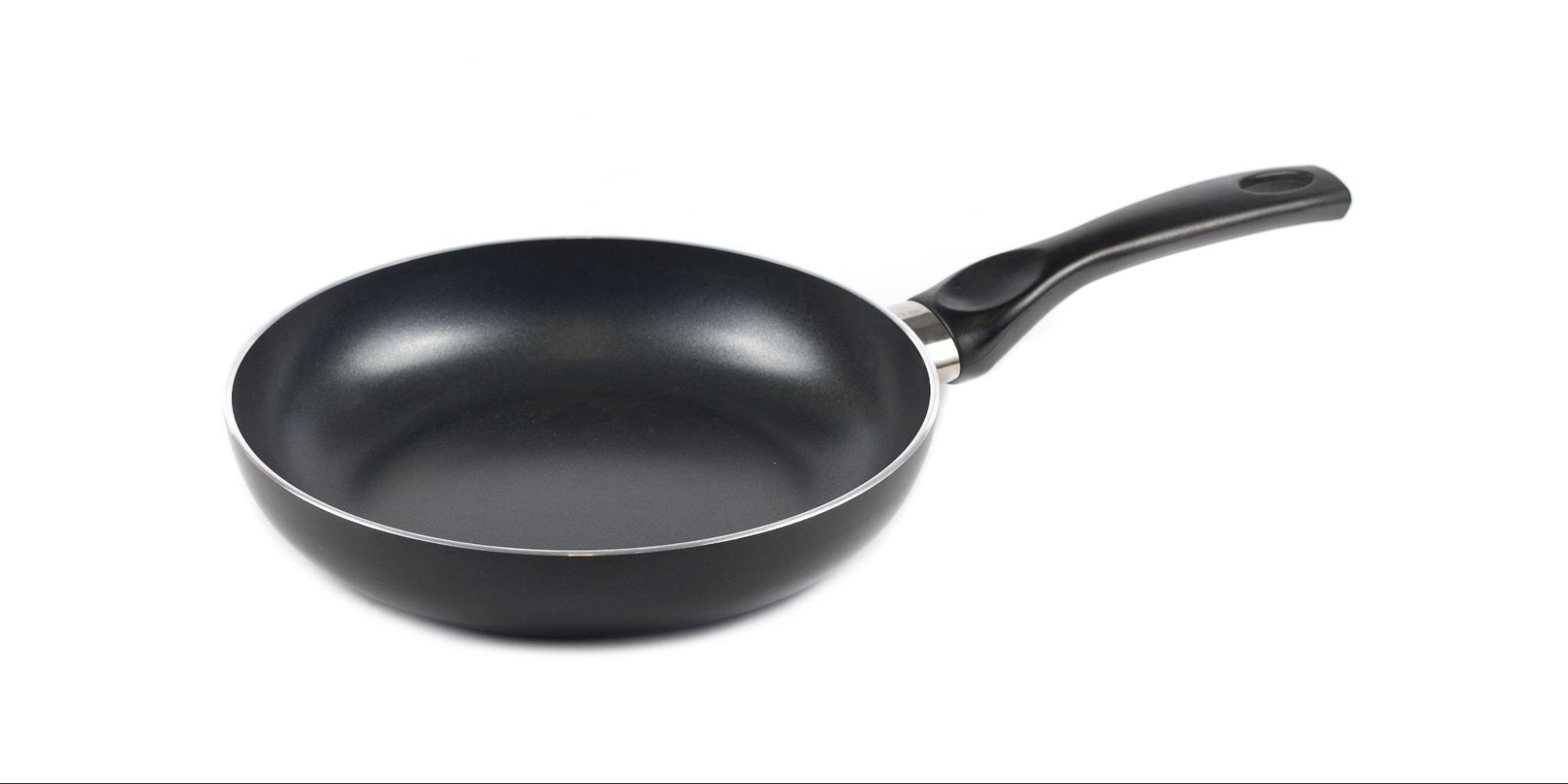

Frying pans are often coated with PTFE Teflon to create a non stick surface with resistance to high heat
