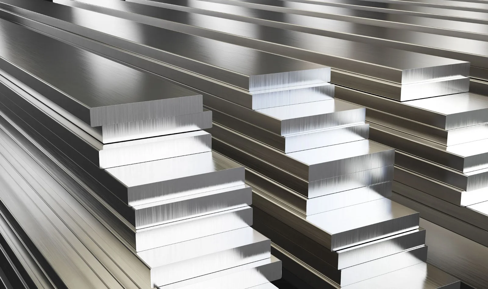

Aluminum, or aluminium if you’re from the UK, is my favorite metal because of its high strength to weight ratio and suitability for a wide range of manufacturing applications. Aluminum is a commonly utilized material in many industries, and there are many aluminum alloys for CNC machining, CNC milling, CNC turning, welding, brazing, casting, stamping, forging, and laser cutting. Because aluminum is so versatile, it’s utilized in many industries including automotive, aerospace, and medical.
Aluminum stock shows good aesthetics and luster
Read on to learn about some of the most popular aluminum-alloys and their common use cases, so you can choose the best material for your next project.
Pro-tip: all of the aluminum alloys discussed in this article are excellent choices for CNC machining, and there are many use cases beyond those listed for each alloy.

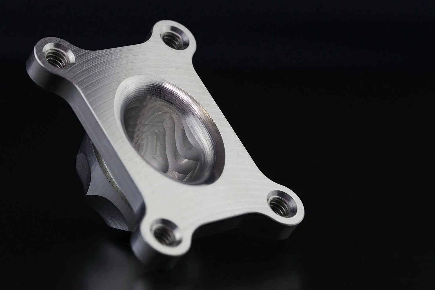

7075-T6 Aluminum
A Fictiv part CNC machined out of 7075 aluminum
7075-T6 aluminum is precipitation-hardened 7075 aluminum. Like 6061-T6 aluminum, it has been tempered to the T6 condition. The primary alloying element for 7075 aluminum is zinc, which makes the strength of the aluminum alloy comparable to steel alloys — it’s one of the strongest aluminum alloys commercially available.
7075-T6 is not only the strongest aluminum alloy, it also has the greatest shear strength of all the alloys listed here. For this reason, 7075 aluminum is often referred to as aircraft grade or aerospace aluminum. But, this super high strength comes at a cost — 7075 aluminum has reduced corrosion resistance compared to weaker aluminum alloys.
Advantages of 7075-T6 aluminum:
  • Ultra-high strength (tensile and shear strength)
  • Is paintable and accepts finishes easily
  • Formable
  • Good fatigue strength
Disadvantages of 7075-T6 aluminum:
  • High cost
  • Lower corrosion resistance
  • Fair machinability (requires more precision and experience)
Common uses for 7075-T6 aluminum:
  • Aerospace frames and other structural parts
  • Bicycle frames
  • Tooling
  • Gears
  • Structural marine and automotive parts
  • Plastic injection molds

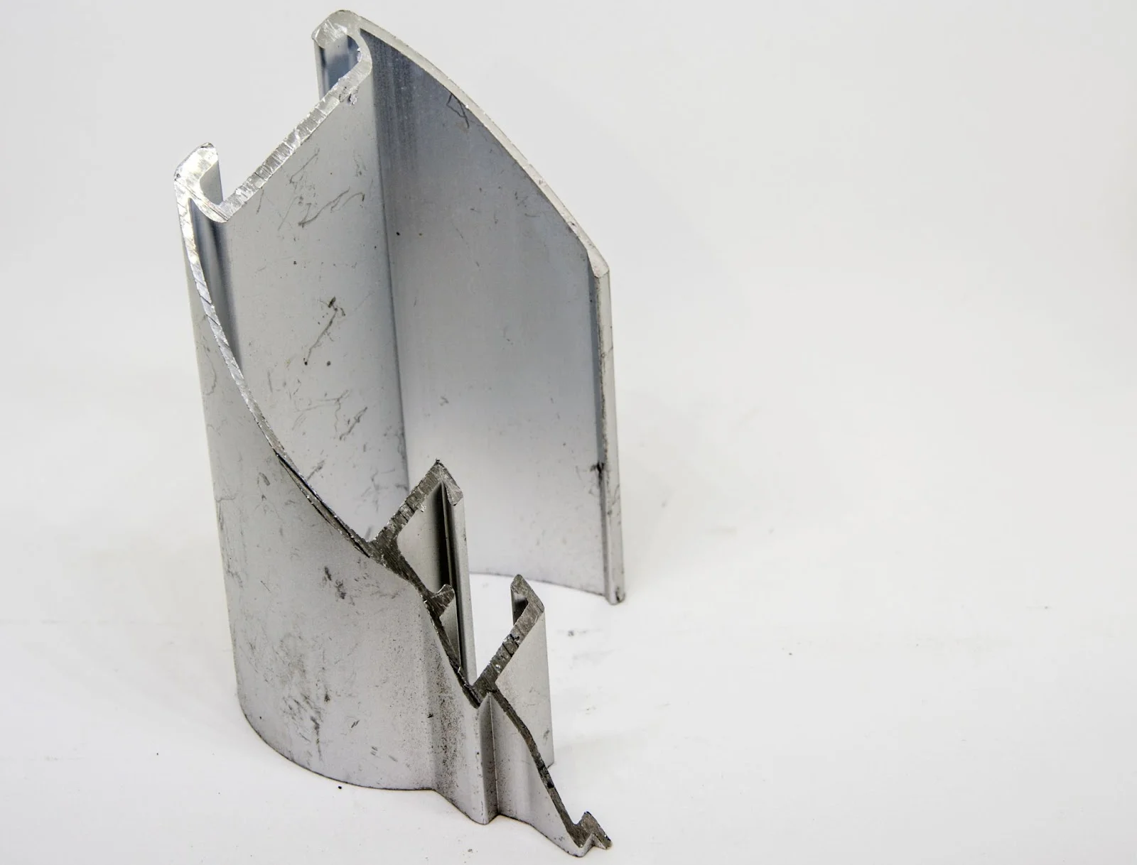

6063 Aluminum
A piece of scrap 6063 aluminum extruded metal; shows formability
6063 aluminum is an alloy composed mainly of aluminum, silicon and magnesium. Due to 6063 aluminum’s silicon content, it’s well suited for extrusions and vacuum brazing — it has a lower melting temperature, and allows for grain boundary penetration of the braze alloy at the correct temperature.
Although 6063 has added magnesium, it’s good for applications where moderate strength is required and when high temperatures are not anticipated. It can also be easily formed into complex shapes and boasts a high corrosion resistance, so it maintains a nice luster throughout its operating life.
Advantages of 6063 aluminum:
  • Smooth, lustrous appearance
  • Good metal joining properties (welding and brazing)
  • Heat treatable
  • Good for complex geometries
  • High corrosion resistance
Disadvantages of 6063 aluminum:
  • Lower strength
  • Is not easily machined
Common uses for 6063 aluminum:
  • Piping
  • Railing
  • Heat Exchangers
  • Decorative products like furniture
  • Electrical conduit
  • Commercial and residential architectural components like window frames
