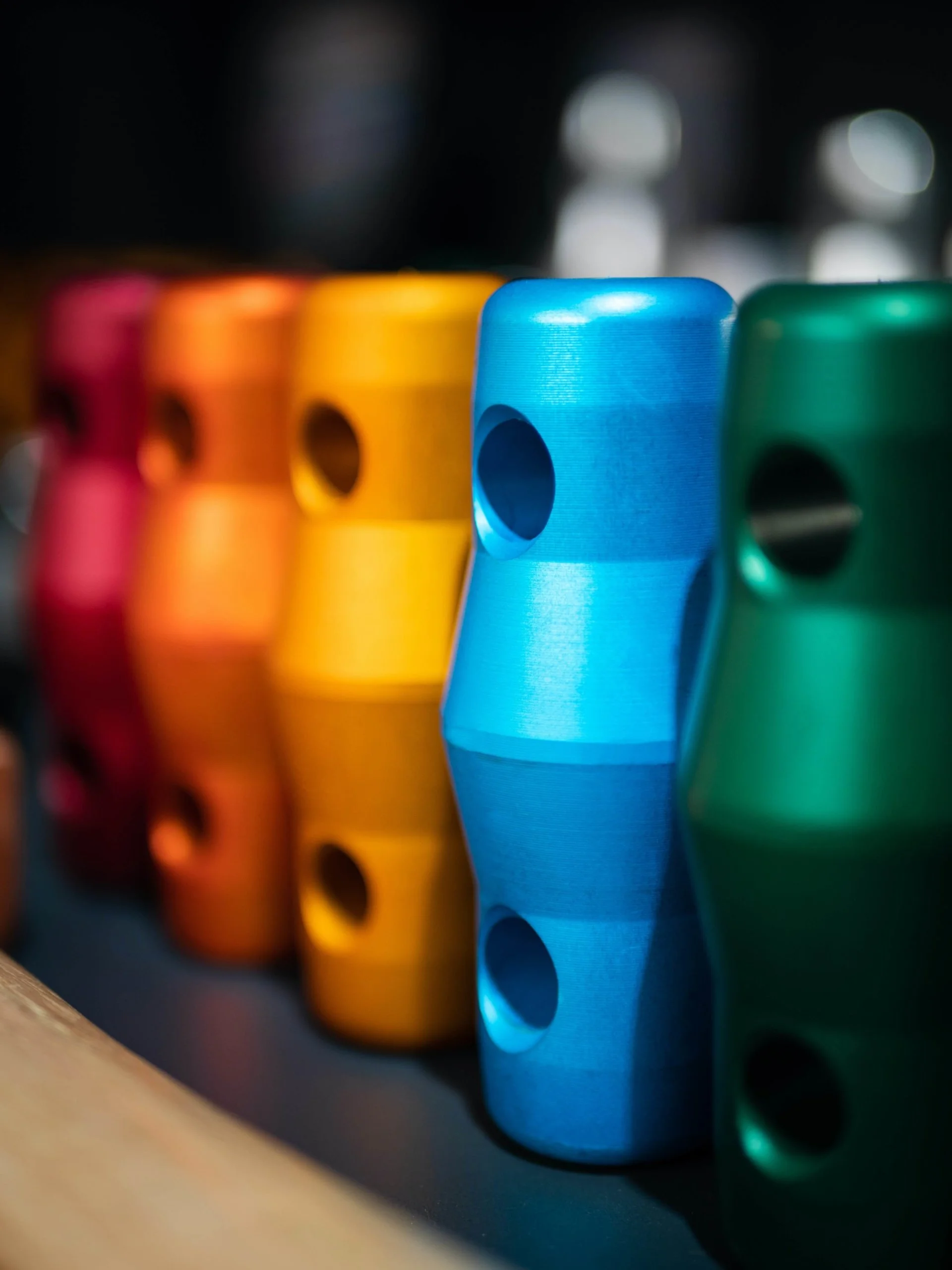

Anodizing is a common finish that’s a protective oxide layer that naturally forms on the surface of aluminum when exposed to air. During the artificial process, the aluminum part is hung on a conductive rack and submerged in an electrolytic solution, where a direct current of electricity is introduced. While the acidity of the solution dissolves the naturally-occuring oxide layer, the electric current releases oxygen at its surface, which builds up a new protective layer of aluminum oxide.
macbook pro dark lighting
<em>The well known laptop is machined from aluminum and then anodized<em>
By balancing dissolve rate with build-up rate, the oxide layer forms with nanopores, allowing continued growth of the coating beyond what is naturally possible. Afterward, the nanopores are sometimes filled with other corrosion inhibitors or colored dyes for cosmetic purposes, then sealed to complete the protective coating.
anodized aluminum parts of various colors
<em>Another example of aluminum parts that are CNC machined and then anodized in various colors<em>
