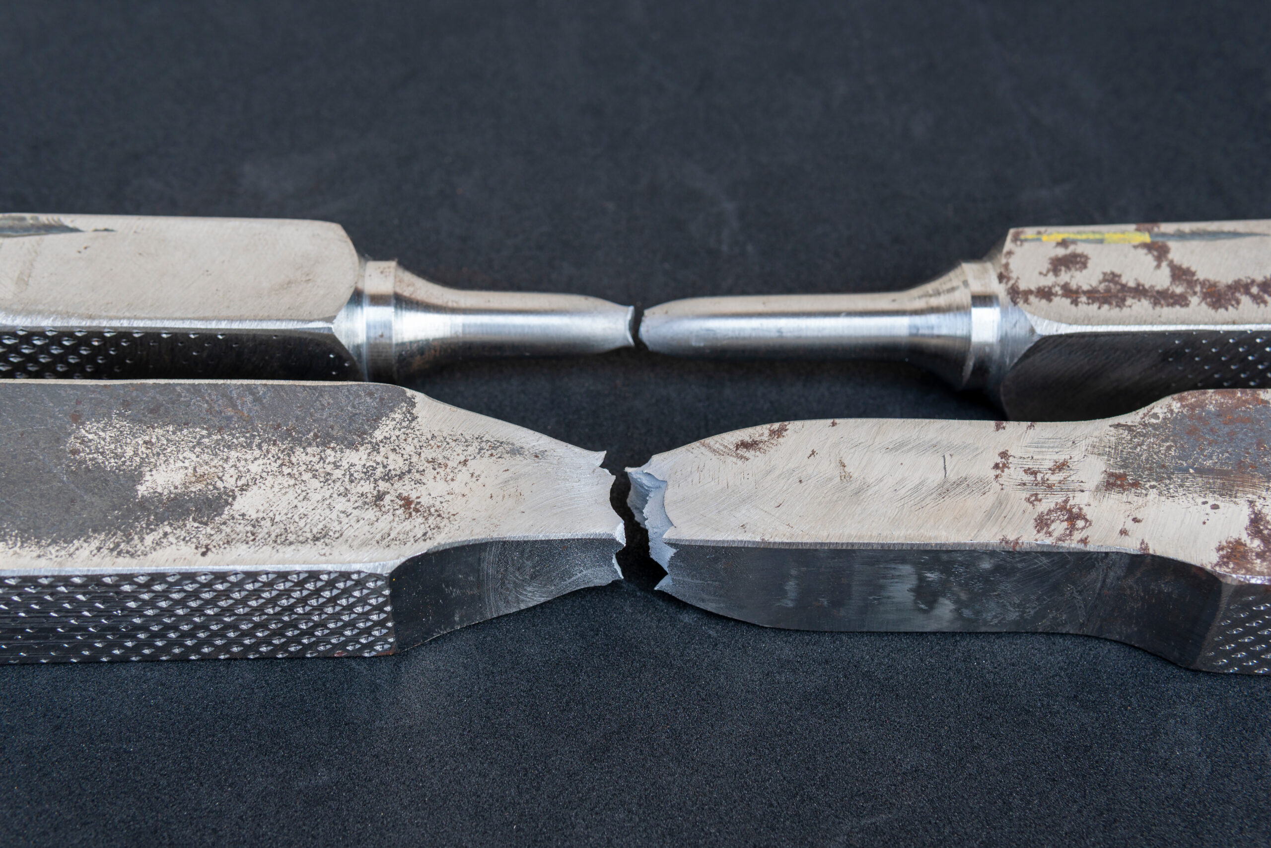

Mechanical properties—primarily from tensile testing—record yield strength (where permanent deformation begins), ultimate tensile strength (the maximum before fracture), and elongation (a measure of ductility and how the material fails). Low elongation means brittle fracture with little warning. Depending on the standard, you may also see hardness (Brinell or Rockwell) and Charpy impact values, the latter being critical for low-temperature or dynamic load applications where a material can pass tensile requirements at room temperature and still fail in the field.

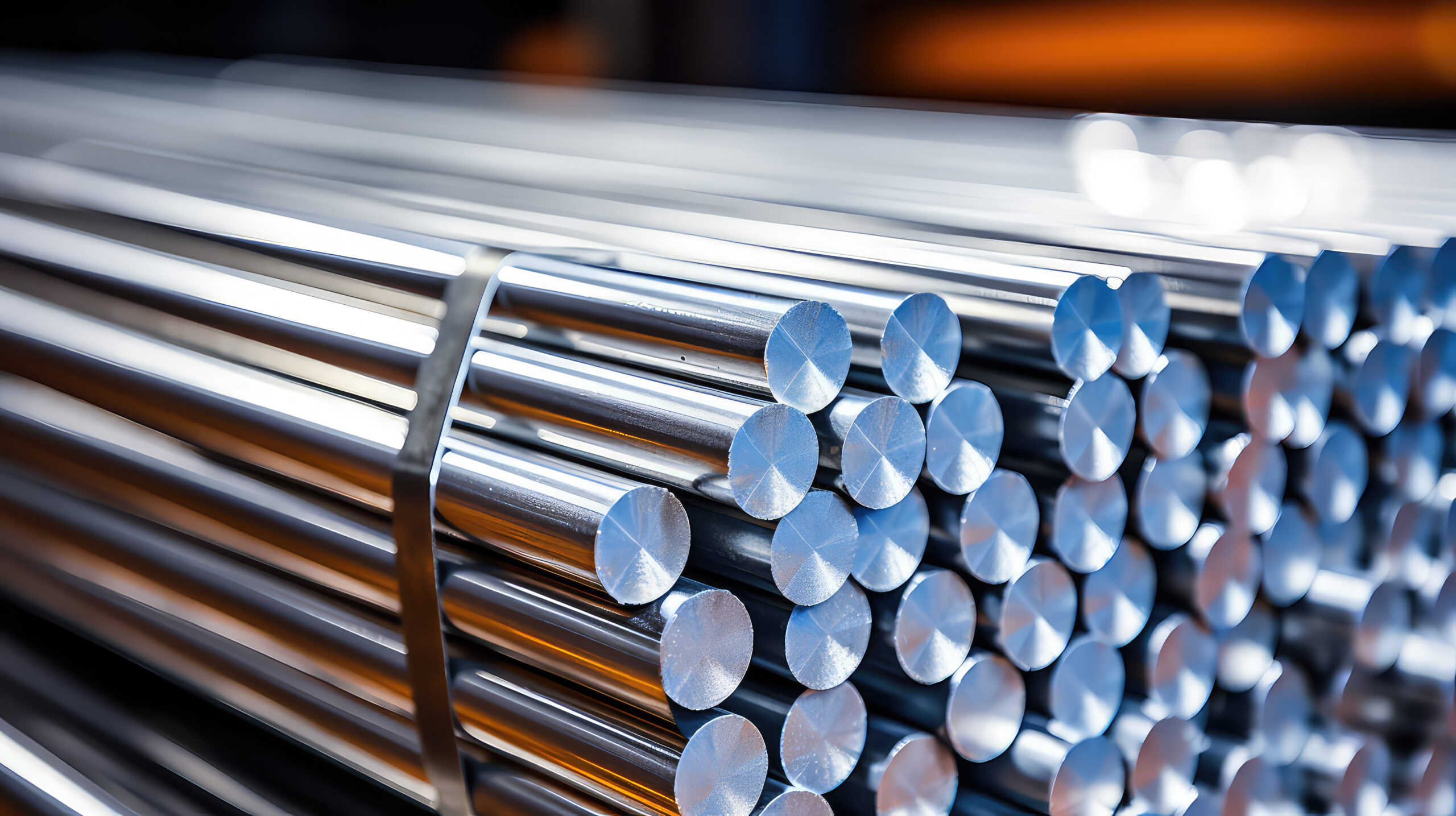

Raw stock moves through several hands between the mill and the machine: distributors, stockists, sometimes multiple intermediaries, before it reaches a manufacturing partner. At each step, the original material identification needs to be maintained. The unique identifier on the certificate—that heat number or lot number—must appear on all accompanying documentation at every link in that chain.
This sounds straightforward, but in practice, it’s one of the most common failure modes in material certification programs. Stock gets co-mingled in a warehouse. Labels fall off. A bar gets cut and the offcut piece gets set aside without any marking. A distributor issues their own documentation without clearly referencing the original mill certificate.
