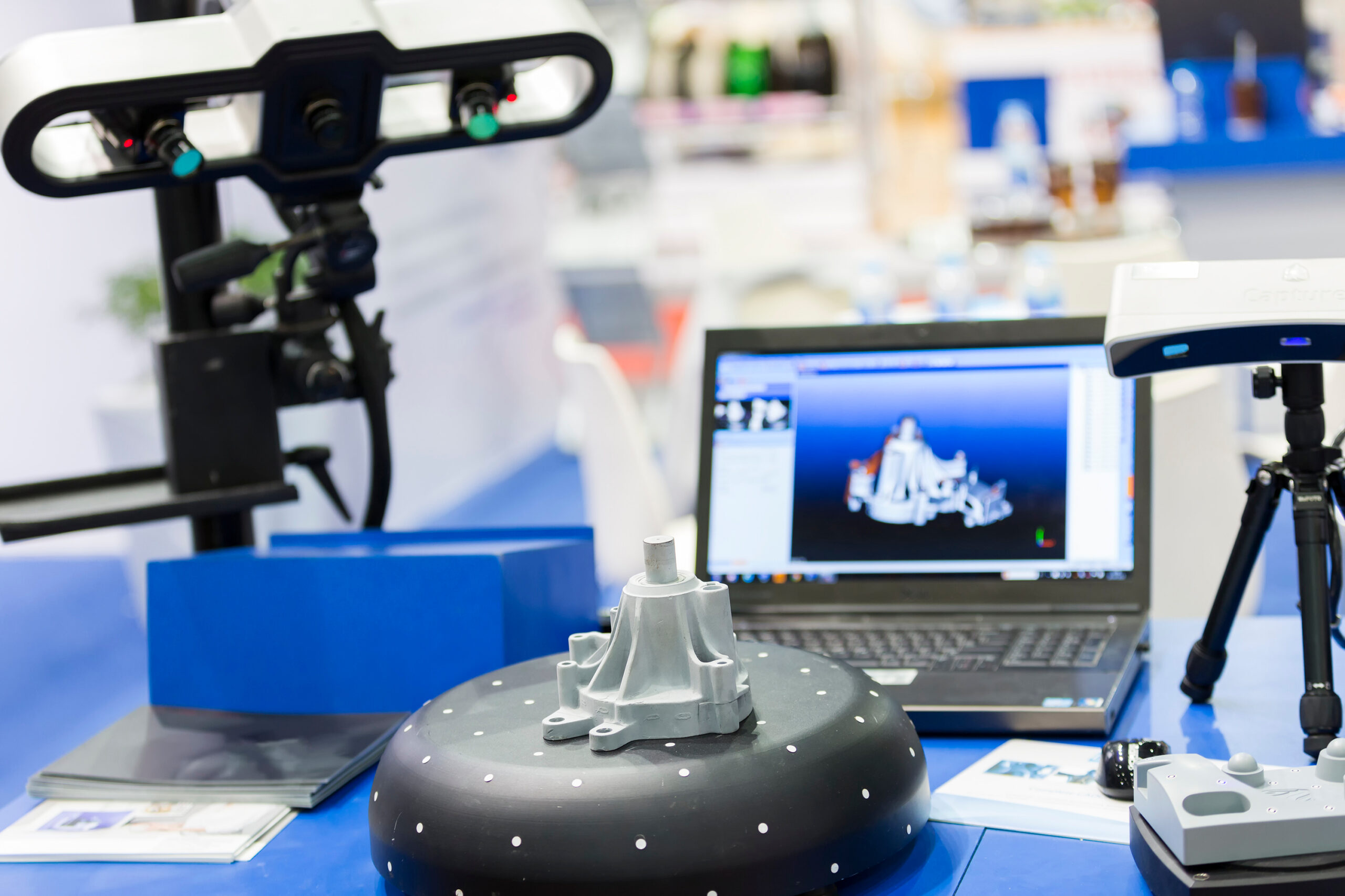

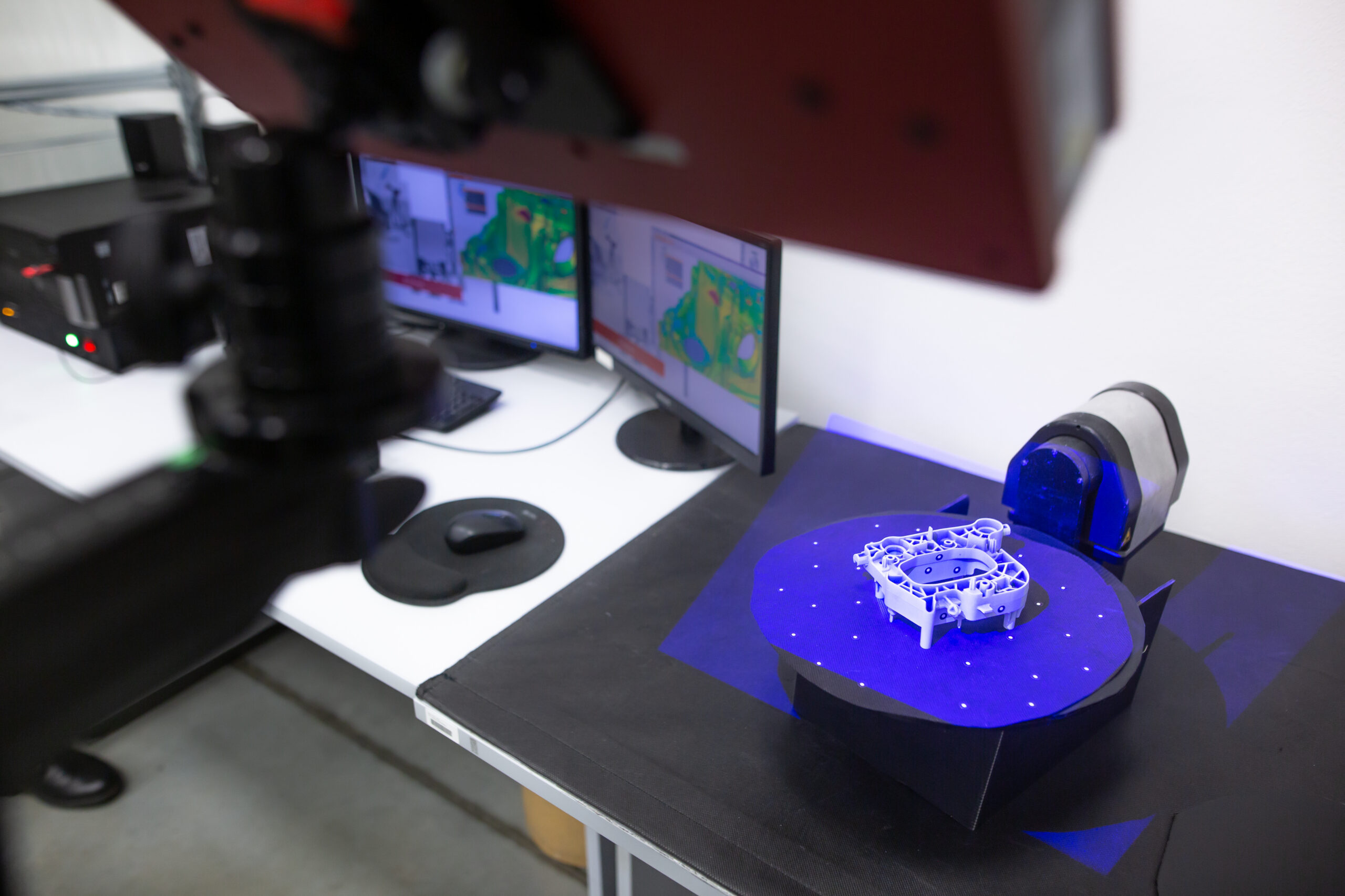

Capturing Geometry Through Scanning and Metrology
The first stage of reverse engineering typically involves capturing dimensional data.
Depending on the component’s size, complexity, and accuracy requirements, engineers may use laser scanning, structured light scanning, coordinate measuring machines (CMMs), or traditional metrology tools to capture its physical geometry. More complex assemblies or internal features may require CT scanning or advanced inspection methods.
3D scanning is especially valuable for components with organic surfaces, cast geometries, undocumented contours, or worn and damaged features. However, raw scan data alone is rarely sufficient for manufacturing.
Engineering teams must still determine which dimensions are functionally critical, which surfaces define assembly interfaces, and which geometric features can be optimized for production. Scan data often contains wear artifacts, manufacturing inconsistencies, or undocumented modifications that must be interpreted before a reliable CAD model can be created.
This is where manufacturing engineering expertise becomes essential. A raw point cloud scan only captures the component in its as-built state—complete with years of operational wear, gouges, or warping. Reverse engineering is a functional engineering process that requires understanding how the part operates within the larger mechanical system.
A true industrial reverse-engineering workflow uses the scan data merely as a baseline. The design engineer must calculate the part’s original as-designed nominal intent. This requires isolating critical mating faces, defining functional datum planes, and reverse-calculating the original tolerances to ensure the new part interfaces perfectly within the existing legacy assembly.
