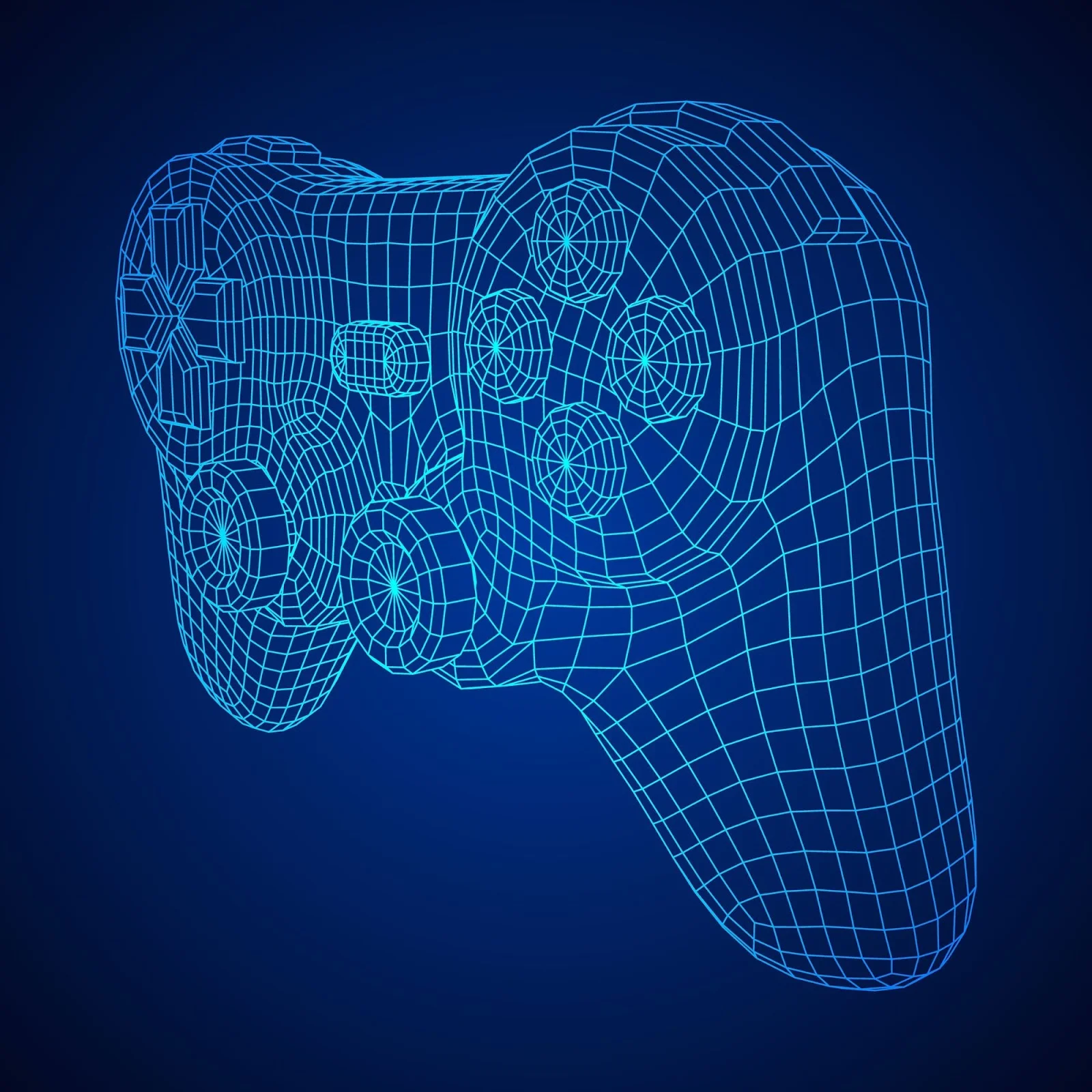

Typically, point cloud data should be filtered down to only the necessary points prior to exporting. The rule of thumb is to filter down to less than a million points to reduce the amount of time it takes to perform the file conversion. From there, you utilize software to convert the point cloud data to a usable file.
Different software uses different techniques to treat the triangulation for a mesh output. The mesh output provides computed triangulations of the surfaces, allows for some of the rigidity of features to remain intact, and provides close approximation for surface contour. When building meshes, you can play around with the polygon count and density, which have an impact on surface resolution and accuracy. Common (CAD) export file types include: DXF, E57 (per ASTM E 2807-11), IGES, DAE, 3MF, and PLY.

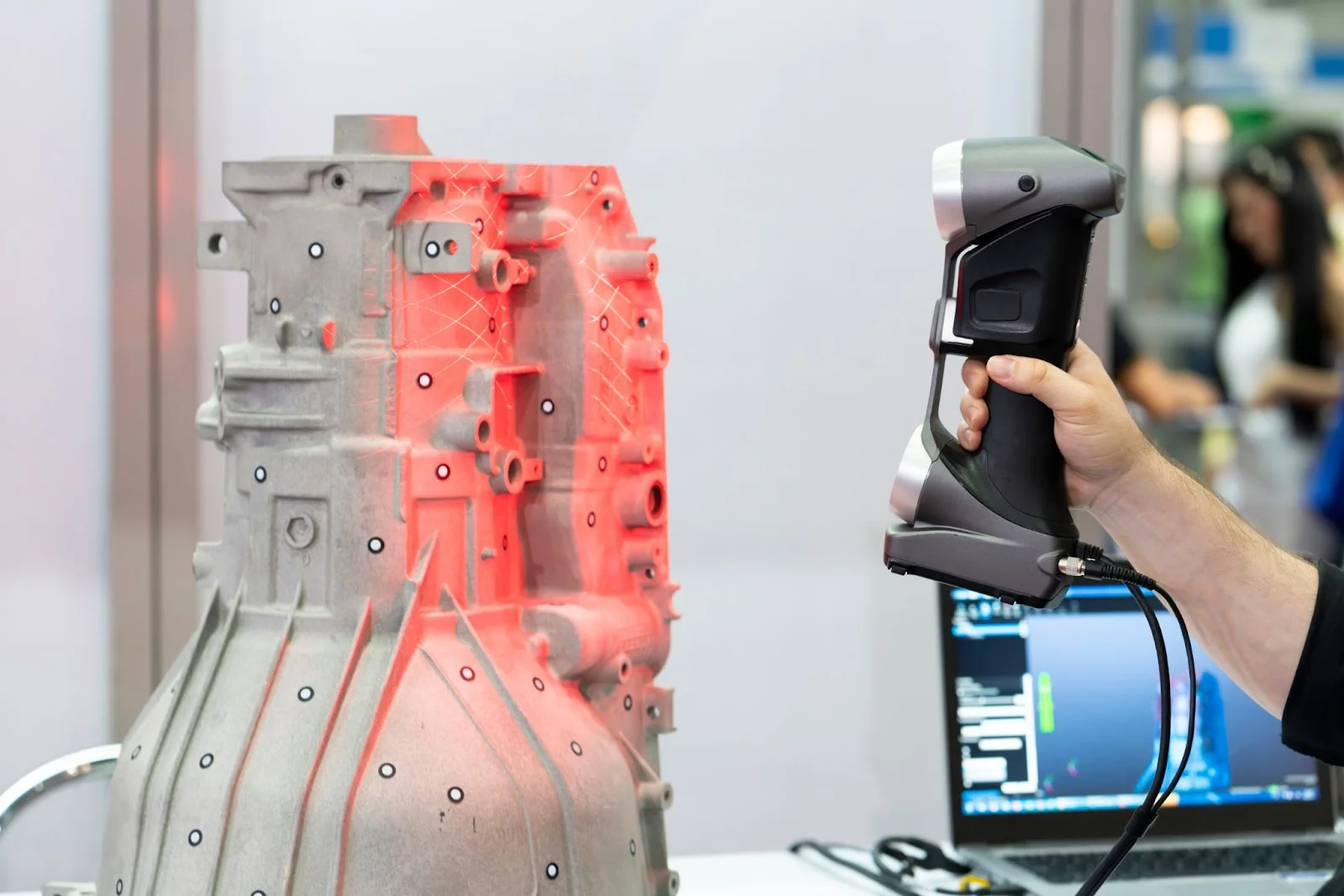

How to Prepare a Part for 3D Scanning
Now that you have a good grasp of how 3D scanning works, it is time to talk about optimizing your 3D scanning process from setup to finish. Optimizing the environment and scan settings is critical to ensure you obtain the most accurate geometry of the surface of the MRO part you’re scanning.
And getting the highest quality raw scan possible is critical because the quality of the resulting solid model — and therefore the quality of the final part — is greatly dependent on the raw scan. There isn’t much you can do to fix a scan quality issue after the fact.
So, let’s discuss how to get a great scan with the proper setup:
  1. Ensure the part you are scanning is rigidly controlled during scanning. For example, if you’re scanning a light part, secure it tightly to a surface or place it in a room with decreased airflow.
  2. Ensure there aren’t stray vibrations from sound or other sources that can move the part while the scanner is collecting point cloud data.
  3. Control your part’s shine. Scanning an object that projects light is going to result in refracted or reflected laser and light beams. This disrupts your measurements because the scanner won’t correctly collect measurements in these areas. (Pro-tip: Apply a developer aerosol spray coating to shiny surfaces prior to scanning, and make sure it is completely dry as well.)
  4. Set up your scanning environment with a dark background and limit (if any) light entering the area. You can even use black paper or black fabric for a backdrop. Use as dim lighting as possible to limit interference.
  5. Ensure your equipment is in good working order and properly calibrated. Scanning equipment has a tolerance associated with it; without proper calibration, you can’t get accurate scans. Check your equipment’s manual or technical data sheet to determine if the manufacture must perform the calibration.
mesh of a 3d scan of a video game controller
