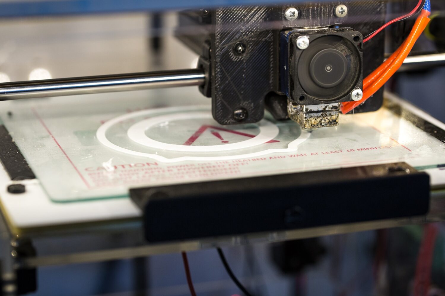

Getting Ready to Print
Once you have closed the mesh on your part or tool and it is water-tight, it’s time to jump into 3D printing. It’s important to think about the scale of your object and the material you’d like to use when uploading it for printing. Depending on its size, you may be required to scale it up or down.
