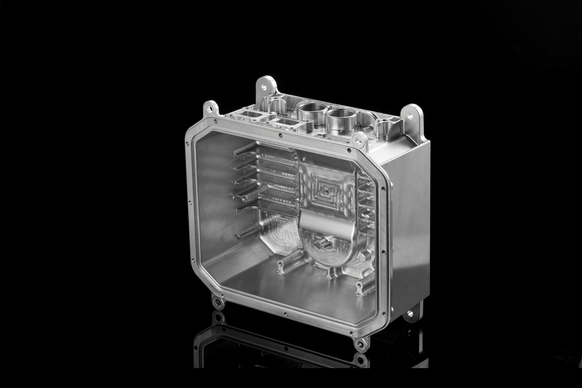

CNC Machining
CNC machining is typically the fastest bridge production solution available. Because no tooling is required, production can begin immediately after design approval. CNC machining also provides access to the broadest range of close-to-production spec materials.
CNC machining works particularly well for metal components, low-volume rigid-plastic parts, tight-tolerance applications, functional testing hardware, and regulatory builds requiring certified materials. Common materials include 6061-T6 aluminum, 7075 aluminum, stainless steel, and titanium.
Advantages include:
  • No tooling investment
  • Fast delivery schedules
  • Best fit for parts requiring very tight tolerances
  • Design flexibility
However, per-unit cost remains high and relatively constant as volume increases. Some complex geometries intended for injection molding can be difficult to machine economically.
CNC bridge production

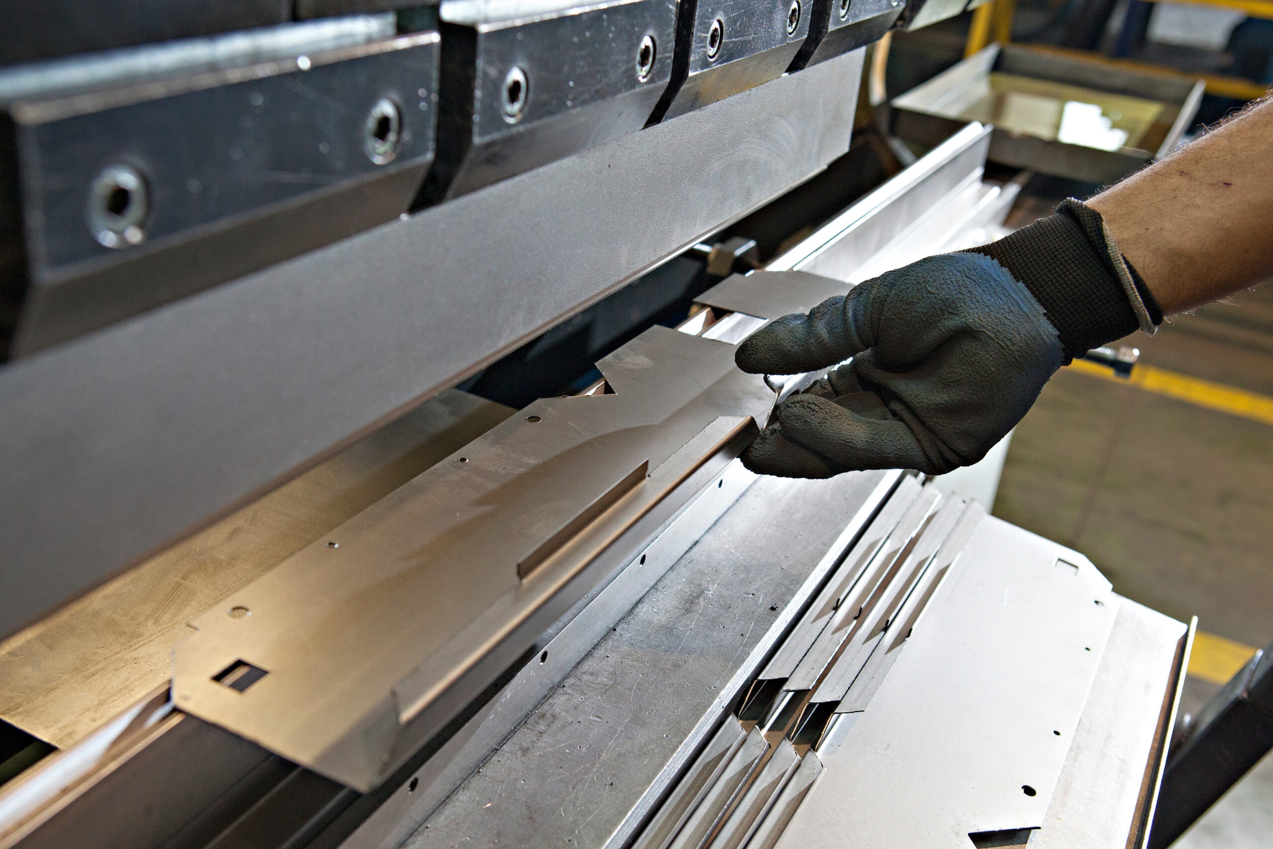

Sheet Metal Fabrication
Sheet metal fabrication is a strong bridge production option for enclosures, brackets, chassis, panels, and structural components—parts that injection molding doesn’t address and CNC machining handles expensively at volume. Because tooling requirements are minimal (laser cutting and press brake forming require none), production can begin quickly after design approval. Where custom punching dies are needed, they are inexpensive and fast to produce compared to injection mold tooling.
Sheet metal is particularly effective for enclosures and housings, mounting hardware, structural frames, and EMI shielding components. Common materials include 5052 and 6061 aluminum, cold-rolled steel, stainless steel, and galvanized steel.
Advantages include:
  • Minimal tooling investment
  • Wide range of production-representative finishes (anodize, powder coat, plating)
  • Direct scalability—the same process runs from bridge quantities into production volumes
  • Well-suited to parts with hardware insertion requirements (PEM nuts, standoffs, hinges)
Key DFM considerations include consistent bend radius, appropriate k-factor allowances, and minimum flange lengths. Parts designed for CNC machining may require geometric modifications before sheet metal is viable.
Sheet metal bridge production

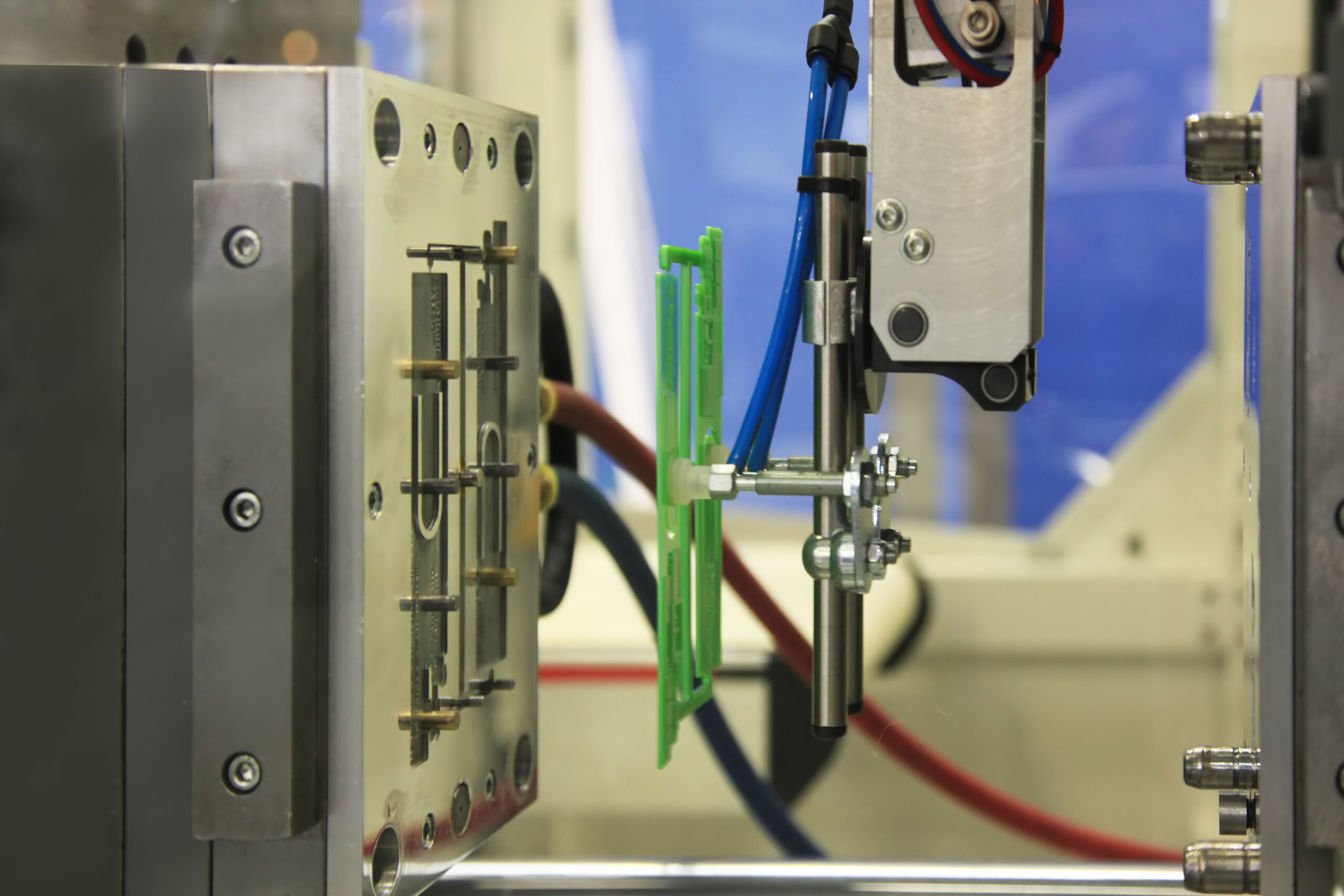

Soft Tooling Injection Molding
Soft tooling (also known as prototype, quick, or bridge tooling) uses aluminum or unhardened steel and produces parts using production-grade thermoplastics on conventional injection molding equipment, providing a close representation of the final product.
Soft tooling is particularly effective for plastic parts between 100 and 1000 units, regulatory submissions, customer pilot programs, production-intent launch inventory, and complex molded geometries. Features such as living hinges, snap fits, thin walls, and cosmetic textures are more feasible to replicate through this molding approach than machining.
Advantages include:
  • Production-grade materials
  • Production-representative process
  • Lower per-unit costs at higher volumes
  • Excellent cosmetic quality
Soft tooling requires investment and lead time, and its finite tool life makes it unsuitable for long-term production.
Injection molding bridge production

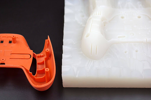

Urethane Casting
Urethane casting occupies a unique position between prototyping and injection molding. The process uses silicone molds produced from a master pattern, generated through CNC machining or 3D printing. Polyurethane materials can closely mimic many production plastics while delivering excellent cosmetic quality.
Urethane casting is often selected for sales samples, trade show products, investor demonstrations, consumer electronics, and low-volume cosmetic parts.
Material properties, however, are approximations, not exact matches. The process is unsuitable for highly loaded structural components or regulatory submissions needing real-production equivalence.
Urethane vacuum casting for bridge production

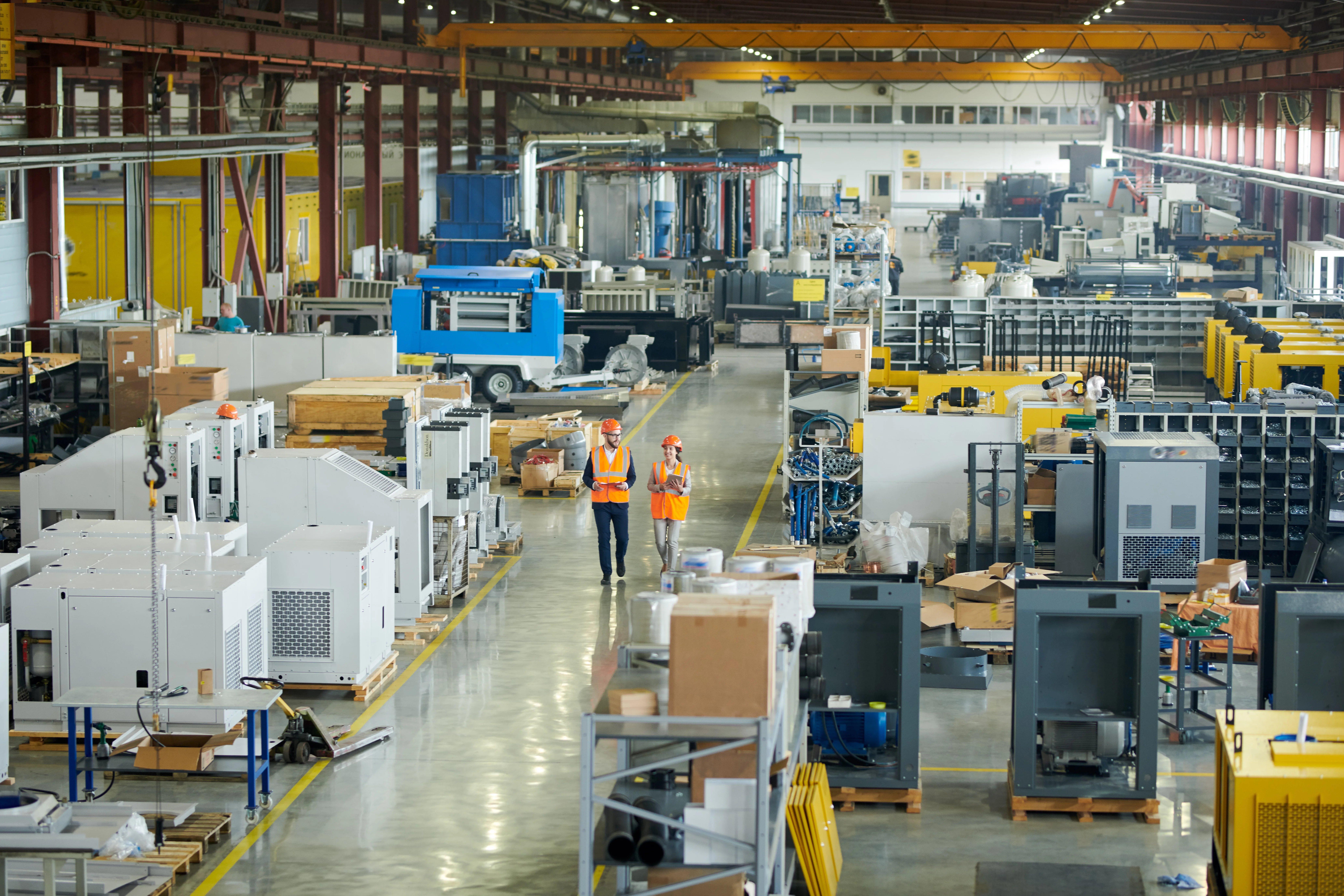

Fictiv for bridge production manufacturing
How Fictiv Supports Bridge Production
Bridge production succeeds when teams move quickly between manufacturing methods without disrupting schedules, supplier relationships, or quality requirements. Fictiv supports multiple bridge production approaches through a unified sourcing platform, allowing engineering and procurement teams to evaluate multiple manufacturing processes within the same workflow.
Automated DFM feedback further supports successful bridge production by evaluating both the selected bridge manufacturing process and the intended production process, helping teams identify manufacturability issues early. Quality documentation is available, including First Article Inspection (FAI) reports, material certifications, and dimensional inspection reports.
Fictiv also provides engineering support for teams navigating the transition from bridge production to full-scale manufacturing. This includes DFM review, tooling strategy guidance, process selection assistance, and supplier coordination to help ensure a smoother path toward production launch.
