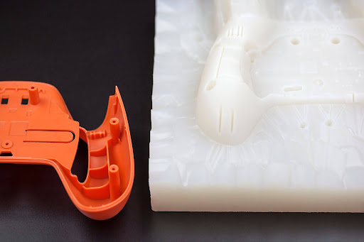

Urethane Casting
Urethane casting produces parts with production-quality appearance at a fraction of injection molding’s tooling cost. Using silicone molds derived from a master pattern, urethane casting is ideal for sales samples, early market testing, and form-and-fit validation where surface finish and detailed features matter. Lead times are fast, color matching is achievable, and no hard tooling investment is required. However, materials may not be a good fit for thermal or high-load applications, as urethane resins typically have lower heat deflection temperatures and less mechanical strength than production thermoplastics.
Tooling cost*: Low. Silicone molds typically run ~$500–$1,500 per mold, with no hard tooling investment required.
Urethane cast controller part for low volumes
