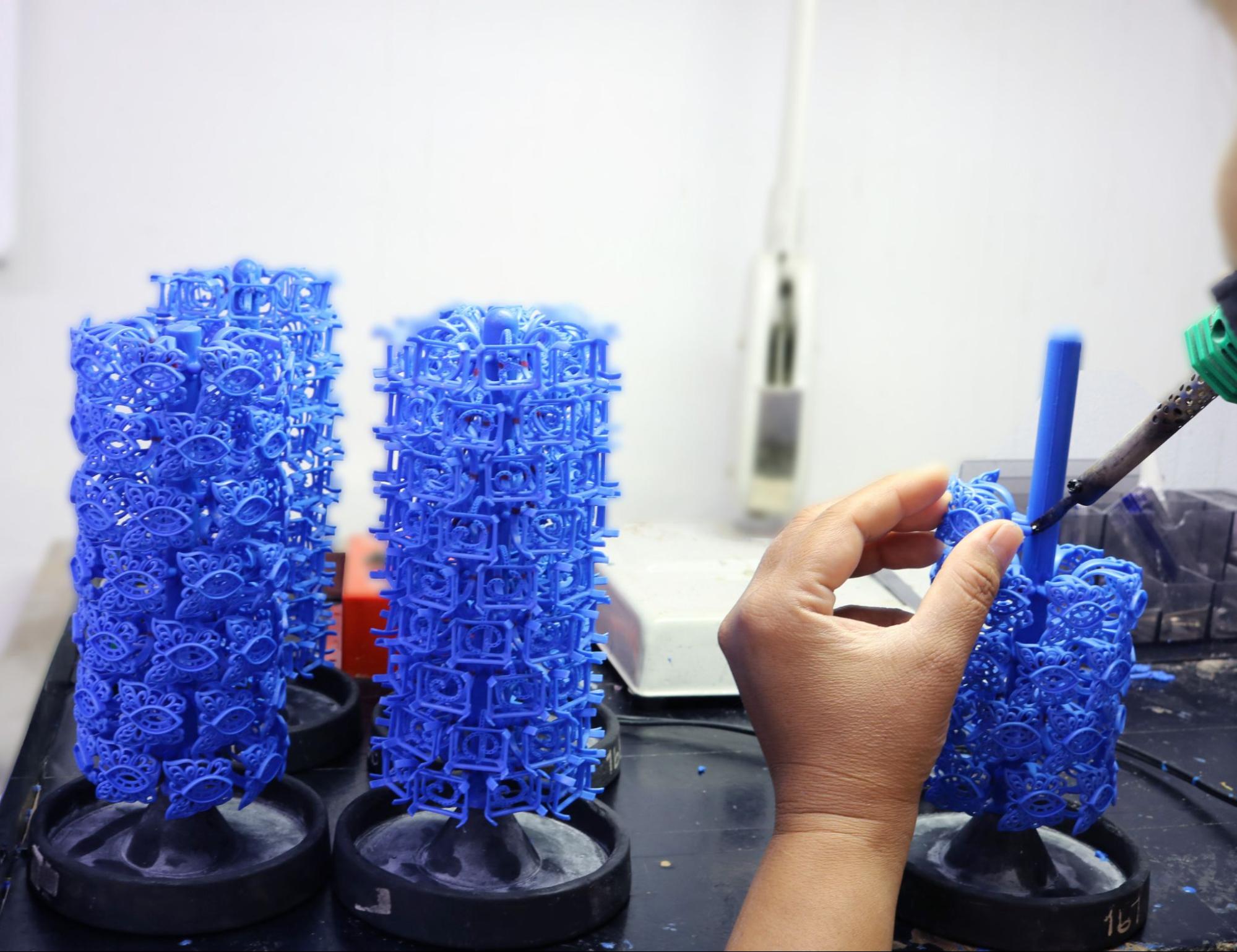

  1. Assembling Wax Patterns Into a Tree
Multiple wax patterns are manually or robotically bonded to a central wax sprue using heated tools or adhesive wax, forming a tree structure that allows for the simultaneous casting of 10–50 parts. While patterns are typically molded individually, complex designs may incorporate tree elements during injection molding to reduce the number of assembly steps. Proper alignment, verified by vision systems, prevents casting defects like incomplete fills.
The sprue and runner system, optimized using CAM software for manufacturing precision, ensures uniform metal flow and minimizes turbulence. This design reduces per-part costs by 20–30% for medium volumes (100–5,000 parts) by enabling batch casting and minimizing material waste. Automated robotic assembly enhances consistency, reducing misalignment risks by 15–20%.
Wax tree preparation for an investment-cast jewelry mold.

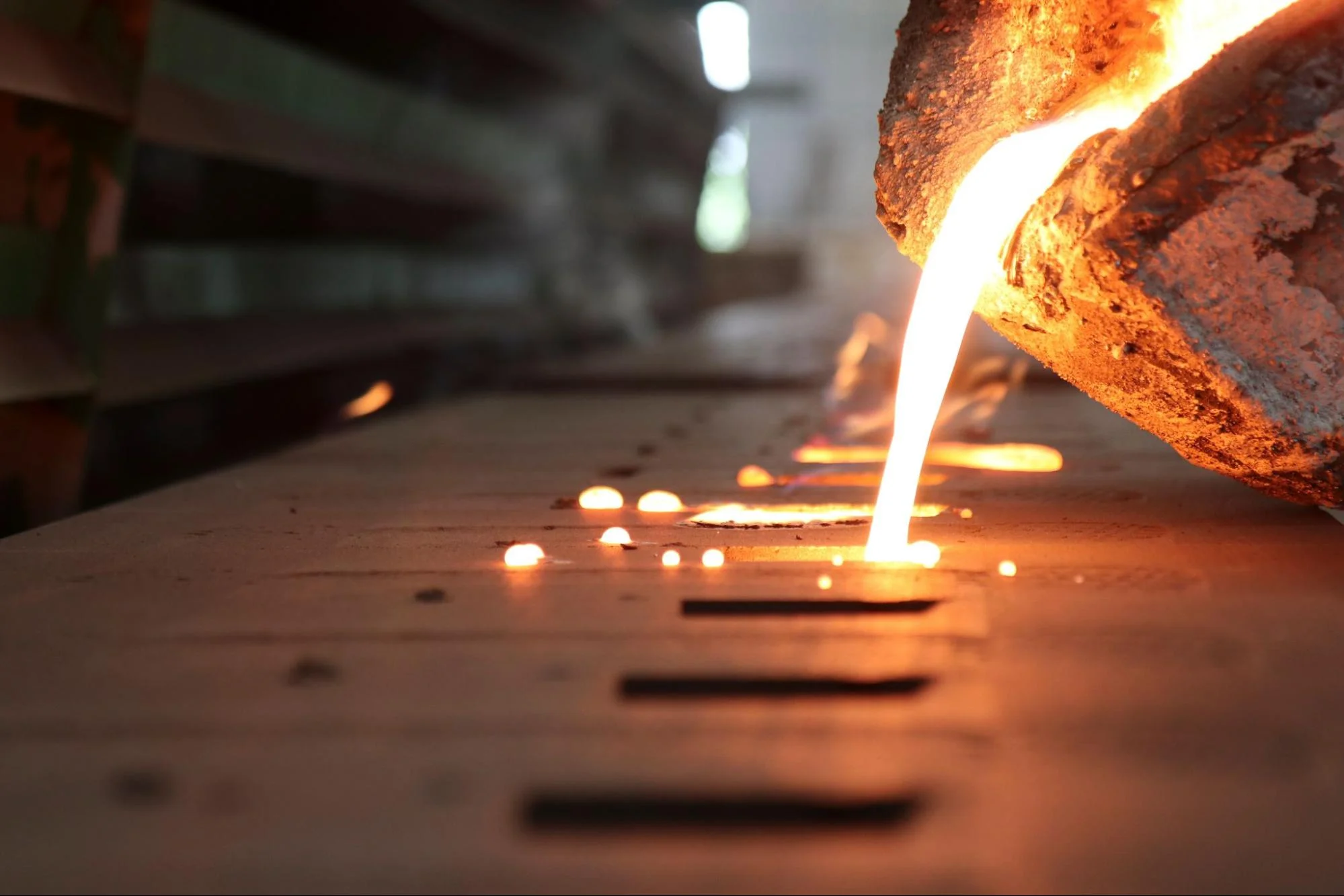

  1. Pouring the Molten Metal
Molten metal (e.g., 17-4 PH stainless steel, Ti-6Al-4V) at 1,400–1,600 °C is poured into the mold using gravity, vacuum assist, or centrifugal methods. Vacuum casting, common for titanium, minimizes oxidation, ensuring defect-free surfaces. Pouring speed (0.5–2 kg/s) is crucial to prevent cold shuts, requiring precise control through automated systems.

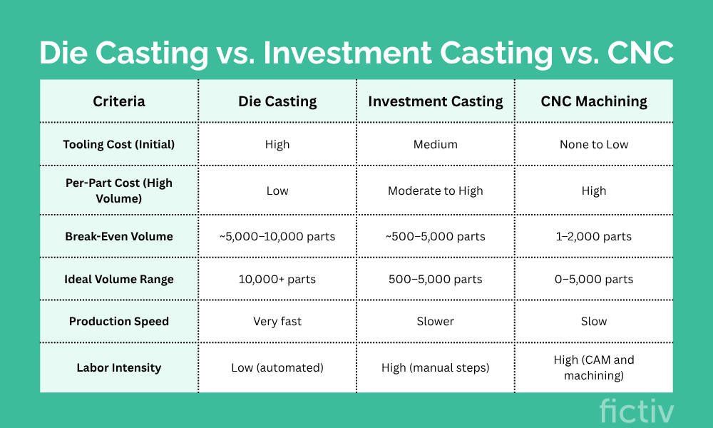

Die Casting vs. Investment Casting vs. CNC
If your design calls for precision metal components with complex features, choosing the right manufacturing process is key. Fictiv’s network of manufacturing partners and technical experts in manufacturing and supply chain can help guide you to the best solution for your project. Looking into investment casting? Just ask—we can provide it on request for specific applications.
