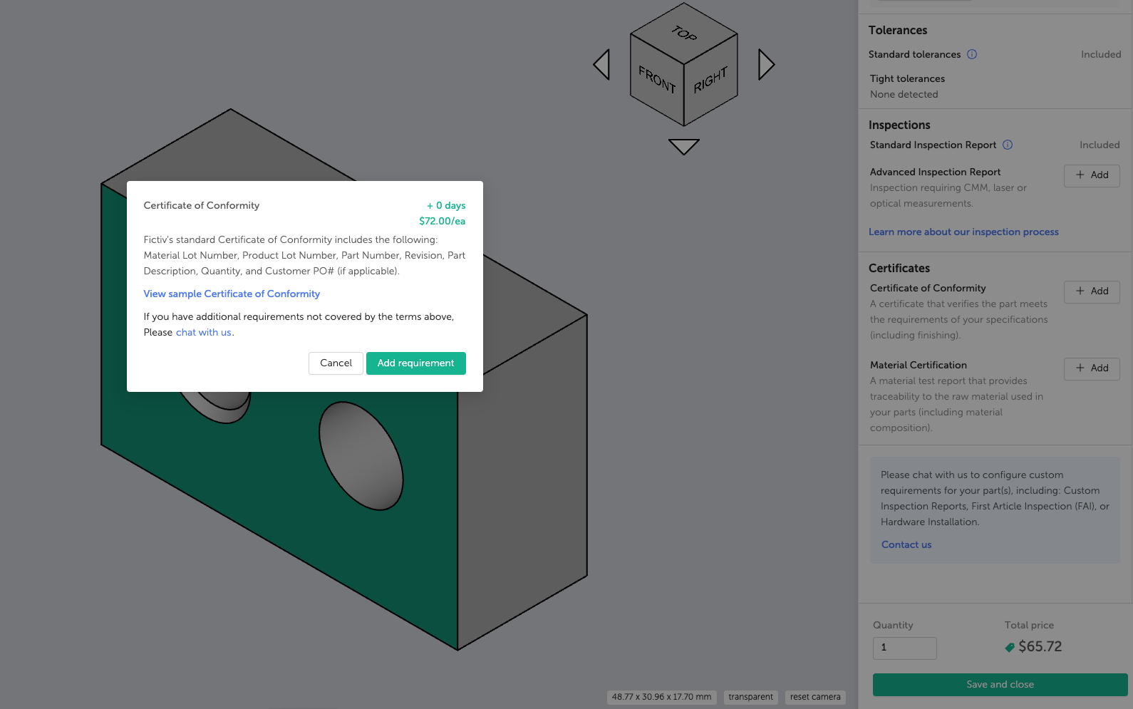

Fictiv quote certificate of conformity
Fictiv Manufacturing and Quality Documentation
Fictiv’s manufacturing platform supports quality documentation as a standard part of the order workflow. When you order through Fictiv, you can request a certificate of conformance, material certifications, and first article inspection as options at the time of order. CoCs issued through Fictiv reference your part number, revision, PO, lot number, and a conformance statement tied to your drawing or specification. Best practice is to call out the CoC requirement on your drawing, speak with your account executive about your documentation requirements, and request it upfront—requesting after the order is placed may impact lead time.
For teams sourcing parts under ISO 9001 or AS9100 quality requirements, or sourcing components for medical devices, Fictiv’s network of vetted manufacturing partners is qualified to support the documentation requirements those programs demand. If you are evaluating a manufacturing partner and quality documentation is part of your qualification criteria, Fictiv provides visibility into supplier quality systems to support that evaluation.
Contact us about your program’s quality documentation requirements or get a free quote for your next part and configure your requirements at the time of order.
