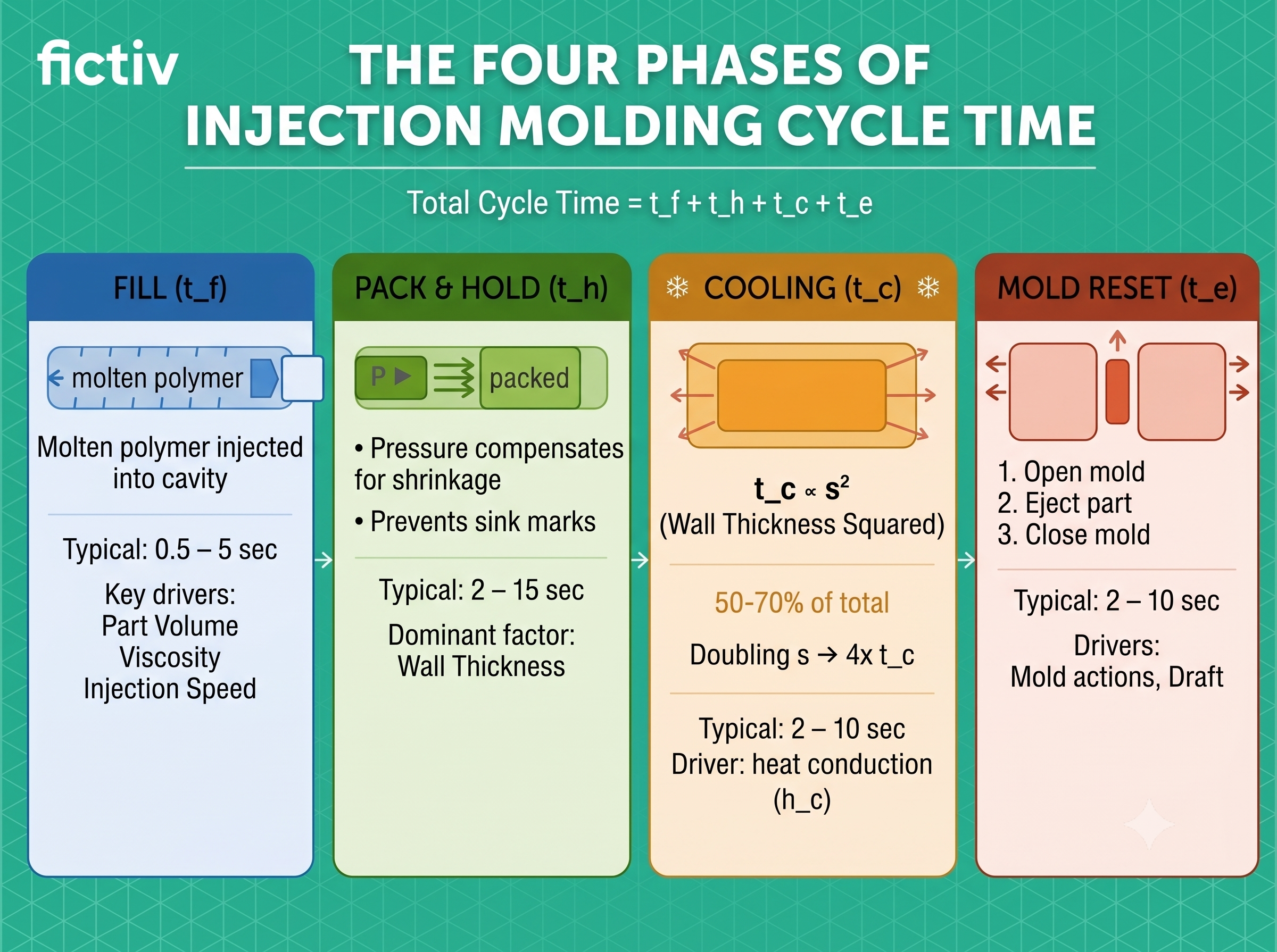

The Four Phases of Injection Molding Cycle Time
Injection / Fill Phase
Molten polymer is injected into the mold cavity under pressure. The injection unit’s reciprocating screw acts as a plunger, pushing material forward through the sprue (the main feed channel), runner system, and gate(s) until the cavity is full. Fill typically takes 0.5-5 seconds. Key drivers of fill time are part volume, polymer viscosity, injection speed/pressure, and gate size/location.
Pack and Hold Phase
Once the cavity is filled, the screw maintains pressure on the melt to compensate for volumetric shrinkage as the material cools and densifies. Without adequate hold pressure and time, parts can develop sink marks over thick sections or end up undersized. Pack and hold typically requires 2 to 15 seconds.
Wall thickness is the dominant factor: thicker sections shrink more and require longer hold times. Hold pressure may also need adjustment alongside hold time, particularly for semi-crystalline polymers such as polypropylene and nylon, which generally shrink more than amorphous materials such as ABS or polycarbonate.
Cooling Phase
Cooling typically accounts for 50 to 70% of total cycle time. Cooling time does not scale linearly with wall thickness. It scales with the square of wall thickness:
tc ≈ (s² / (π² × a)) × ln((4/π) × (Ti − Tw) / (Te − Tw))
Where:
  • tc  = cooling time
  • s = wall thickness (mm)
  • a = thermal diffusivity of the polymer (mm²/s)
  • Ti = melt temperature (°C)
  • Tw = coolant temperature (°C)
  • Te = ejection temperature (°C)
This equation is a one-dimensional approximation for a uniform, planar wall section. It becomes less accurate for cylindrical features, thick bosses, and complex 3D geometries, where multi-directional heat transfer dominates. Use it for directional comparison and early-stage estimation, not final process specification.
Example: For a 3 mm ABS wall section (a ≈ 0.13 mm²/s), with a melt temperature of 230°C, coolant at 30°C, and an ejection temperature of 85°C, the estimated cooling time is approximately 18–22 seconds—consistent with observed cycle times for general-purpose ABS enclosures.
The practical consequence is that doubling wall thickness roughly quadruples cooling time. This quadratic relationship makes wall thickness reduction the most impactful design lever for shortening cycle time.
Mold Open / Eject / Close Phase
The mold opens, the ejector system pushes the part free, and the mold closes and clamps shut again in preparation for the next shot. This phase typically takes 2 to 10 seconds but can be longer on tools with multiple side actions, complex ejector systems, or parts with insufficient draft.

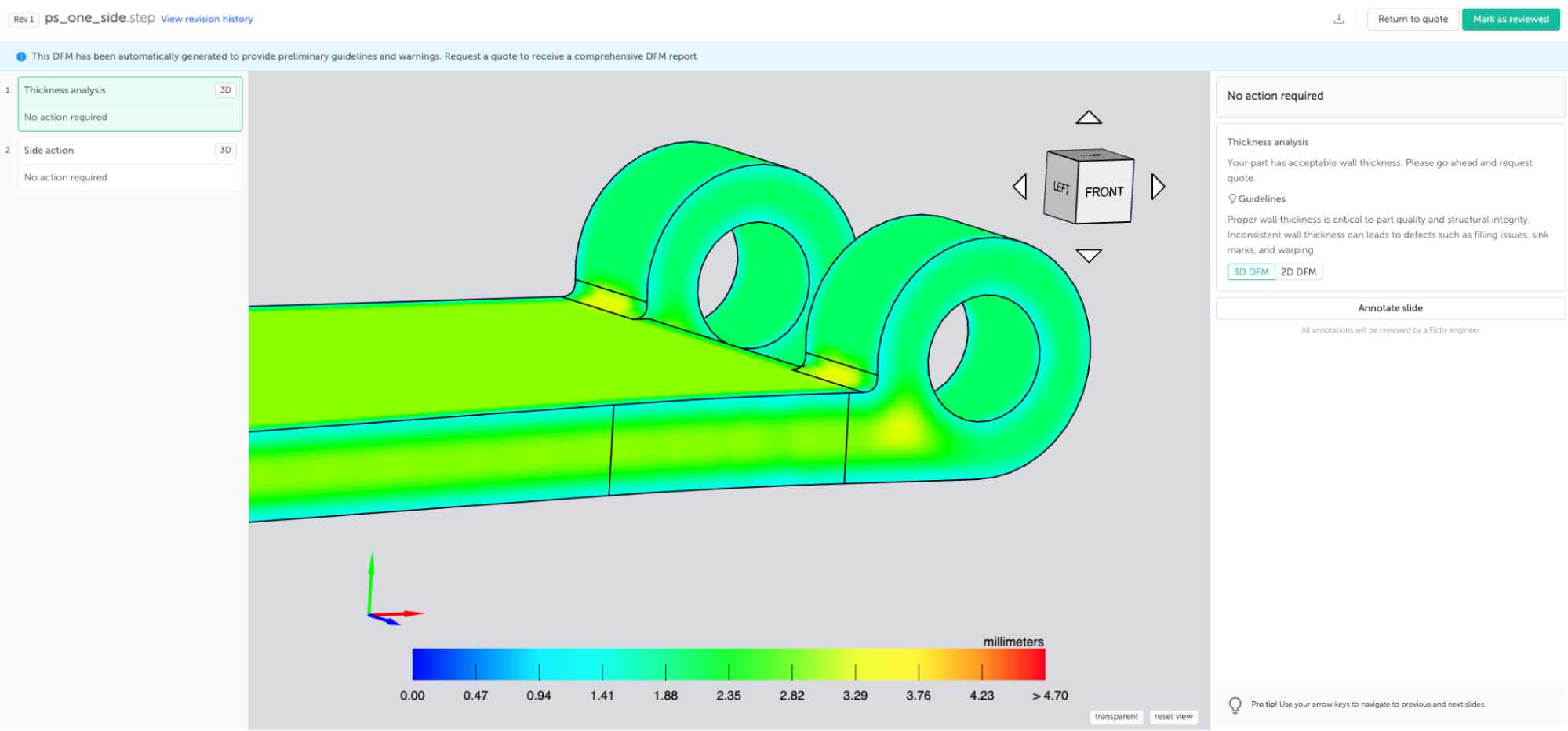

Wall thickness has the largest influence on cycle time of any design variable. Because cooling time scales with the square of thickness, even modest reductions produce significant improvements. A 20% reduction in wall thickness can cut cooling time by roughly 35%.
Wall thickness uniformity matters for the same reason. Non-uniform sections, at bosses, ribs, and transitions, retain heat longer than surrounding walls. The entire cycle waits on the slowest-cooling feature, regardless of how quickly the rest of the part cools.

Injection molding wall thickness analysis
