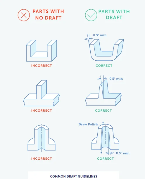

Draft angle injection molding is about applying an angle or taper to the vertical faces of injection molded parts. Draft is measured in degrees and promotes smoother part ejections, decreased tooling wear, and shorter cooling times. The benefits of proper draft include fewer defects, faster cycles, and lower costs.
Typically, designers apply draft angles of 1.5° to 2° degrees to injection molded parts at mold depths up to 2 inches. Applying a slight taper like this might seem simple enough, but you can’t add the same amount of draft to every part – and minimum and maximum draft angles for injection molding can vary considerably.

The walls of your injection molded part aren’t the only features that require a draft angle or taper. All vertical part features, including ribs and bosses, require an adequate draft. The depth of these features and their minimum thickness determine the specific angle to apply. The table below explains.

When you apply draft to injection molded parts, make sure to do so based on the mold’s draw: the direction in which the core and cavity separate. Otherwise, your plastic part may not stay in, or stick to, the half of the mold that contains the ejector system.
It’s also essential to account for part features like holes. For example, in the case of a rectangular part with four through-holes, drafting the holes toward the cavity could cause parts to stick to the cavity instead of the core. A better approach would be to draft the holes toward the core where the ejector system is located.
