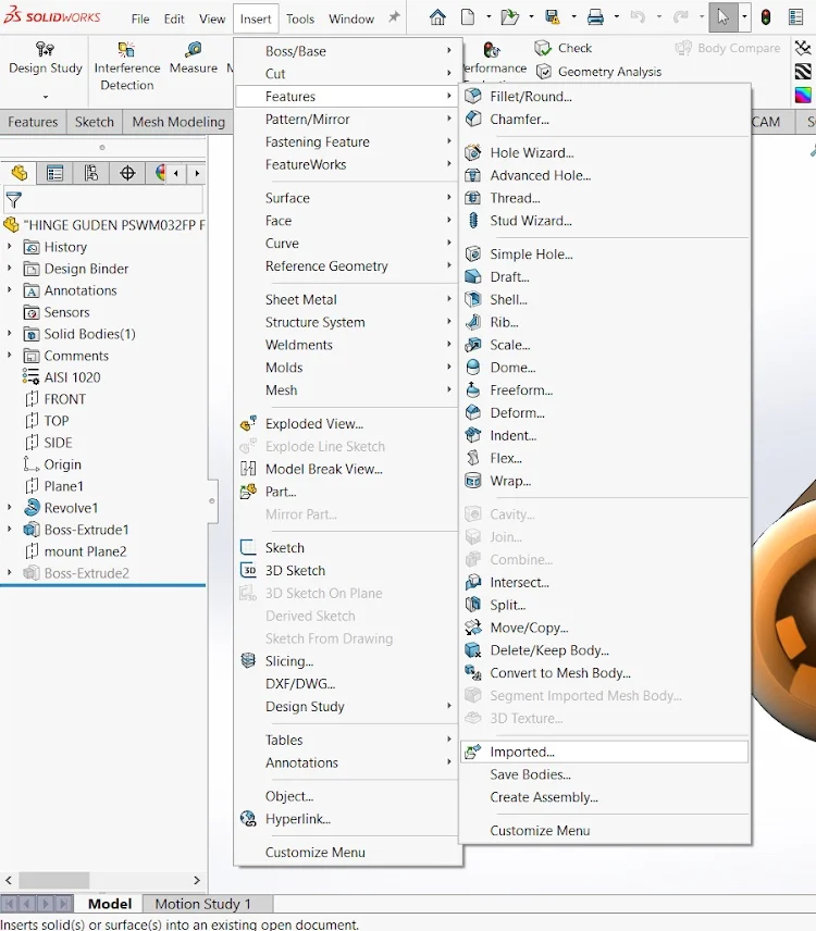

 Save a part as a Parasolid (parametric model)
Then, I use the import command (Insert -> Feature -> Imported) to import it back into the feature tree. I error check the imported geometry and if it passes inspection, only then do I delete all of the features that created it (feature history).
Import feature menu in Solidworks
I recommend this technique only for aspects of your product, not the whole thing. Let’s say you want to cut the top off of your part using a complex surface. You can model the entire part parametrically and use a dummy surface as a cutting tool. In that case, everything would be parametric except for the one item most likely to cause problems if it were parametric. Remember, you can always replace the dummy surface you used as a cutter with a new one.

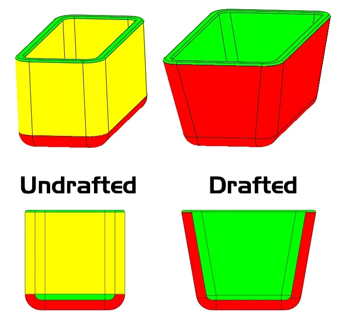

Many people struggle to properly add draft when surface modeling organically shaped injection molded parts. Draft is critical for molded part designs because it facilitates part removal from the mold once the part is molded.
Drafted vs Undrafted Solidworks Surface Modeling
<em>Drafted vs undrafted surfaces<em>

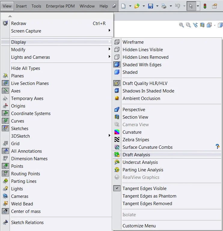

If you ever want to check a part’s draft, use the Draft Analysis tool (View -> Display -> Draft Analysis).
Draft analysis tool
<em>Draft analysis tool<em>
The Draft Analysis tool will color code your part as red, yellow, and green based on a draft plane that you select and a draft angle you choose. Your goal should be to see only red and green, no yellow (yellow indicates where draft is needed).
Color-coded parts in Solidworks draft analysis tool
<em>Color coded parts in Solidworks draft analysis tool<em>

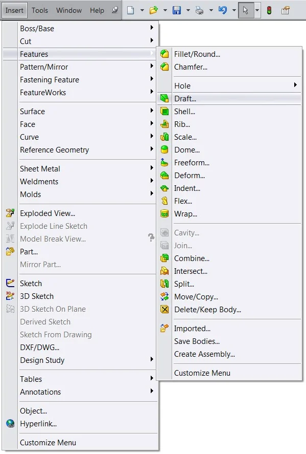

  1. Using the Draft Command (Insert -> Feature -> Draft)
Draft Feature Solidworks Surface Modeling
<em>The draft command in Solidworks<em>

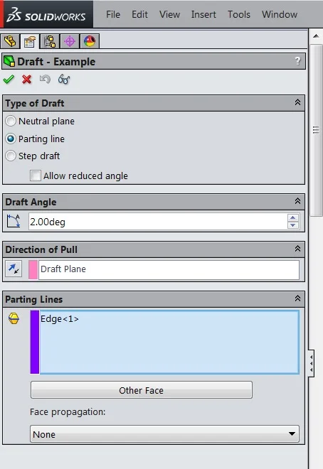

The Draft command is the most commonly used tool to add draft to existing geometry. This is the one most often taught in training classes, and the tool that you would expect to use. What you might not know about the Draft feature is that it works on surfaces as well.
The most useful setting for this feature is choosing “Parting Line” as your type of draft instead of “Neutral Plane”. This allows you to choose an edge that will remain constrained to its current position while the adjoining face is drafted. That edge does not need to be flat, so this feature is incredibly helpful when designing organically shaped parts.
Choose “Parting Line” as your draft type
<em>Choose Parting Line as your draft type<em>

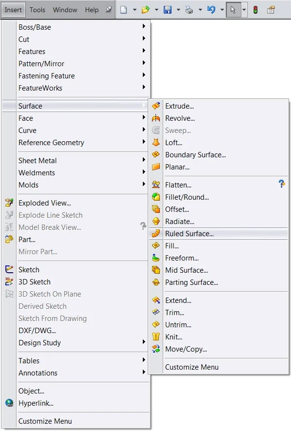

  1. Use the Ruled Surface Command (Insert -> Surface -> Ruled Surface)
“Ruled Surface” Solidworks setting
<em>Ruled Surface Solidworks setting<em>

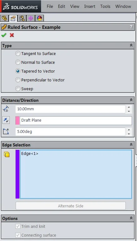

The Ruled Surface command is a great feature for creating drafted surfaces mostly from scratch. This feature will create a surface (not a solid), so it’s a surface modeling feature. To use “Ruled Surface” to create a drafted surface, choose the “Tapered to Vector” option and choose your draft plane as the vector. Then, choose an edge to begin your new surface. Lastly, you choose which direction you want the surface to go, by how much, whether you want the surface drafted IN or OUT, and at what angle.
Choose the “Tapered to Vector” option in the Ruled Surface feature
<em>Choose the Tapered to Vector option in the Ruled Surface feature<em>

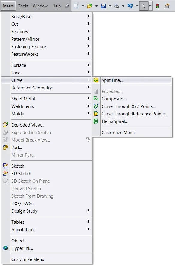

  1. Use the Split Line Command (Insert -> Curve -> Split Line)
Solidworks Split Line Settings
<em>Solidworks Split Line settings<em>

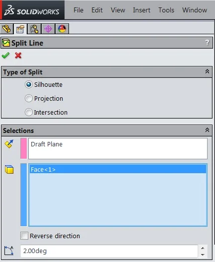

Many engineers don’t know that Split Line can be a useful tool when drafting a part. If you select “Silhouette” as the type of split, you can choose a draft angle at the bottom. When you click ok, it will analyze the surface you selected and split it into two separate faces. One face will be in draft to the angle specified (or more) and the other will not. You can then use Ruled Surface or Draft to draft the undrafted face.
Split Line Settings Solidworks
<em>Select Silhouette as the type of split and choose a draft angle<em>
