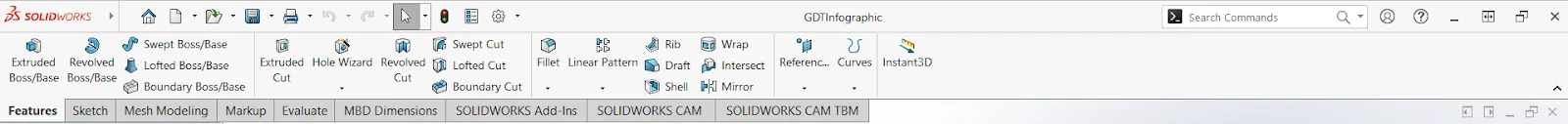

SOLIDWORKS Command Manager
The Command Manager, shown above, is touted by Dassault Systèmes (the maker of SOLIDWORKS) as a simple and easy-to-use location for all the features, sketch tools and evaluation tools that a designer might need.

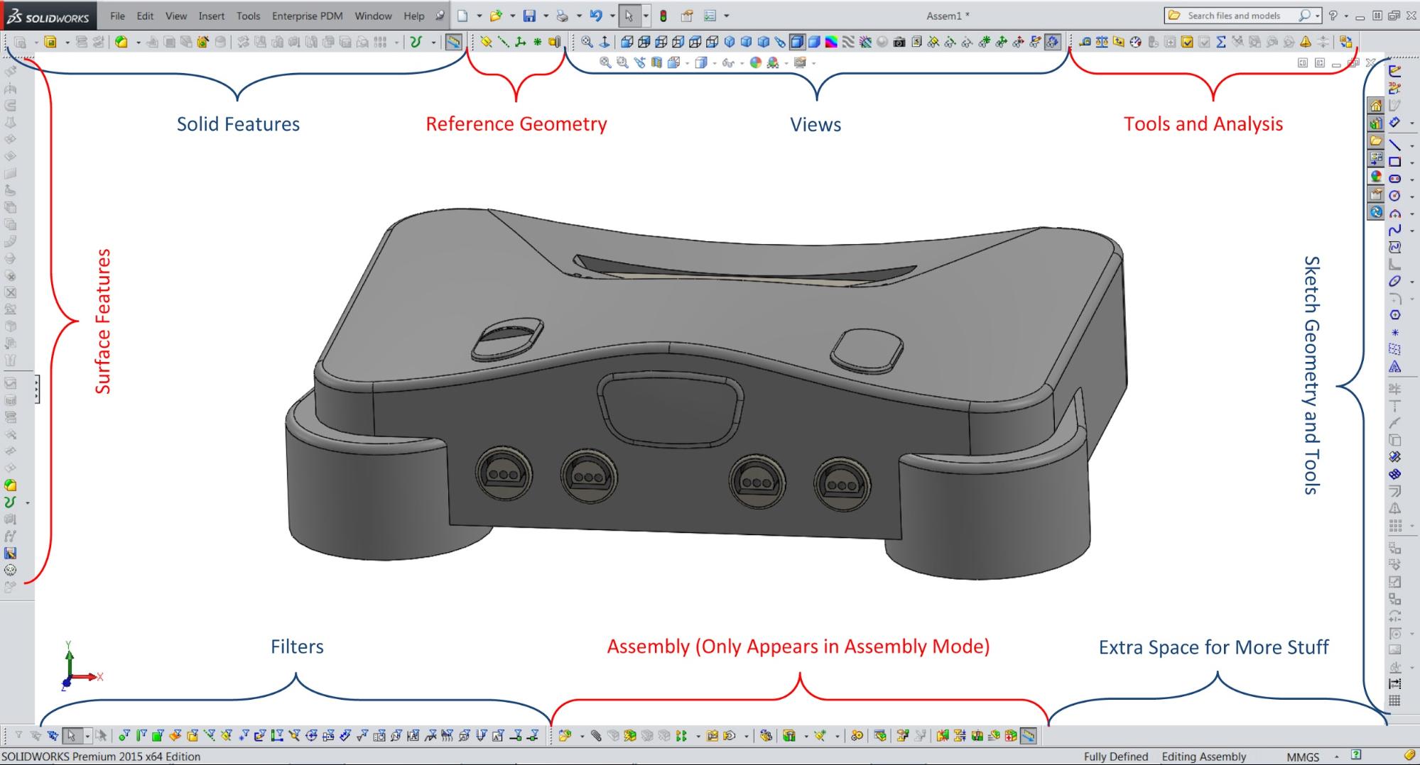

But simply put, it’s for n00bs. If you want to become a SOLIDWORKS pro, consider ditching the Command Manager in favor of a comprehensive and customized toolbar setup. It’s the quickest and easiest upgrade you can make.
Here’s an example of such a setup with a brief explanation:
A comprehensive, customized toolbar setup
As you can see in the picture, the 3D model is surrounded by about 200 SOLIDWORKS icons, that can each be used via a single click. Many of these features cannot be found in the Command Manager. For those that are in the Command Manager, such features require multiple clicks to use.
Switching to a custom setup like the example above can save you hundreds of clicks per hour! I know, it used to be that you couldn’t sacrifice so much screen real estate for commands. However, with large, hi-res screens, you still have plenty of space for your 3D model and the feature tree itself.

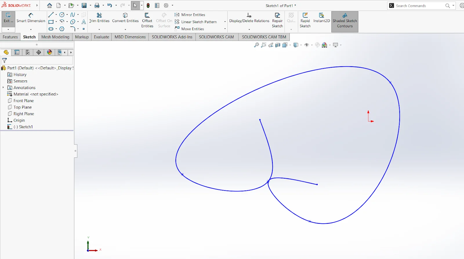

Use a Maximum of 3 Points per Spline

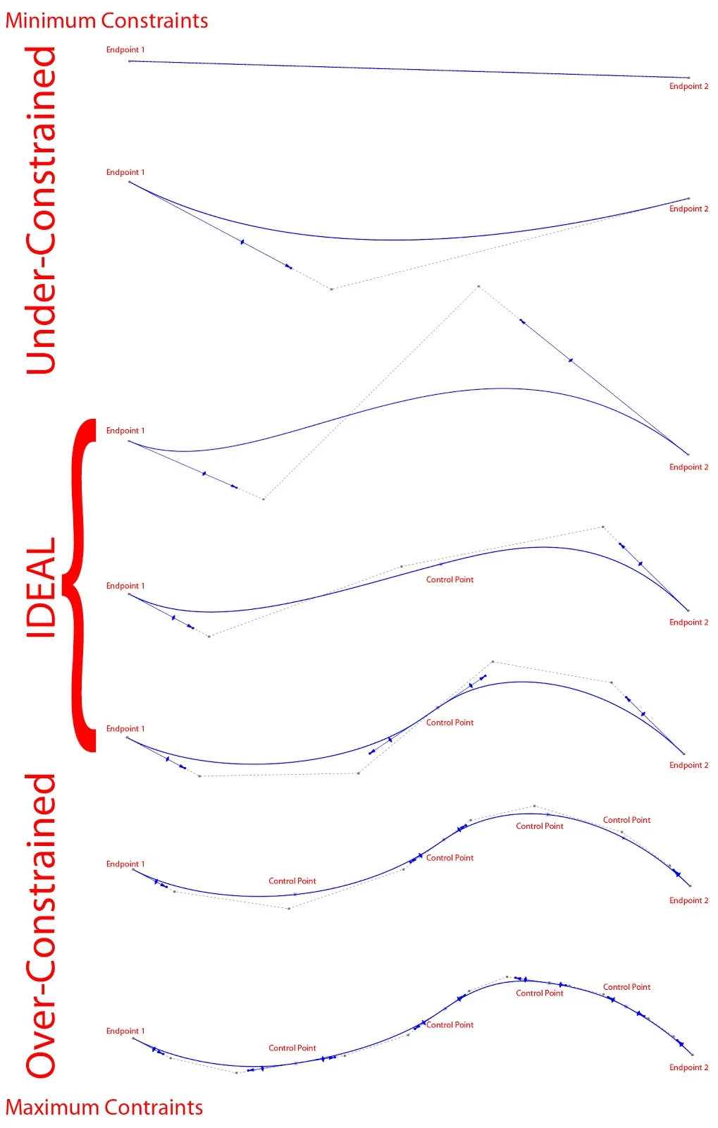

A spline in SOLIDWORKS is a method for creating complex or non-uniform curves — they’re either B-splines or style splines (Bézier curves). Splines are great for creating organic shapes while keeping good control over the results. However, too much control can negatively affect results as much as too little control.
The end points of a spline control the curvature constraints, while the through points of a spline dictate the weight and direction of the tangency of the localized curvature. As a general rule, try to use as few spline points as possible to achieve the desired result. I keep all of my splines limited to 3 points (both ends plus ONE control point somewhere in between).
SOLIDWORKS lets you add as many control points as you want to, but I don’t recommend it. Adding more than one control point tends to over-control the spline when using features such as lofts and sweeps, which yields undesirable waviness or ripples in the resulting surface(s).
The picture below shows what happens to a spline as you add more constraints or controls to it. As you can see, not enough constraints yields an undefined spline. On the other hand, too many constraints will make the spline appear more jagged, and those jagged transitions cause undesirable waviness and ripples.Pro-Tip: Check out this SOLIDWORKS help center article to learn more about deleting excessive spline points.
What happens to a spline as you add more and more constraints or controls

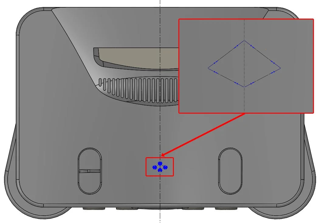

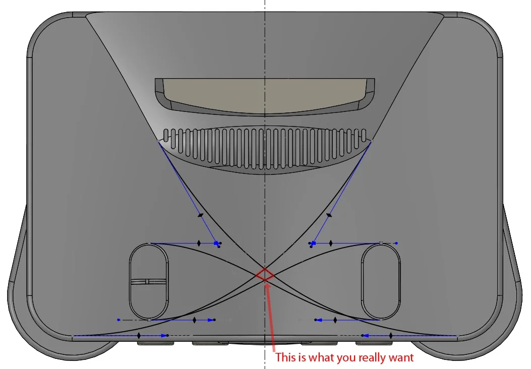

Here’s an example: Let’s say you want to add a recess for your company logo on your product. You want the recess to be a diamond shape, but you want the sides of the diamond to be somewhat curved. In fact, you want the sides of the diamond to be curved in relation to other aesthetic elements in your product. So, you draw a collection of fully editable splines as shown below:
A drawing of a collection of fully editable splines
If you can tell from the image above, the original splines were set to tangent to geometry in the part itself. If you trim the splines so that only the curved diamond shape is left, the result is the same curved diamond, but the control points have moved to the corners of that diamond, as shown below.
A drawing with the splines trimmed
Once you trimmed these splines together, you lost the method you used to control the shape itself. At that point, you would just be eyeballing any changes to the splines and hoping the results look good.The solution to this problem is something I call the Master Sketch Method:

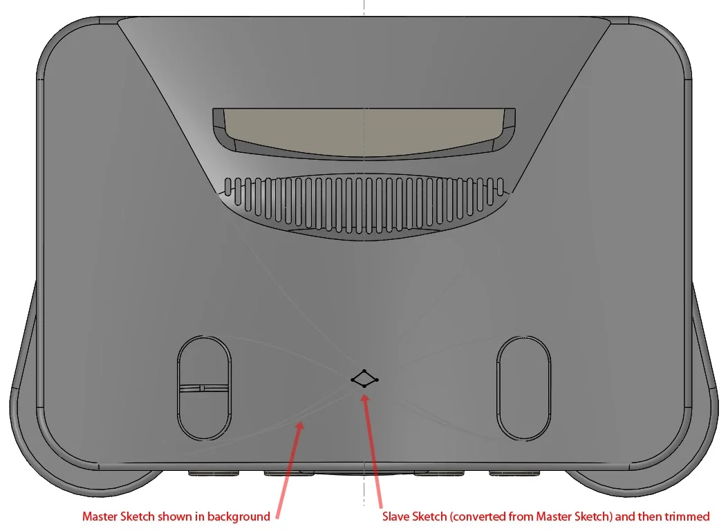

Step 1
Draw as much content as you want in a single sketch. Don’t worry about trimming lines or splines. Instead, leave them all their original length. Call this sketch your “Master Sketch”.
Master Sketch
Step 2
Create a new sketch on the same plane (or a parallel one) and use the convert entities SOLIDWORKS tool to convert some or all of the items in the Master Sketch into your new sketch. Call this new sketch your “Trimmed Sketch”.
Step 3
In the Trimmed Sketch, trim the converted entities from Step 2. Use this trimmed sketch for whatever feature you want.
Result
Your Master Sketch will be exactly how you originally drew it. Your Trimmed Sketch will be a trimmed version of the Master Sketch. Editing the Master Sketch will update the Trimmed Sketch, but the constraints intended for the splines are left intact.
Trimmed Sketch (sometimes also called a slave sketch)
Quick FAQs – Spline Sketches
  1. The Master Sketch method can be used for as many Trimmed Sketches as you want (maybe different variations of trimming the splines together).
  2. Editing the Master Sketch’s existing entities yields no rebuild issues unless you add or delete geometry from the Master Sketch.
  3. If you delete entities in your Master Sketch, the Trimmed Sketches will show those deleted entities as dangling. You can simply delete those entities from the Trimmed Sketches as well.
  4. If you add entities to the Master Sketch, it will update the Trimmed Sketches properly ONLY if you converted the entire Master Sketch at once. If you picked and chose what to convert and what not to, then your Trimmed Sketch will not automatically add the geometry you added to the Master Sketch. In that case, you can edit the Trimmed Sketch and use the Convert Entities tool to re-add the missing geometry from the Master Sketch.
