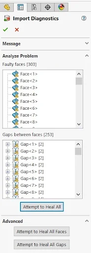

SOLIDWORKS has a useful, built-in Import Diagnostics wizard that will attempt to assess and/or repair imported geometry errors. Specifically, the Import Diagnostics wizard is good at repairing faulty surfaces, knitting repaired surfaces into closed bodies, and making closed bodies into solids.
The tool is quite powerful and should not be overlooked. If a model is imported with faults, an error message should pop up and ask if you want to run Import Diagnostics – click Yes to begin. If the wizard does not pop up automatically when you import geometry, you can open the wizard by clicking: Tools > Evaluate > Import Diagnostics. The icon looks like this:
import diagnostics wizard iconThe wizard will list all “faulty faces” (they are exactly what they sound like) and “gaps between faces”, which are basically missing surfaces or holes in your model. Once open, the wizard may look like this:
Import Diagnostics Wizard Showing Errors
Note: If you are intentionally importing a surface body (a body that is not completely enclosed and therefore “solid”, the surface’s boundary will come up as a “gap”. In that case, you can ignore that gap.
The wizard finds problems by running the Evaluate > Check function and searching for additional errors, such as overlapping surfaces, non-simplified surface (B-splines that are planar), etc.
Once this wizard lists all the errors, it gives you the option to “Attempt to Heal All”, “Attempt to Heal All Faces”, or “Attempt to Heal All Gaps”. The Import Diagnostics feature works to fix errors when importing to SOLIDWORKS by performing one of the following:
  • The wizard works to repair errors in geometry, the underlying surface, and topology, the boundaries, of faces by recreating the trim boundaries of a face (to fix overlap), trimming defective portions of faces, or removing the face and utilizing a gap repair algorithm to fill the resulting hole.
  • The wizard works to fix gaps between adjacent faces by swapping two close, but non-intersecting edges, with a single edge, filling the gap with a created fill or lofted surface, or merging two adjacent faces to fill a gap.

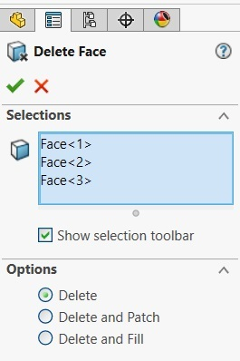

In many cases, you will try to use the Delete Face command
delete face command icon(Insert > Face > Delete) with the option set to “delete”, and the command itself won’t work on your model. In fact, it won’t let you delete ANY of your model’s faces. Not even one! That’s crazy!

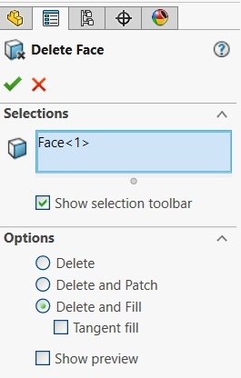

Here is the workaround:
Use the Delete Face command
delete face command icon(Insert > Face > Delete), with the option set to “Delete and Fill”, as shown below. Now, choose a single face from your model at random. Nine times out of ten, the command will work, and it will replace that face with some weirdly shaped surface. Ignore the new surface. Now, try the Delete Face command again, on whatever face you want, using the “Delete” option. Now, it will allow you to delete the face(s) SOLIDWORKS wouldn’t let you delete before. Does this make any sense? Of course not, but this method does work on some versions of SOLIDWORKS. Try it out for yourself and see if this workaround works for you!
Delete Face and Fill

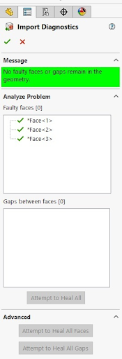

2) Rerun the Import Diagnostics Wizard on Half the Model
As mentioned at the beginning of this article, the Import Diagnostics wizard is an excellent tool for fixing import errors. However, the Import Diagnostics wizard will only work on NEWLY imported geometry. Once you add commands to the feature tree, the Import Diagnostics wizard will grey itself out and become unavailable. If you have made changes to your part (including cutting or trimming your part in half) and would like to re-run the Import Diagnostics Wizard, save your updated part as a parasolid (*.X_T), or another equivalent file type, and then delete all the features in your feature tree, OR start a new SOLIDWORKS part file. Now, import the Parasolid, or other model, you created.
Note: You can import Parasolid files into an already open SOLIDWORKS part by using Insert > Feature > Imported.
Since the newly imported geometry will be the only feature in your feature tree, the Import Diagnostics wizard will be available to you again. So, re-run the Import Diagnostics wizard and use the “Attempt to Heal All” button (See the The Magical “Attempt to Heal All” Button: Import Diagnostics section above).

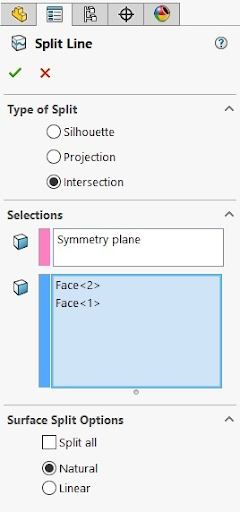

  • To split a face using a plane, use the Split Line command (Insert > Curve > Split Line) and choose the option for Intersection
Split Line - Option for Intersection

  • To delete faces of a surface or solid without filling in the resulting hole, use the Delete Face command delete face command icon (Insert > Face > Delete) and set the option to “Delete”

  • To delete faces of a surface or solid and automatically fill in the deleted face(s), use the Delete Face command delete face command icon(Insert > Face > Delete), and set the option to “Delete and Fill”
