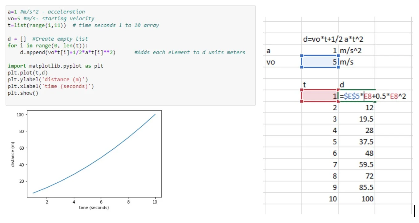

Why code? A script is entirely easier to review than, say, an Excel sheet (I used to TA for 3 classes of 60 students, plus my own engineering work —> no script, no help).
Excel sheets can be organized any which way, and most users don’t assign variables–they give cells values. F=ma. Something simple can turn into =c6*$f$3…and that’s simple, but already, you have no context what that means, without hunting in a spreadsheet trying to decode the original user’s Excel organization.
Now, start actually doing unit conversion, adding in constants, and then everyone starts doing it differently inside the Excel matrix. F=ma in a script—well, it should automatically trigger some apple-falling-from-the-tree thoughts.
With code, on the other hand, you can follow it step by step, and it’s easier to see fundamental engineering errors. Syntax will work itself out, because else: # your code will not run. This, in and of itself, helps make reviewing engineering work more efficient for everyone involved.
See my two side-by-side comparisons below, where I show a very basic engineering equation in Python and in Excel. The Python example is self-contained, and someone should be able to review it very quickly. The Excel example isn’t hard and can be decoded, but $E$5 doesn’t mean anything, unless you figure out what E5 is inside the sheet.
![](https://www.fictiv.com/wp-content/uploads/2020/09/5ed7e6c5ba03062ccb8cce11_real-engineers-code_image01.jpg)
If your goal is to create a usable document, knowing how you got to the numbers in front of you is as important as the numbers you end up with. And knowing how you got to your answers is easier with a script. That script can allow you to speed up every task like it from that point on, with a little bit of upfront work. Hey, it’s more interesting than copy-pasting for hours every day.

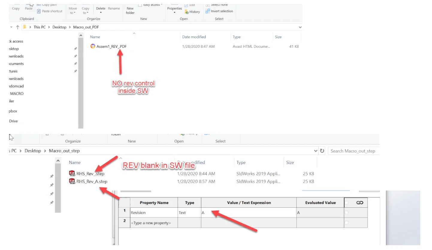

To get the rev letter to appear, you need to use the property feature (File>>properties). If you don’t put that in or have anything in that value box (see images below), you will not get your rev control.

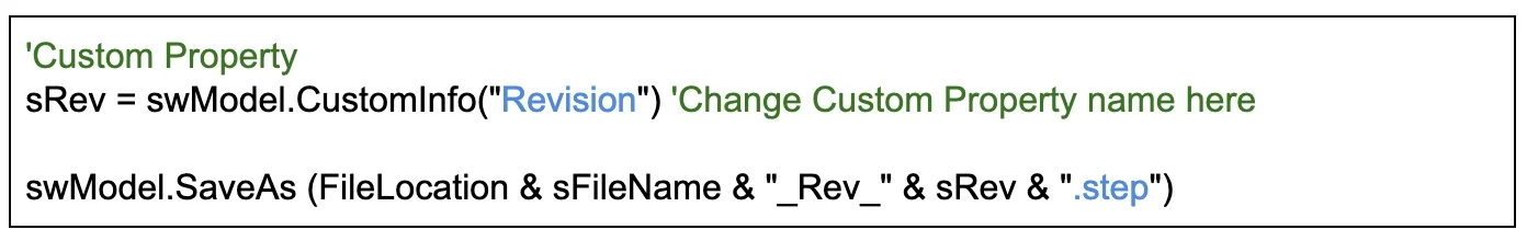

Fun fact: Here, if you look at the code, you could also automatically export other properties. If you look for the property towards the end of the code, you can see how you search for “Revision” and get its value. If you use Solidworks and define the material as an example, you should be able to figure out how to extract that from your properties in your code.
Table: Script for getting revision and saving as step
![](https://www.fictiv.com/wp-content/uploads/2020/09/5ed7e88cc80c595a817a6cfc_real-engineers-code_image03.jpg)
You can also see how save as “step” is done. You could easily make this macro save as an “.stl” I bet you’re smart enough to figure that out. (Make sure to save it as a new script and make it its own button, so you can still make steps, too!).

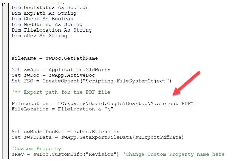

Edit these Macros:
Sw>>Tools>> Macro>>Edit
Under the file location, copy and paste in a location of your choice for the output of both macros in between the quotes “your_file _location“:
The reason this is hard-coded is to speed things up. Guiding you to select the directory doesn’t help speed you up. I only export stuff when I’m sending it elsewhere (quality release, Fictiv, etc).
Note: You actually have to create a folder and copy its location. The code will not auto-generate this folder for you if it doesn’t exist. In Tables 1 and 2, I’ve copied the code to show you in red highlighting where you need to update your code to work.
Here is a screenshot of the edit tool from inside the Solidworks VBA edit window:
