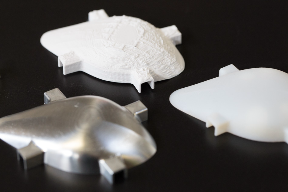

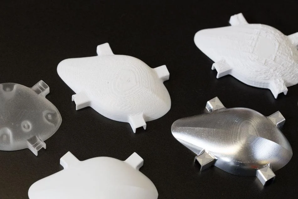

A selection of materials and manufacturing processes used for a functional drone prototype

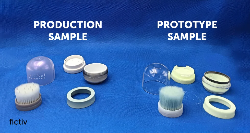

Prototype and production samples for m’Chel Haircare’s Day After Brush

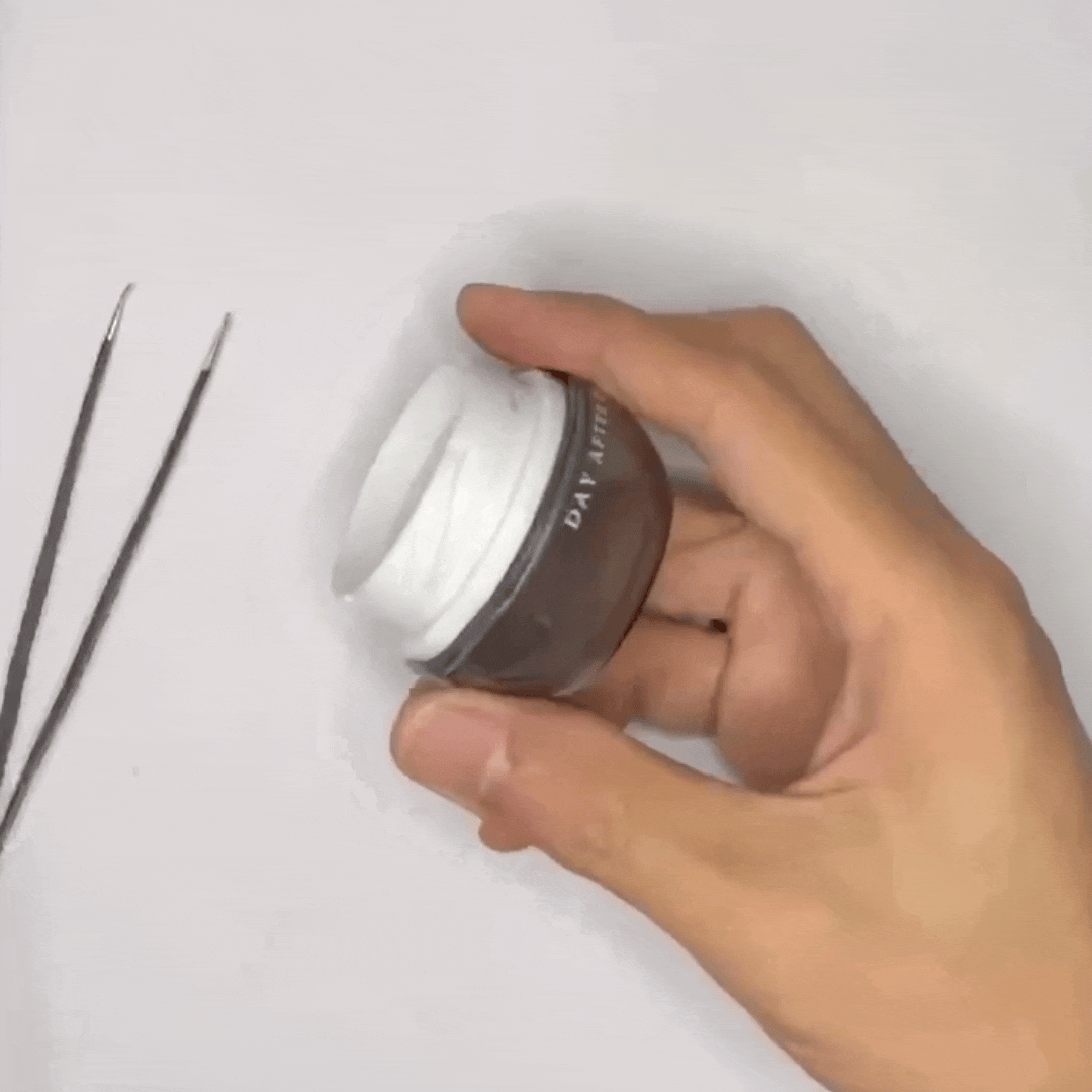

Validating the assembly of a production sample to prevent leakage.

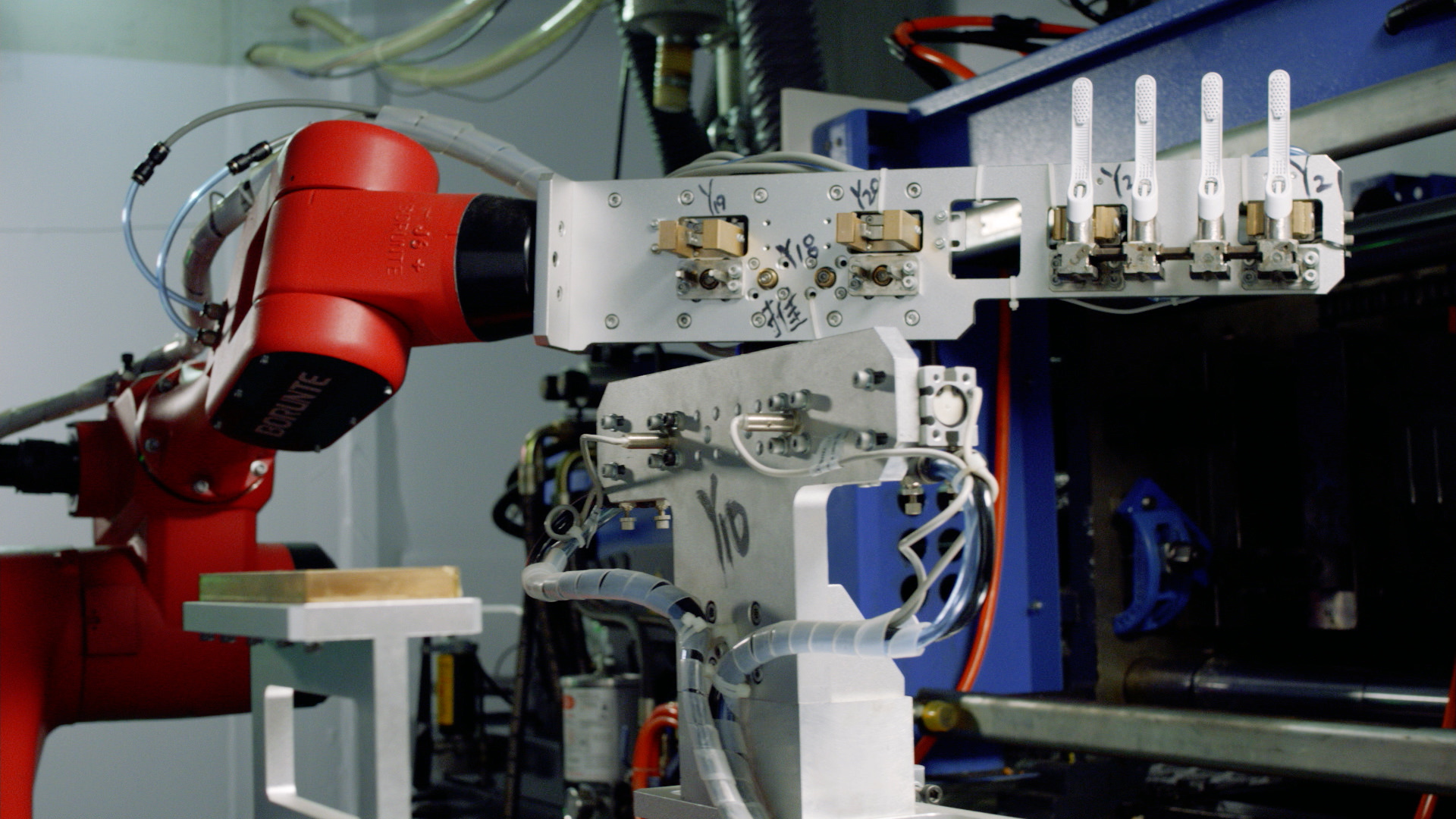

A robotic arm passes quip toothbrush heads between two injection molding machines for a two-shot production process.
