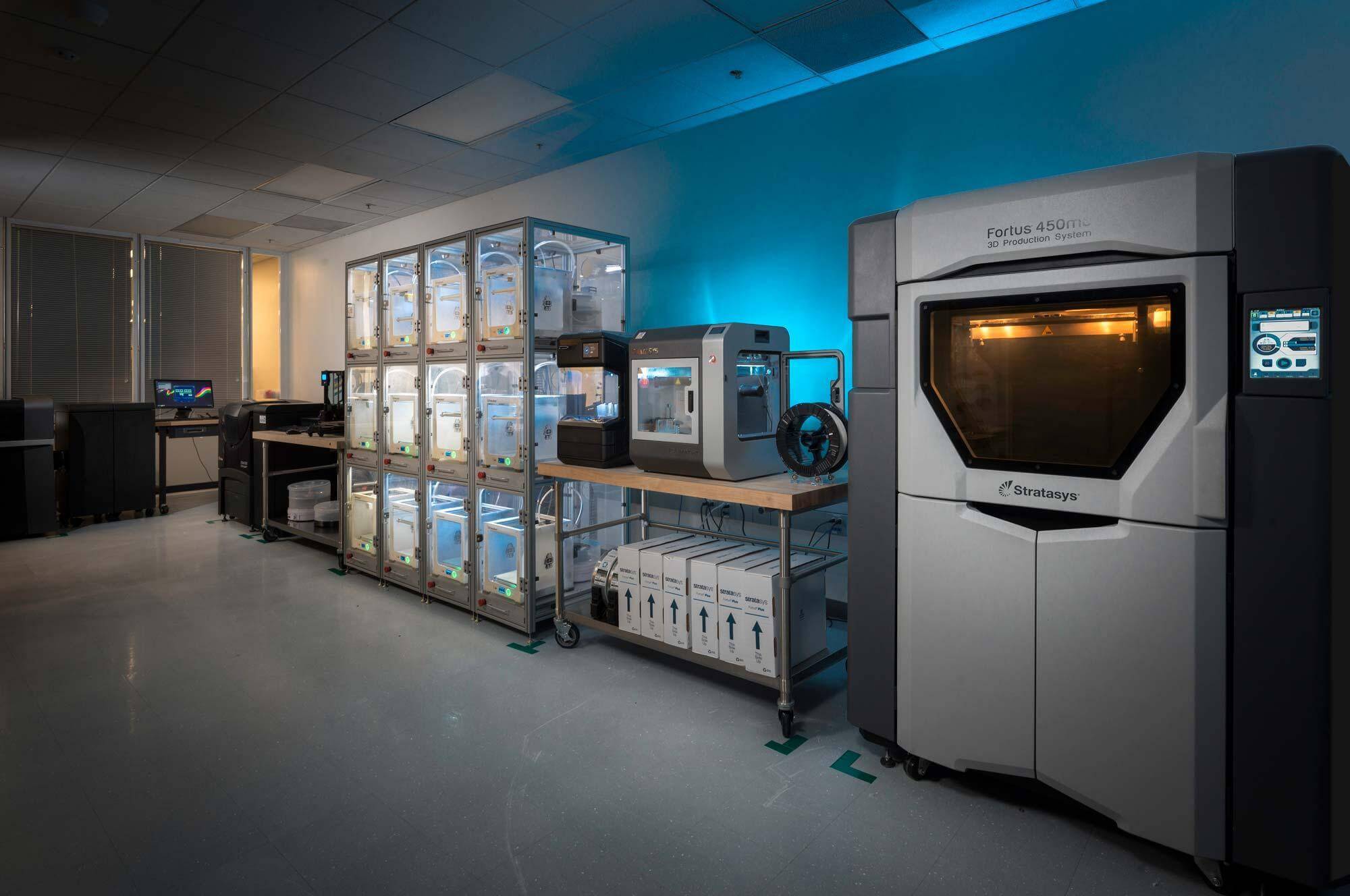

How 3D Printing Is Scaling for Mass Production
Traditionally, 3D printing has faced limitations that have hindered its adoption for mass production. These include slow production speeds, high cost per part, manufacturing constraints, and limited material options, which make the process less viable than traditional methods.
However, recent advancements are overcoming these challenges to make 3D printing more scalable. Technologies such as Carbon’s Digital Light Synthesis (DLS), HP Multi Jet Fusion (MJF), and Selective Laser Sintering (SLS) have significantly increased print speeds. At the same time, automated 3D printing farms enable continuous production, reducing downtime and improving efficiency.
Furthermore, the development of improved materials has enhanced the strength, heat resistance, and overall functionality of 3D-printed parts, solidifying the technology as a competitive option for large-scale manufacturing.

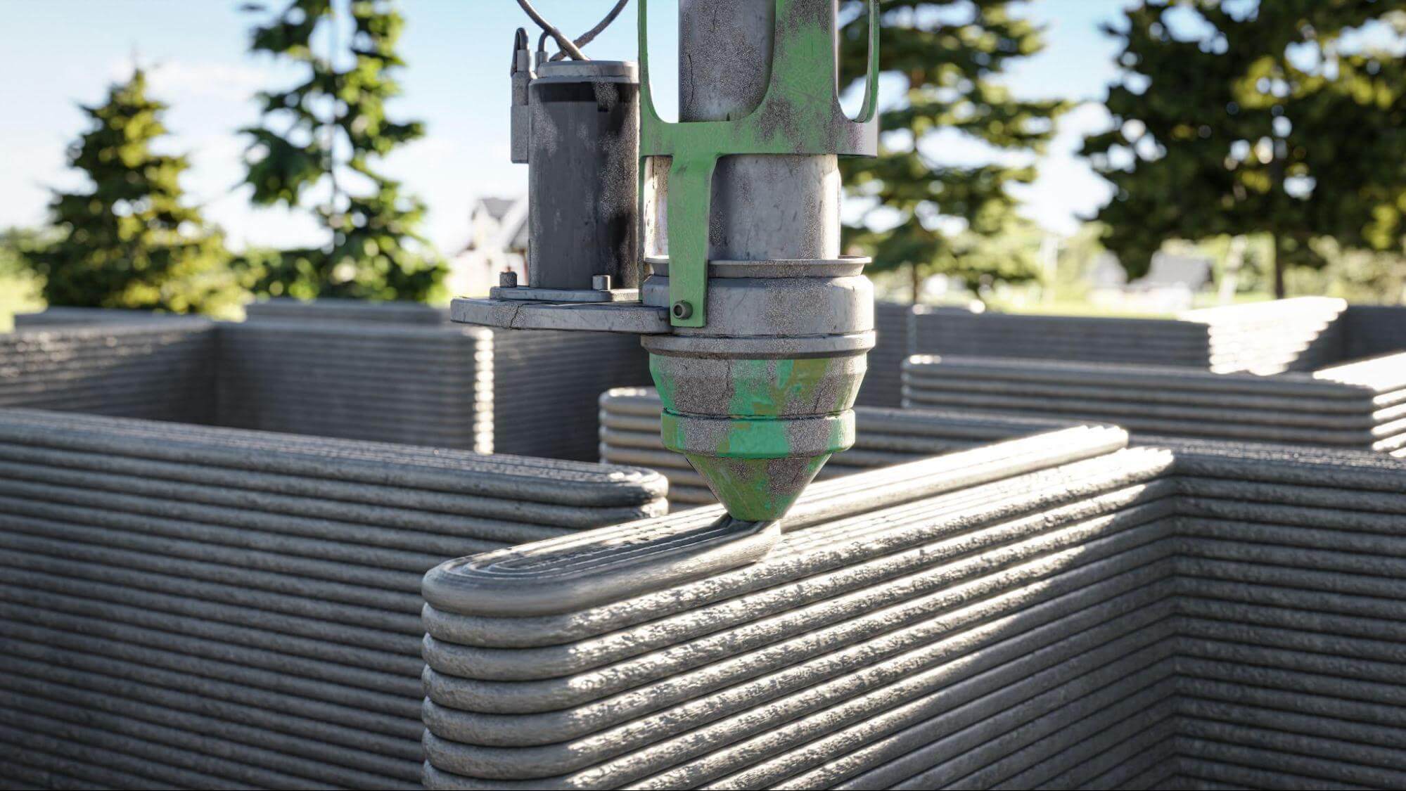

3D printing is used for scalable production in many applications including building houses

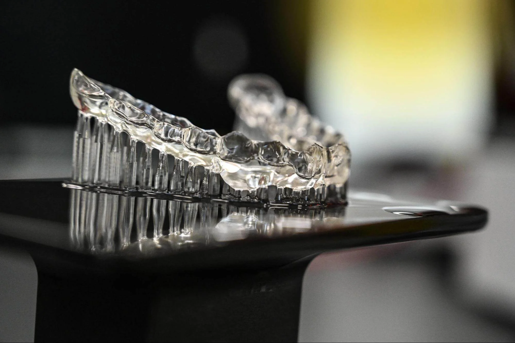

Mass Customization
3D printing can create unique products without increasing costs commonly associated with traditional manufacturing methods, such as tooling fabrication and the labor required for machine setup and operation. Some examples of 3D-printed products include Invisalign (for teeth alignment), medical implants, and custom-fit consumer goods.

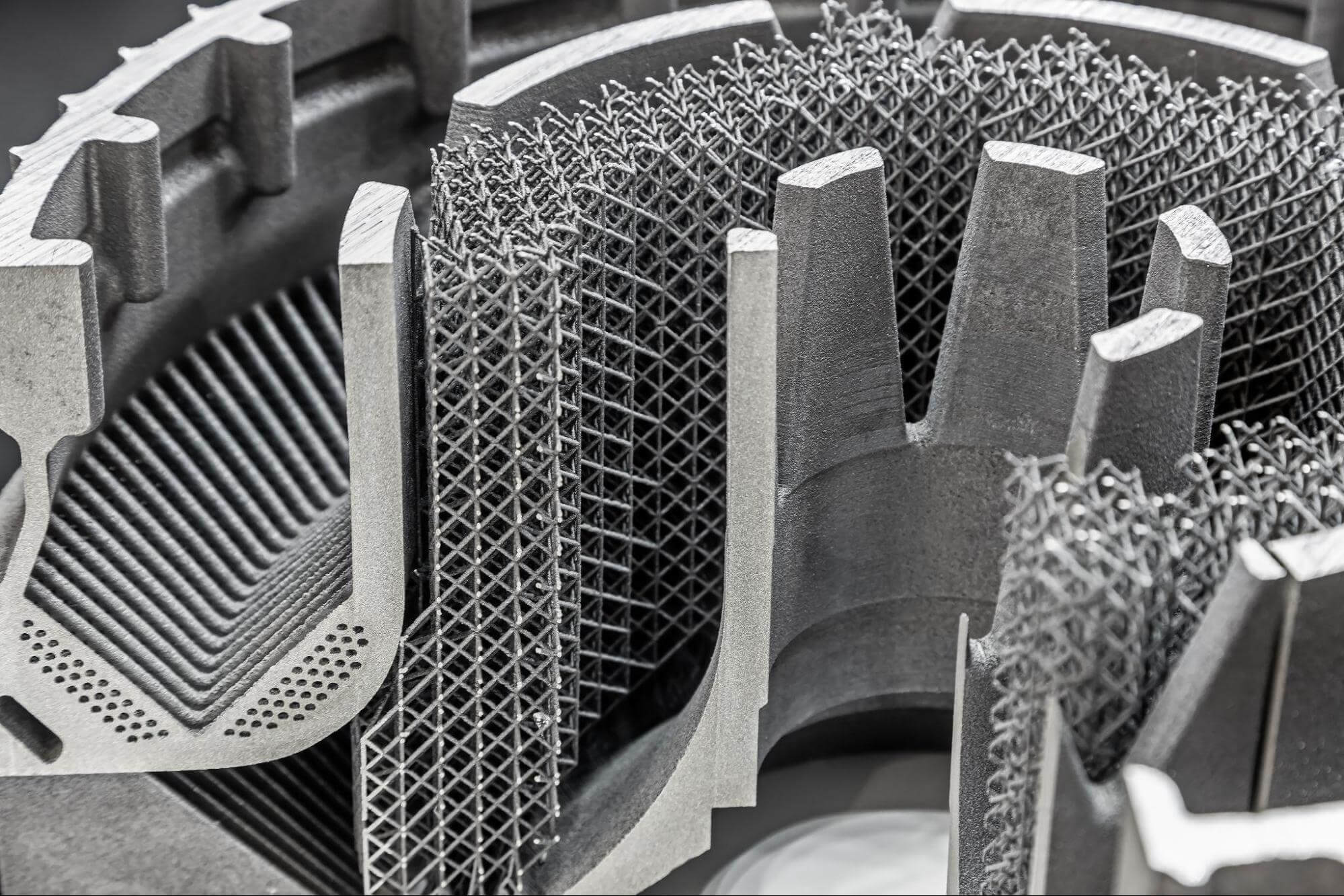

Lightweight Lattice Structures
3D printing can create stronger yet lightweight designs without the limitations of injection molding. A 3D-printed lattice structure reduces the product’s overall weight while improving its rigidity. These characteristics benefit industries like aerospace, automotive, and footwear, which require strong, lightweight products.
3D printing can be used for production in applications requiring customization, such as orthodontic treatment.
3D printing can be used for production in applications requiring customization such as orthodontic treatment

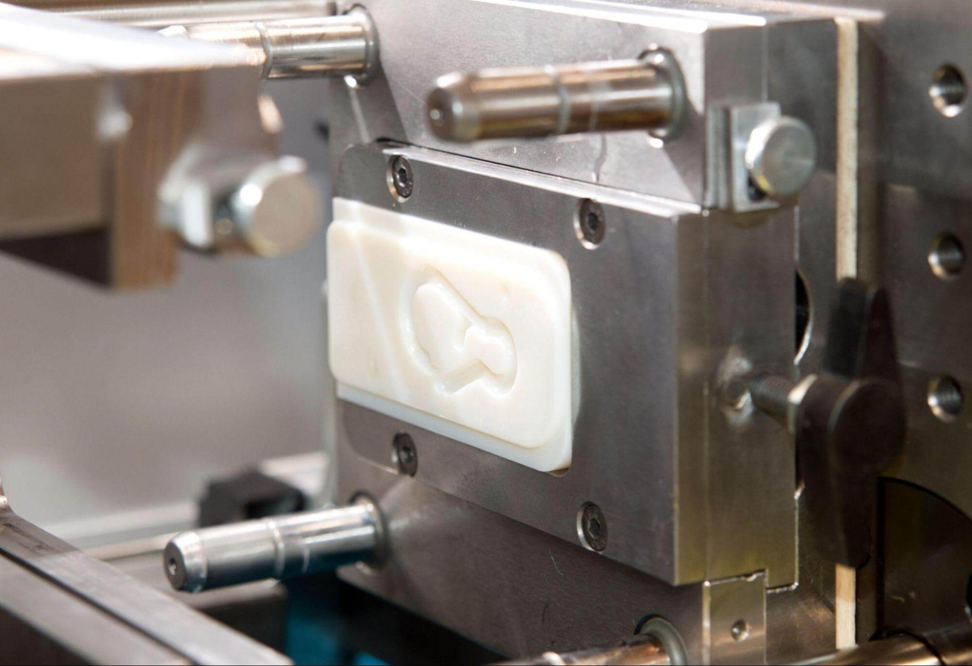

The Role of 3D-Printed Molds in Hybrid Manufacturing
3D printing also plays an essential role in traditional manufacturing by producing molds for injection molding, thermoforming, and casting. One of the primary benefits of using 3D-printed molds is the ability to quickly iterate and refine mold designs without the high costs associated with traditional steel or aluminum tooling. This approach significantly reduces both cost and lead time for early-stage production and makes it ideal for companies looking to test designs before committing to expensive steel molds.
For low-to-medium production runs, 3D-printed molds or castings offer a cost-effective alternative to traditional methods. However, aluminum or steel molds remain the superior option for large-volume runs beyond a certain threshold due to their durability and cost efficiency at scale.

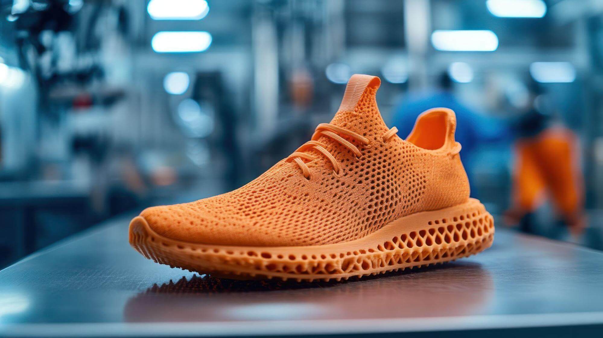

Real-World Case Study: Adidas and Carbon 3D Printing
Adidas leveraged 3D printing and Carbon’s DLS technology to mass-produce midsoles for the Futurecraft 4D shoe line, showcasing the viability of 3D printing in large-scale manufacturing. With Carbon’s DLS technology, Adidas eliminated the need for expensive tooling required in traditional foam molding while also significantly reducing production costs and time.
3D printing also enabled the creation of intricate lattice structures to enhance performance and reduce the overall weight of the midsoles. This innovation allowed Adidas to produce over 100,000 pairs, proving that high-volume 3D printing for mass production is achievable.
This approach has major implications for the future of manufacturing, particularly in customization at scale. 3D printing allows for unique midsoles tailored to individual athletes and accelerates design iteration without the need for new molds, streamlining the development of new product versions.
3D printing can be utilized for production in practical applications, such as shoe soles.
3D printing can be utilized for production in practical applications such as shoe soles

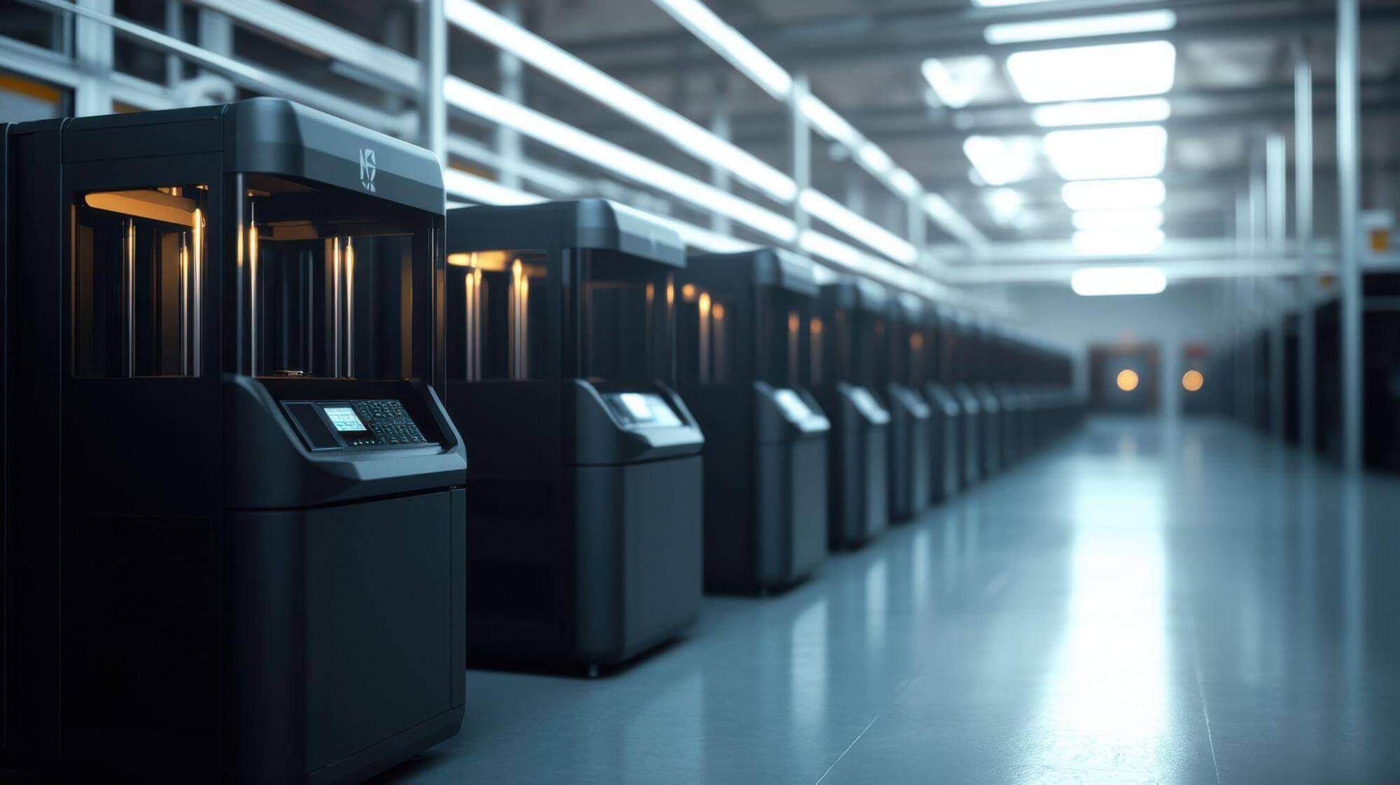

Automation & AI in Additive Manufacturing
Advancements in automation are enabling 3D printing farms to operate 24/7, significantly improving production capabilities. Additionally, AI-driven print optimization is enhancing efficiency by reducing material waste, optimizing print paths, and improving part quality. These innovations are making large-scale additive manufacturing more practical and cost-effective.

3D printing can be used to produce lightweight lattice structures.
