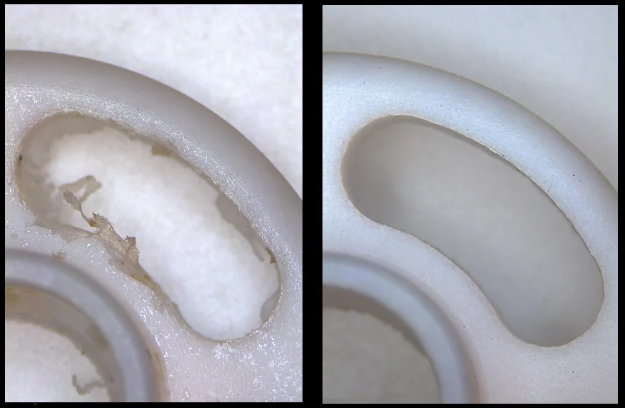

Flash
Parting line location also determines the location of mold flash. If the two halves of a mold don’t align properly, molten plastic can escape. Flash can also emerge between ejector pins and their holes. Shutoffs, features that need extra draft, can also produce flashing.
Some amount of flash (i.e., the witness line) is expected, but excessive parting line flash in injection molding can detract from a part’s surface finish and visual quality. Flash can also interfere with seating, sealing, and part assembly. Mold quality is especially important. If a mold tolerance is inaccurate, there may be gaps where molten plastic leaks.
Injection molding flash
The part on the left had excessive flash that required removal in a secondary process.
Costs
Adding side actions to molds and removing flash from parts adds costs. Some part designs, such as those that include necessary undercuts, require side actions due to design complexity. If a molded part has excessive flashing, a secondary process such as cryogenic deflashing may be required.

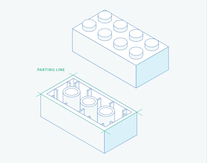

Vertical Parting Lines
Vertical parting lines are the most basic type and the most popular type. When the mold is machined, the vertical parting line is perpendicular to the direction in which the mold opens. Consider the example of a Lego block, a part that’s injection molded. The vertical parting lines are along the outside edges.
These injection-molded Lego blocks use molds with vertical parting lines.
