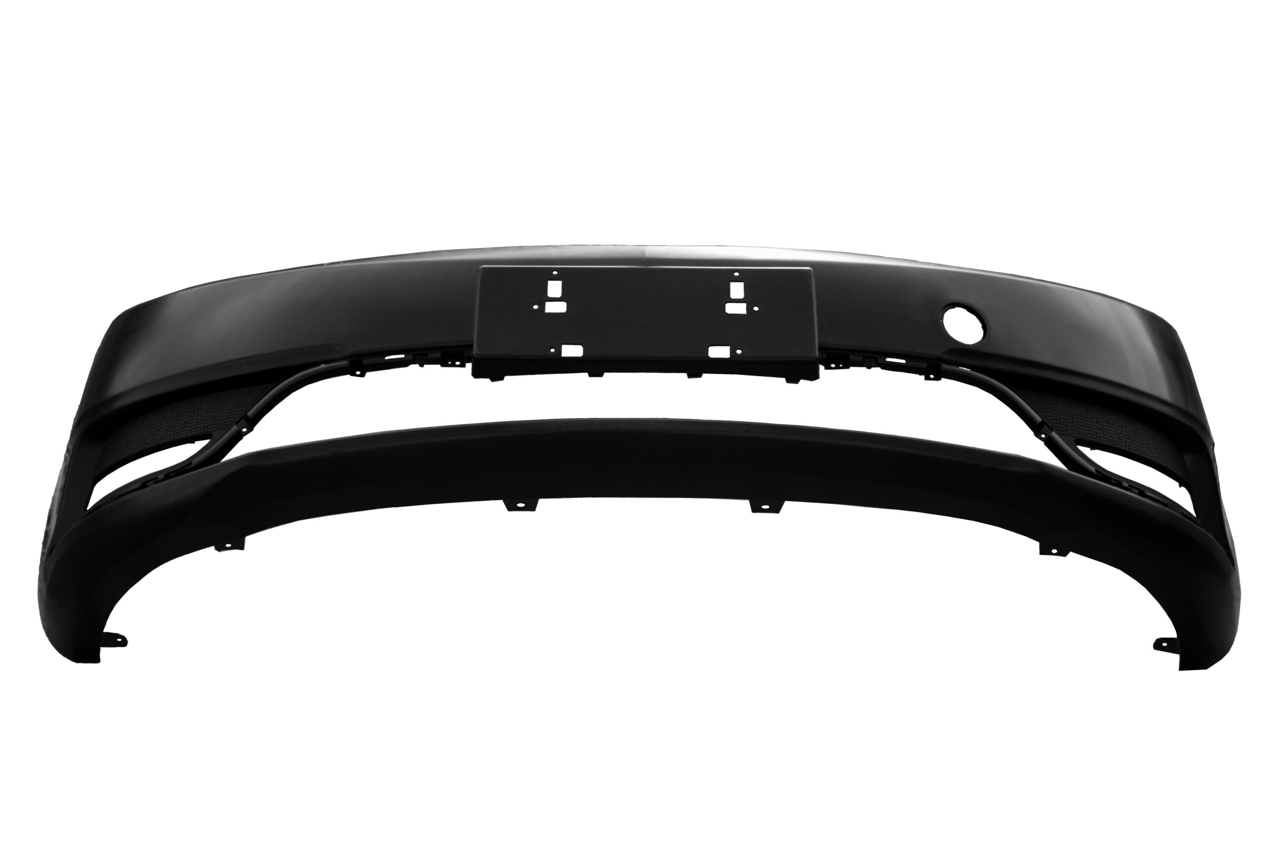

Avoid Large Unsupported Flat Areas
Large, flat plastic panels are prone to warping, waviness, and oil-canning. Shallow curvature, rib networks, perimeter flanges, and edge returns can improve stiffness and lower cosmetic sensitivity. Flatness tolerances should be realistic, especially across larger spans.
injection-molded plastic car bumper
Injection-molded plastic car bumper

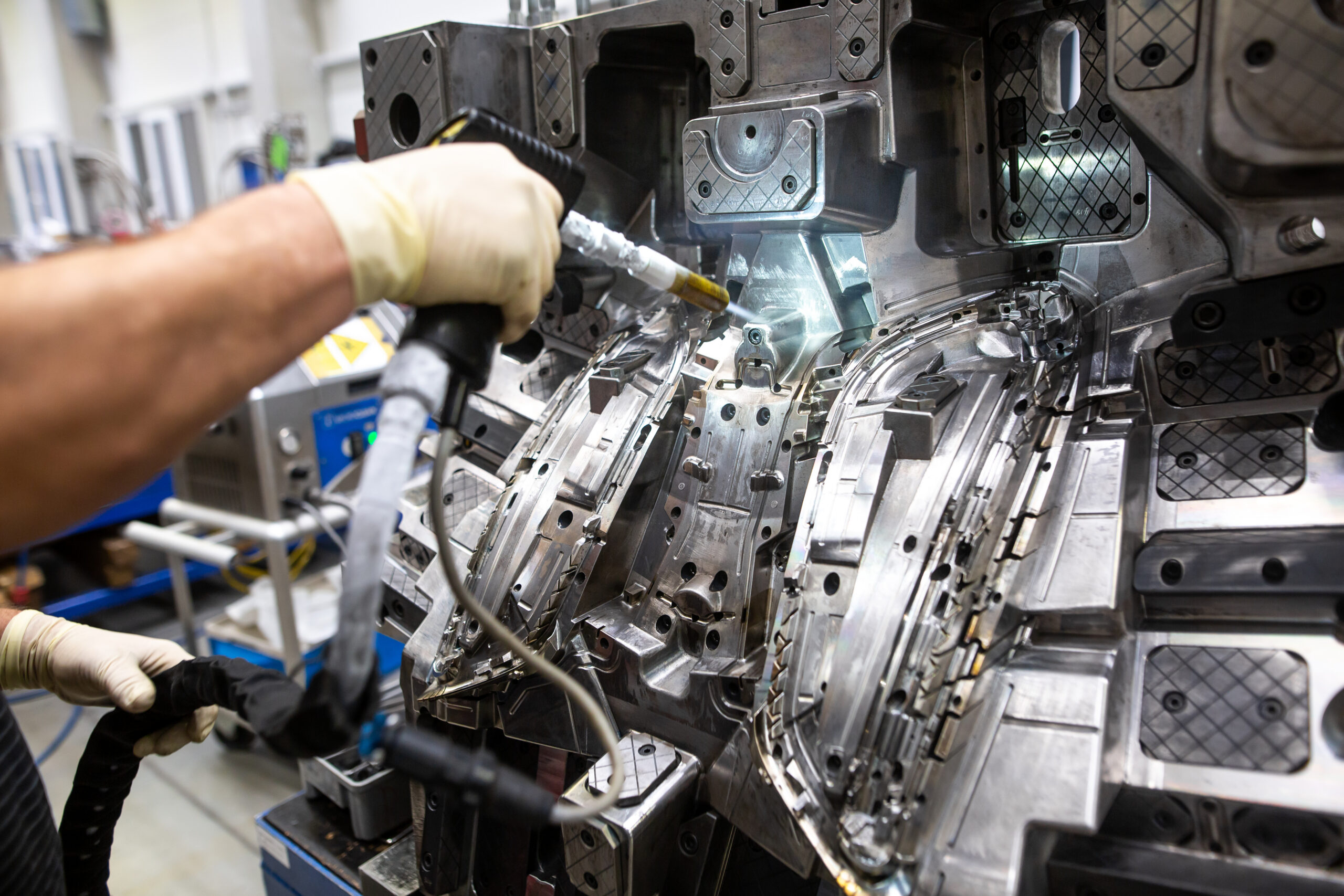

Tooling Material Selection for Large Molds
Tooling construction drives cost, lead time, mold life, thermal performance, repairability, and suitability for abrasive resins.
  • Aluminum tooling grades such as QC-10 or Alumold can be useful for bridge tooling and low/medium-volume large parts. Both materials machine quickly and dissipate heat well, but have shorter tool life and are unsuitable for abrasive glass-filled materials. A lower-cost 7075-series aluminum may well suffice for a small number of prototypes.
  • P20 pre-hardened steel is a common production mold material because of its moderate cost and durability, machinability, and repairability. It is often suitable for mid- to high-volume production, but performs poorly with aggressive materials.
  • H13 post-hardened steel is used for high-volume, abrasive materials, or extended operational life. It costs more and is harder to modify, so it is suited to mature part design.
Large molds also create logistical issues. They may require heavy-lift handling, specialized freight, longer setup time, and suppliers with suitable maintenance systems and tool-trial capacity.
