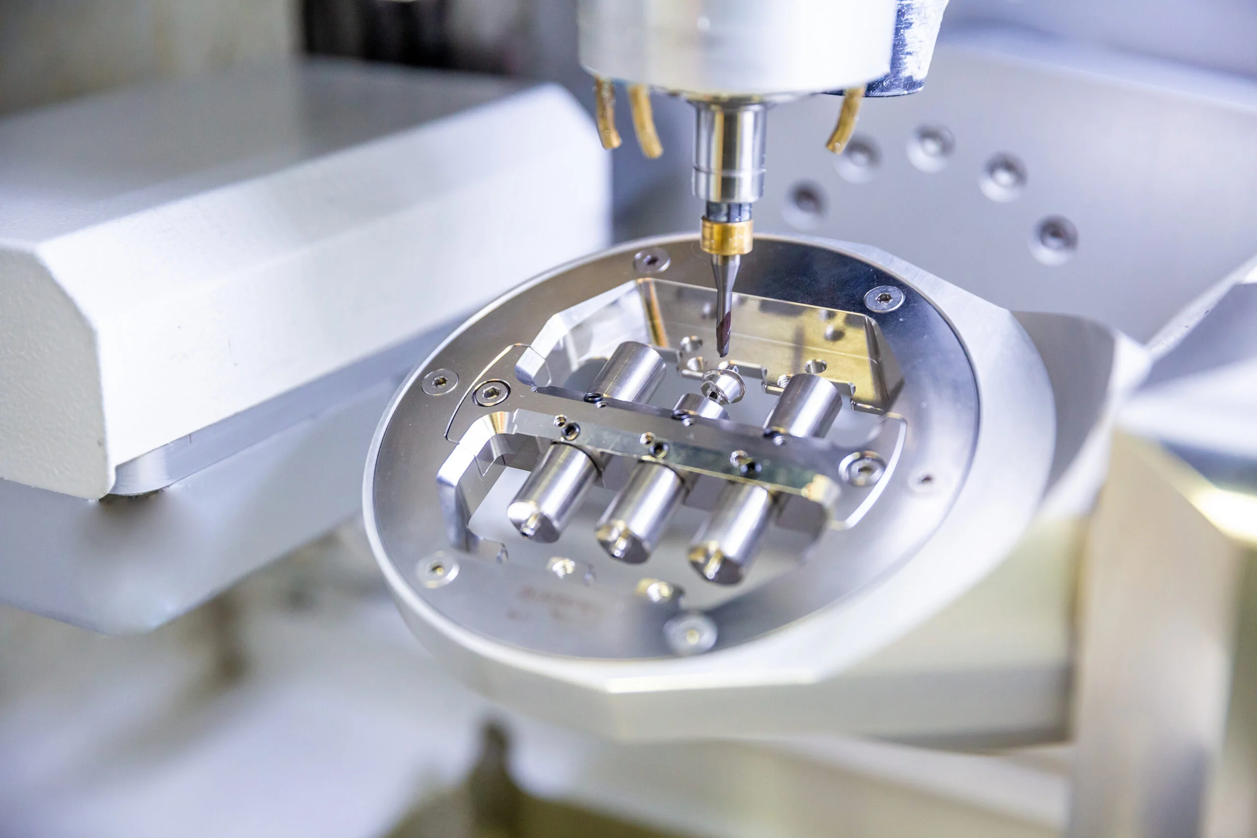

Machining of a titanium medical implant component

Medical CNC components are commonly cut from titanium, stainless steel, PEEK, acetal, and PTFE. The mechanical requirements and operating environment drive most material decisions, but medical work adds its own material demands: biocompatibility, sterilization, corrosion resistance, cleaning, and traceability all factor in.
Titanium
For titanium machining, Ti-6Al-4V Grade 5 is the go-to alloy whenever high specific strength, corrosion resistance, and biocompatibility outweigh cost. Grade 23 (Ti-6Al-4V ELI) is chemically the same alloy as standard Ti-6Al-4V, but with tighter limits on interstitial elements. Grade 2, on the other hand, is commercially pure titanium, a different material entirely. These grades are simply not interchangeable, and must be selected carefully.
Grade 23 ELI is typically reserved for implant applications, while Grade 5 covers structural and instrument components that will not remain implanted. Titanium’s low thermal conductivity makes it hard to machine, since heat concentrates around the cutting zone instead of dissipating through the part. Tooling choice, cutting parameters, coolant delivery, and toolpath strategy all shape tool life and the final surface condition.

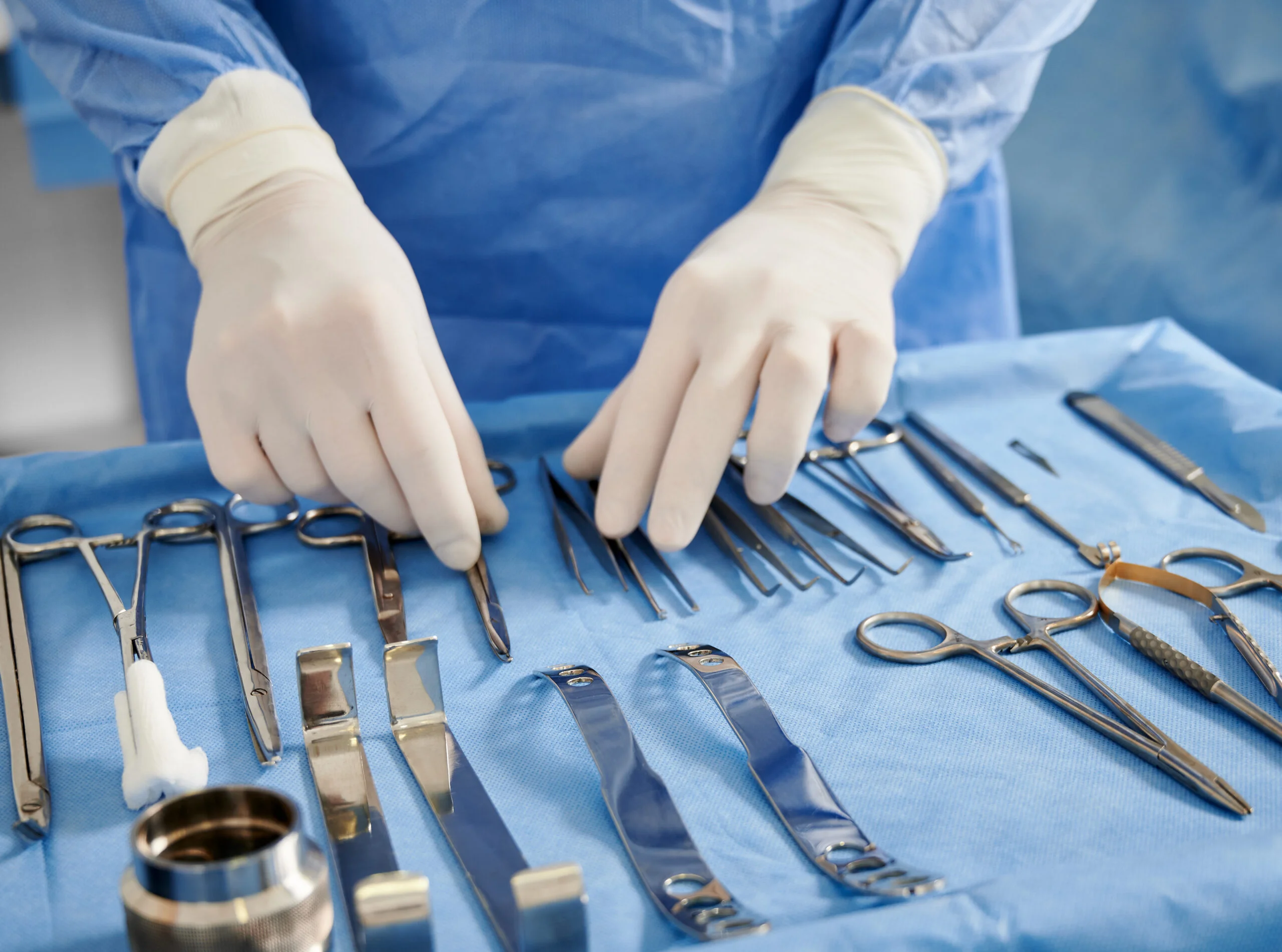

Titanium color anodizing gives surgical instruments identification without meaningfully changing dimensions. This process falls under SAE AMS 2488, not the aluminum anodizing spec (MIL-A-8625). Hard anodizing (MIL-A-8625 Type III) adds wear resistance to non-implantable aluminum parts, with a coating thick enough to matter for tolerance stacks.
Drawings should call out the specific anodizing process rather than a generic “anodize” note. Coating thickness and dimensional growth matter for precision fits, threads, and mating surfaces, and need to be factored into the tolerance stack.
Finished dimensions aren’t independent of surface processing. Electropolishing removes native material, anodizing adds an oxide layer, and aggressive polishing can wear down edges and fine features unevenly. Where any of these effects are significant relative to the tolerance, the drawing and process plan need to distinguish the as-machined condition from the final acceptance condition.

Machined metal surgical instruments
Machined surgical instruments
