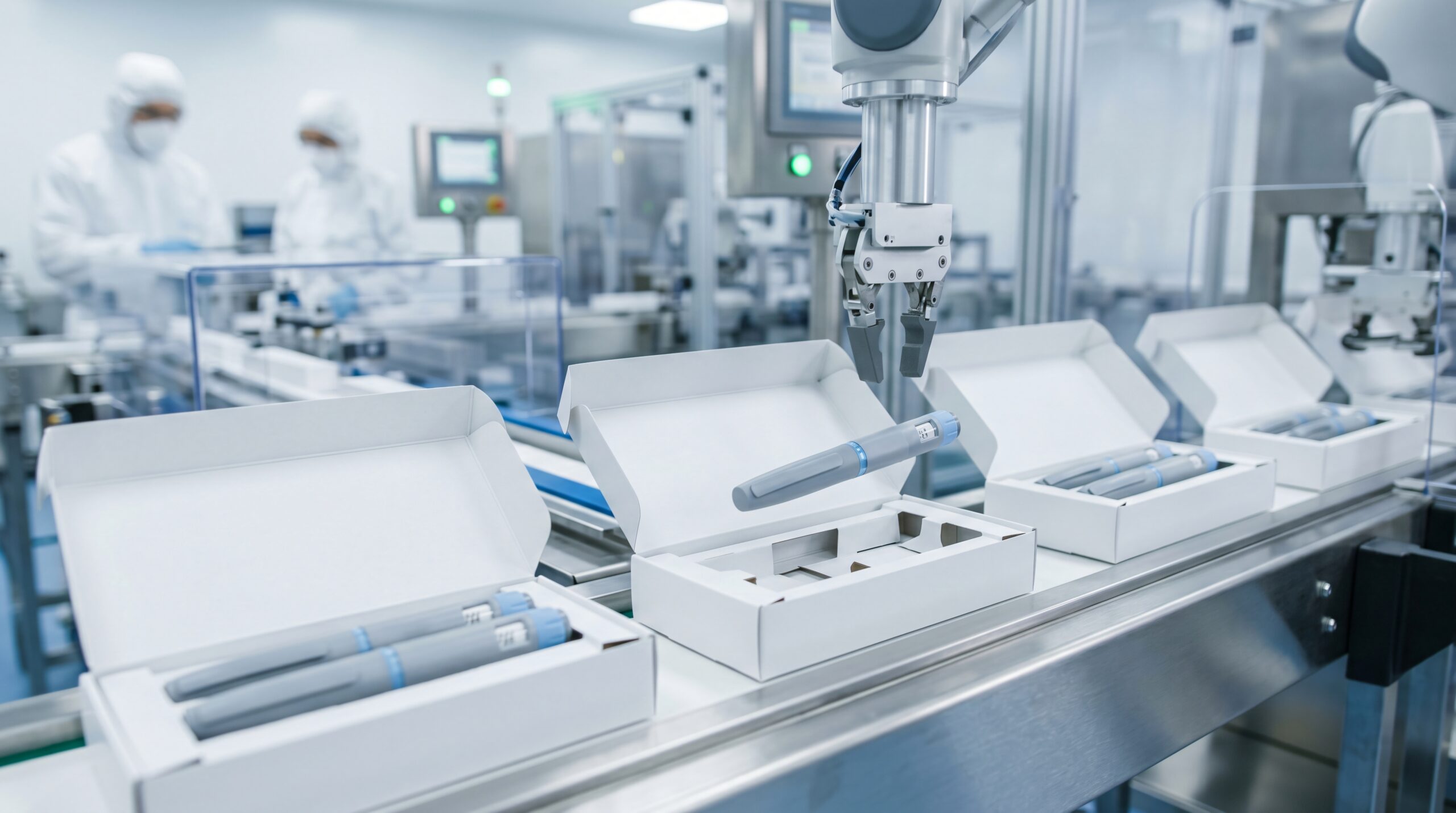

Do They Have Appropriate Cleanroom Capability?
Many components require manufacturing or final assembly in a controlled environment, not just sterilization at the end. ISO 14644-1 classification typically ranges from Class 5 to Class 8 for medical work, driven by device risk and contact type. Requirements aren’t all-or-nothing—some programs need the full process to be controlled, others just require final assembly or packaging. Request:
  • Current room classification certificate
  • Particulate and bioburden monitoring logs
  • Gowning and personnel protocols
A supplier who says they “have a cleanroom” without classification records may not have the class or scope your device needs.
