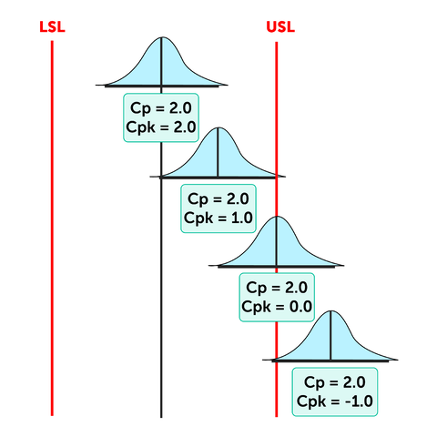

Cpk and Ppk are not interchangeable. Cpk measures process capability relative to the process mean using short-term variation—it answers whether the process could hold the tolerance if it were centered. Ppk measures overall performance, including mean shifts over time—it’s closer to what a customer will actually see. Both matter in a pilot validation.
For most production applications, a minimum Cpk of 1.33 is the accepted threshold. For safety-critical characteristics—anything that affects product safety, regulatory compliance, or field failure risk—1.67 is the appropriate target. A single FAI measurement tells you what one part looked like; Cpk tells you whether the process that made it is capable of doing that repeatedly.
Identify your critical characteristics and key characteristics before the pilot runs and measure each one across the full pilot quantity. Any characteristic below threshold is a corrective action, not a judgment call.
