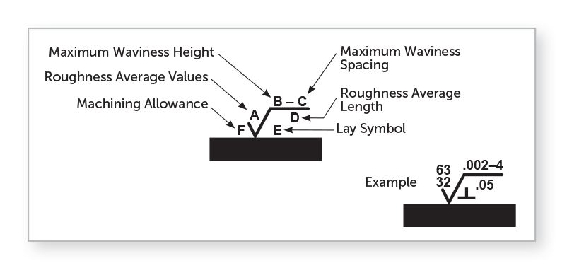

Technical diagram of surface finish tolerances with labels A–F, showing maximum waviness height/spacing, roughness values, machining allowance, lay symbol, and an example on a surface block.

Surface Roughness (Ra) Reference
Common surface finish specifications and their applications
