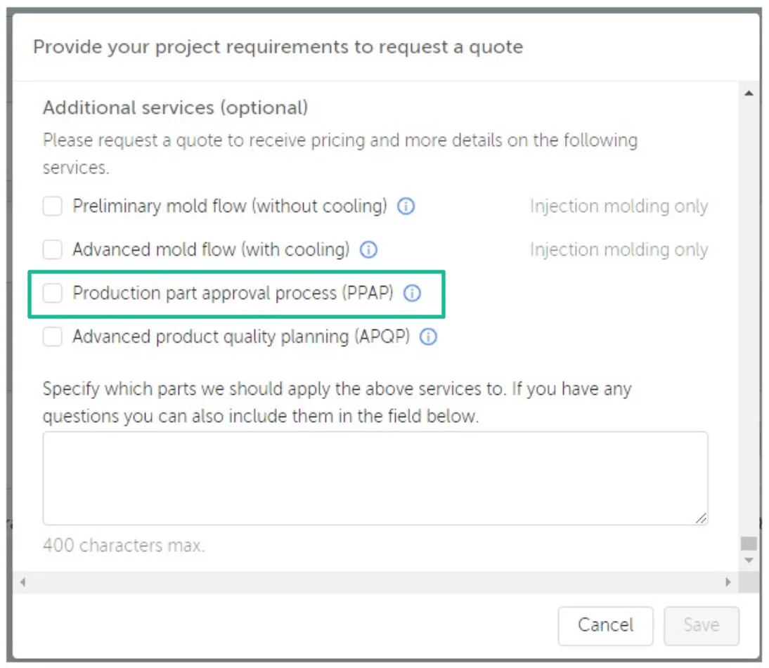

You can specify PPAP when you request a quote from Fictiv. An additional fee applies.

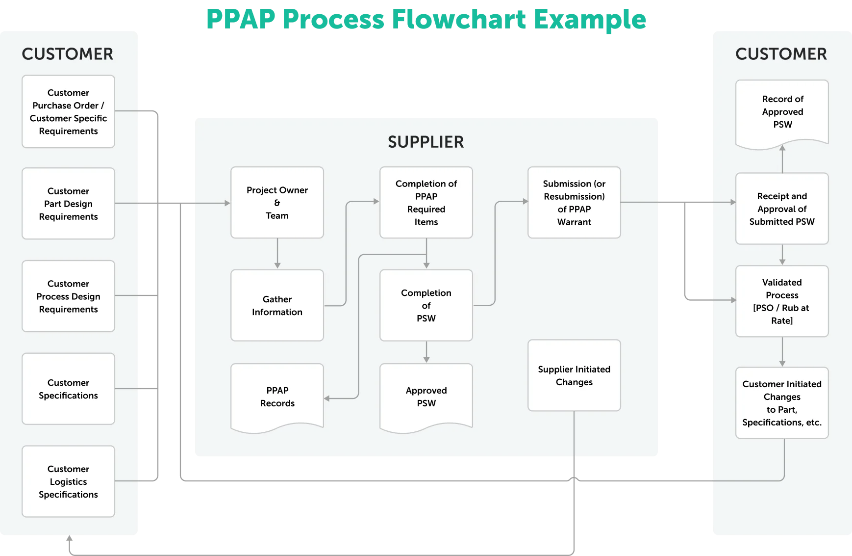

The PPAP Process: Step-by-Step Breakdown
The PPAP process is designed to systematically validate that a supplier is capable of producing a part that meets the specified design and quality requirements. The process consists of several key stages, each involving specific documentation and testing.
Here’s a breakdown of the typical steps involved:
Part Submission and Initial Review
The supplier submits the part for review, along with necessary documentation such as engineering drawings, material certifications, and process flow diagrams. The OEM then reviews the submission and confirms that the part matches the design dimensional requirements and design specifications. Next, if any discrepancies or issues are found, the supplier is required to make corrections before proceeding further.
Design and Process Validation
Design validation ensures that the part meets all functional, performance, and regulatory requirements as outlined in the design specifications. The prototype is used to design the process to ensure that the process meets all requirements.
The next step is process validation. This involves confirming that the manufacturing process can produce pilot parts that meet the design requirements consistently and reliably. This step may include pilot runs or “initial production runs” to evaluate process stability.
The next step is to conduct testing and inspection, such as capability studies (e.g., CpK analysis), to demonstrate that the process is capable of producing parts within acceptable tolerances.
Production Trial Runs
A trial production run is performed to simulate actual production conditions. During this stage, parts are produced in larger quantities to test the scalability of the manufacturing process. The goal is to validate the consistency of production output, identify any issues that could arise during full-scale production, and ensure the parts meet all quality standards.
Part Approval or Rejection
Based on the results of the design and process validations, the part is either approved for mass production or sent back to the supplier or project team for further improvement. If the part is approved, a Part Approval Certificate is issued, signifying that the part is ready for large-scale production.
Following a process like this example is necessary, but creating a flowchart is not a PPAP requirement.
