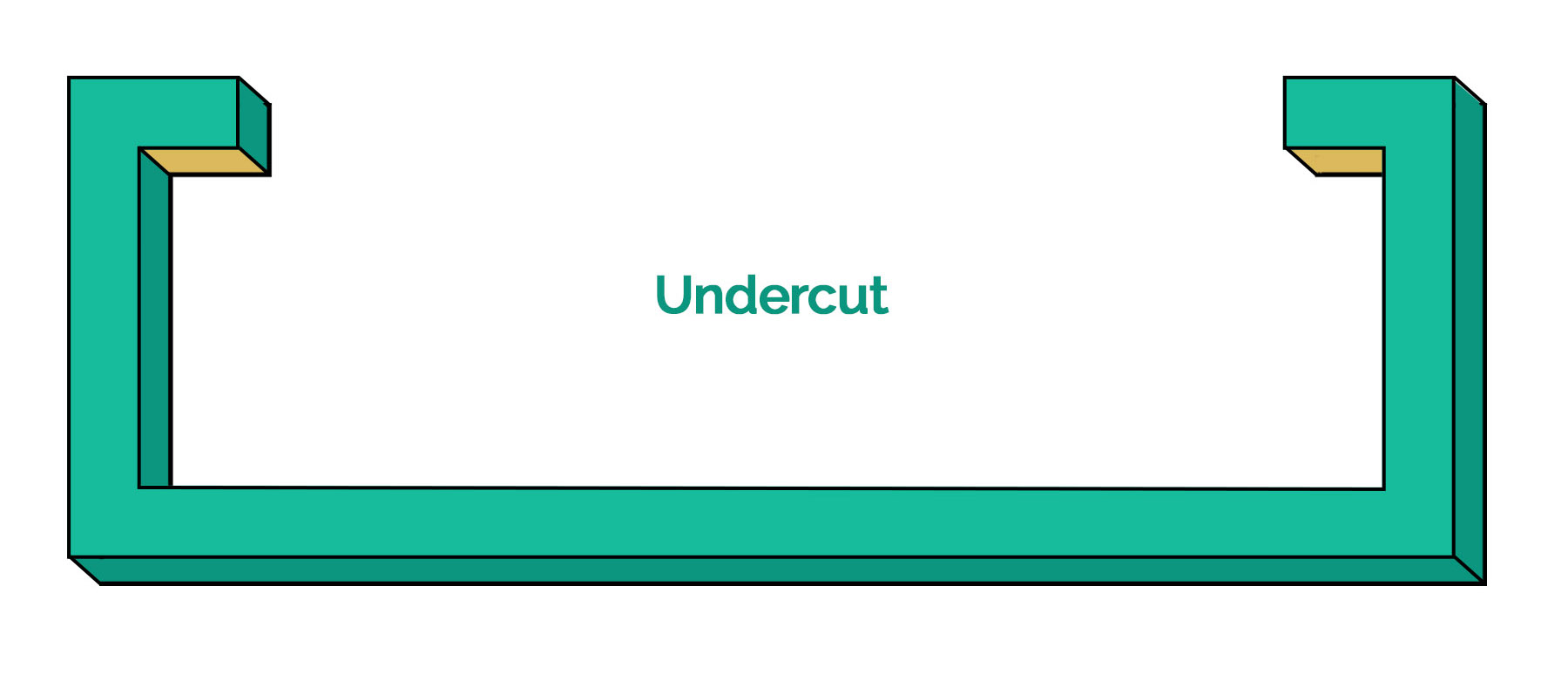

Undercut
In manufacturing, an undercut is a recessed or overhanging feature that obstructs direct tooling access.
  • In CNC machining, it refers to a recess, groove, or overhang that cannot be reached with a standard end mill in a single toolpath or setup because it’s located beneath or behind another surface.
  • In injection molding and casting, undercuts are features of a part that prevent it from being ejected directly from the mold or die in the open-shut direction.
There are various solutions to undercuts, although they may increase manufacturing cost and complexity:
  • Multi-axis machining, or specialized cutters, such as T-slot, dovetail, or lollipop tools.
  • Injection molding tools can include slides, lifters, collapsible cores, or split molds.
Undercut example

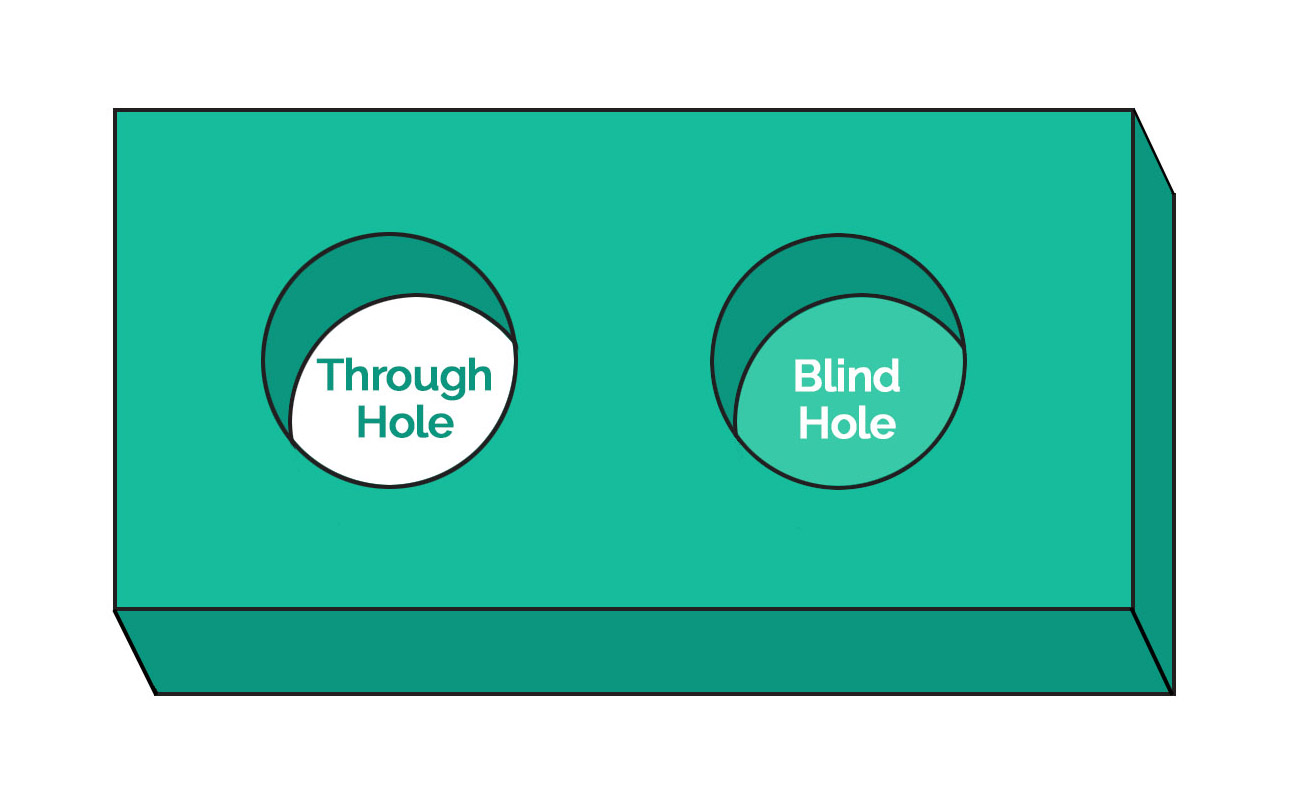

Through Hole / Blind Hole
Through holes refer to holes that are drilled, reamed, milled, or otherwise created that go completely through a substrate. Essentially, a through-hole is a hole that goes all the way through a material.
For comparison, a blind hole does not go all the way through a substrate and leaves a recessed surface. Both types of holes can be tapped to add threads for screws.
Through hole and blind hole

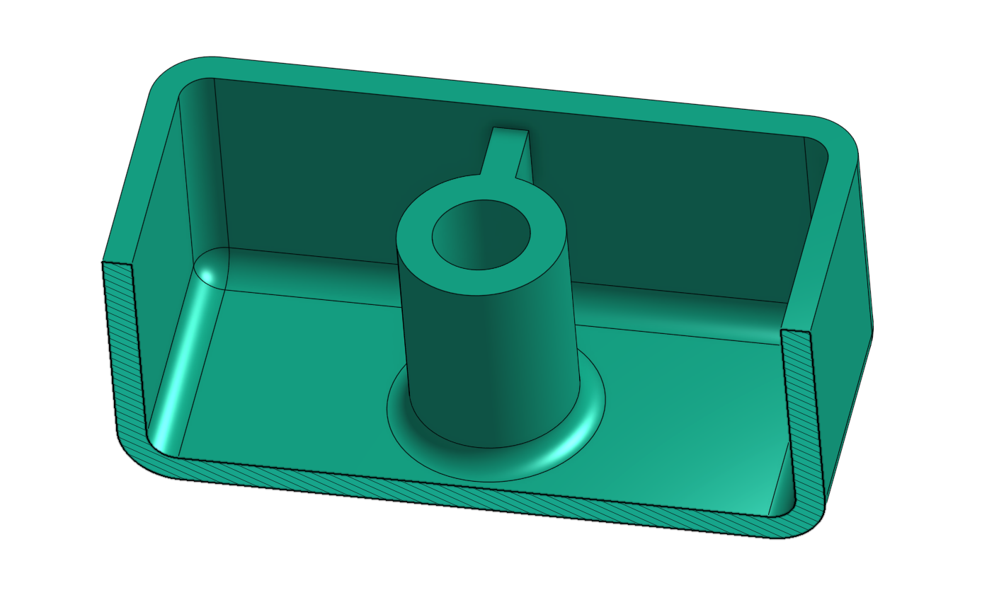

Boss
In manufacturing, a boss is a raised protrusion, typically cylindrical or conical. A boss often has a hole in the center, serving as a receptacle for fasteners to facilitate assembly.
Ribs
Ribs are protrusions like bosses, but thinner and longer. They are typically used more in additive processes to increase strength with minimal material thickness.
Core-Out
Coring out a part means shelling or removing internal material. For additive and molding processes, this reduces material and cost. For subtractive processes like machining, it can add cost, as more of the stock material must be removed.
A boss and rib inside a cored-out part
A boss and rib inside a cored out part

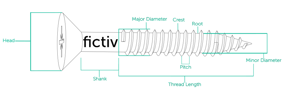

Threads
Threading is the process of creating a screw thread. More screw threads are produced each year than any other machine element in the world. There are many methods of generating threads, including subtractive methods (such as various thread-cutting and grinding techniques), formative methods (such as rolling and forming), molding and casting, additive methods (such as 3D printing), or combinations thereof.
Thread Terminology
Thread Terminology
