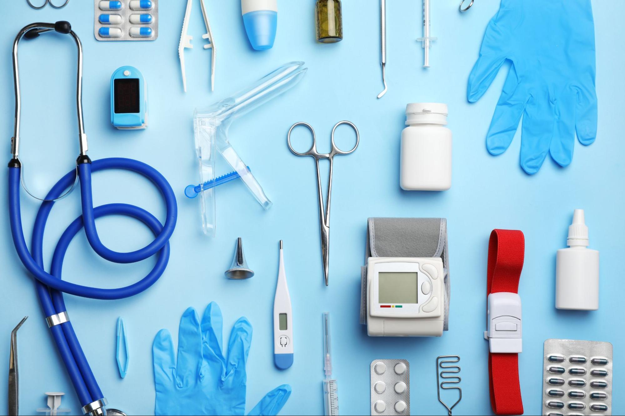

Medical devices use a variety of materials that meet specific regulatory standards.

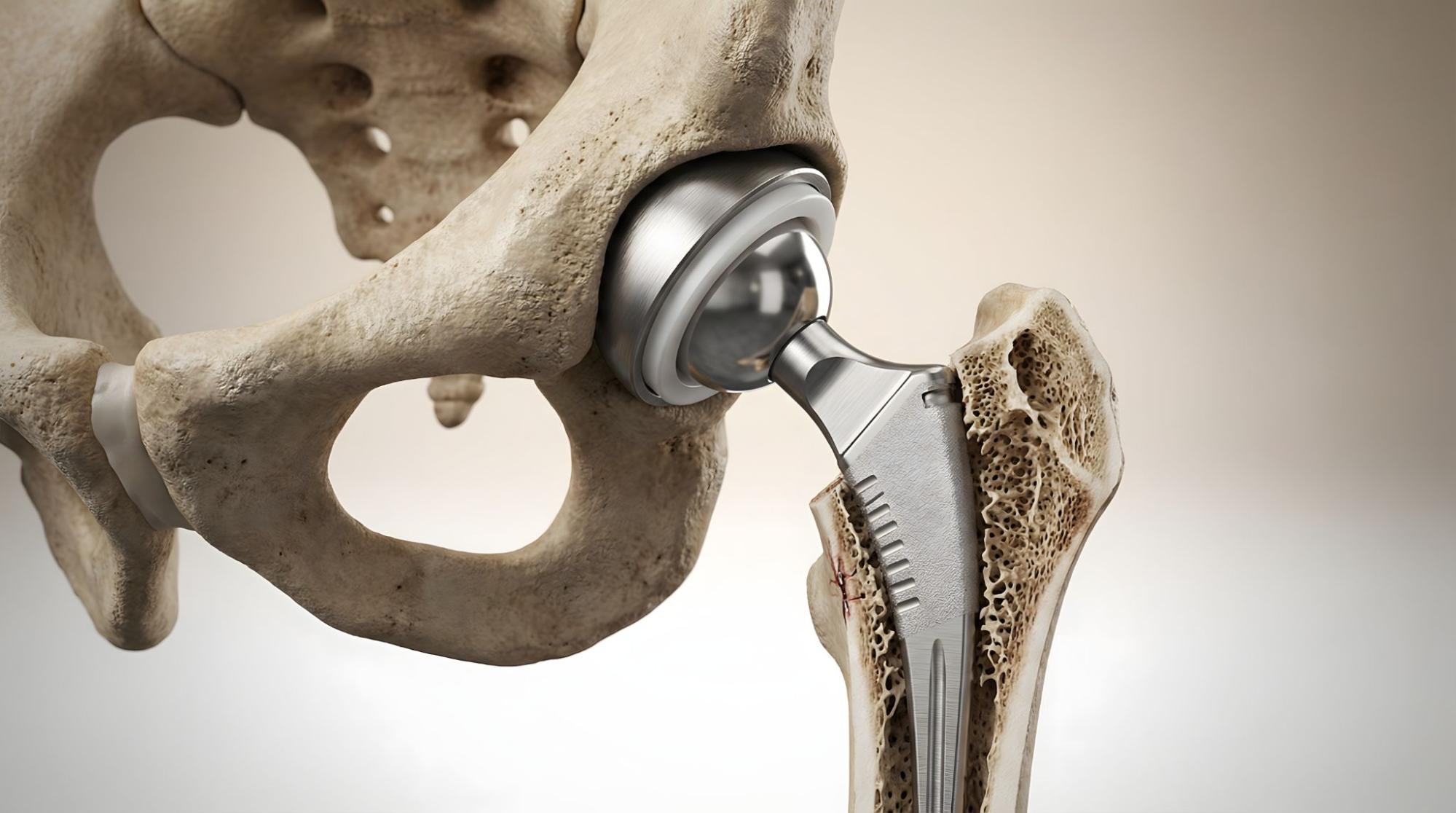

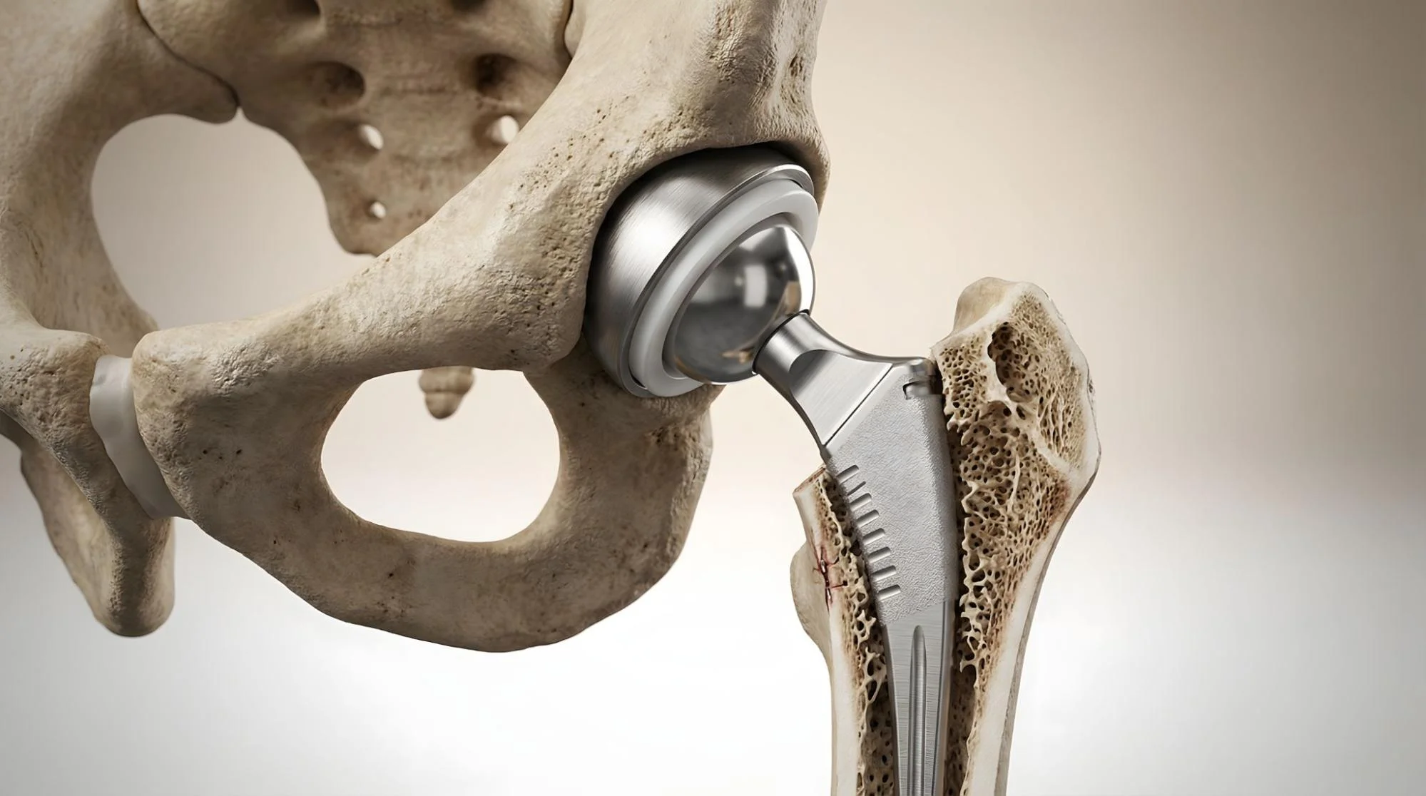

Prosthetic hip joint highlighting metal and plastic materials.

Cobalt-Chrome (CoCr)
Cobalt-chrome alloys offer superior wear resistance.
  • Key properties: Very high hardness, exceptional wear resistance, long fatigue life
  • Common uses: Joint replacements, orthopedic implants, dental prosthetics
  • Sterilization compatibility: Compatible with steam autoclave, EtO, and radiation sterilization
  • Manufacturing compatibility: CNC machining, casting, additive manufacturing
