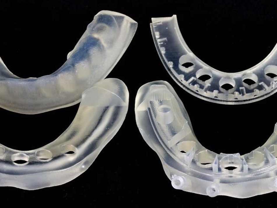

3D printing can produce virtually unlimited geometries, which is great for rapid iteration of complex designs. Of the 3D printing materials that Fictiv offers, VeroClear and Nylon are USP Class VI certified. In particular, VeroClear is used for quick-turn dental and orthopedic surgical guides.
![VisiClear dental surgery drill guides](https://www.fictiv.com/wp-content/uploads/2020/07/visijet-dental-1.jpg)
Both VeroClear and Nylon are printed in high resolution, which is often required for small medical device prototypes.

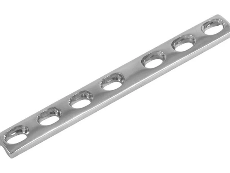

CNC machining can also produce parts in biocompatible metals. There are three common implant grade choices:
- Stainless Steel 316L
- Titanium Grade 5, also known as Ti6Al4V or Ti 6-4
- Cobalt-Chrome (CoCr)
![CNC machined SS316L bone plate](https://www.fictiv.com/wp-content/uploads/2020/07/bone-plate.jpg)
Stainless Steel 316L is the most commonly available material out of the three. Titanium has better weight-to-strength ratio, but it is significantly more expensive. CoCr is mostly used for orthopedic implants. We recommend that you prototype with SS 316L while the design is being refined, then move onto the more expensive materials when the design is more mature.

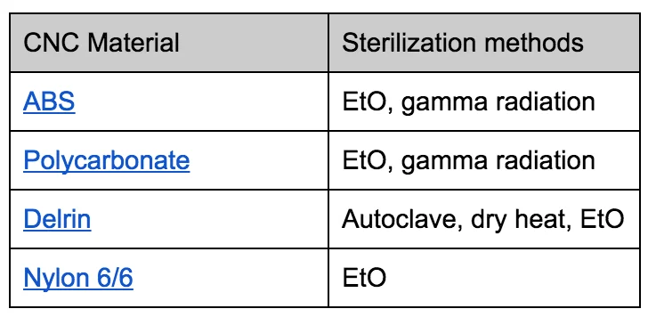

Chemicals and irradiation are the preferred methods of sterilizing plastics, because heat can break down plastics. Here is a chart that outlines many plastics’ compatibility with different sterilization methods. Autoclave and dry heat is more common for sterilizing metals.
All of the USP Class VI certified materials we mentioned previously are sterilizable, as are the implant-grade metals.
In addition, Fictiv offers two 3D printed materials that are sterilizable by Ethylene oxide (EtO) treatment and gamma radiation:
Again, CNC machining provides the most amount of choice for sterilizable materials.
![Sterilizable CNC materials](https://www.fictiv.com/wp-content/uploads/2020/07/medical-device-prototyping.png)
If the medical device is intended for patients to sterilize at home, the material should also be compatible with disinfectant chemicals, such as bleach, ethanol, isopropyl alcohol, iodine, and hydrogen peroxide. ABS and Delrin are the most chemically resistant plastics Fictiv offers.
