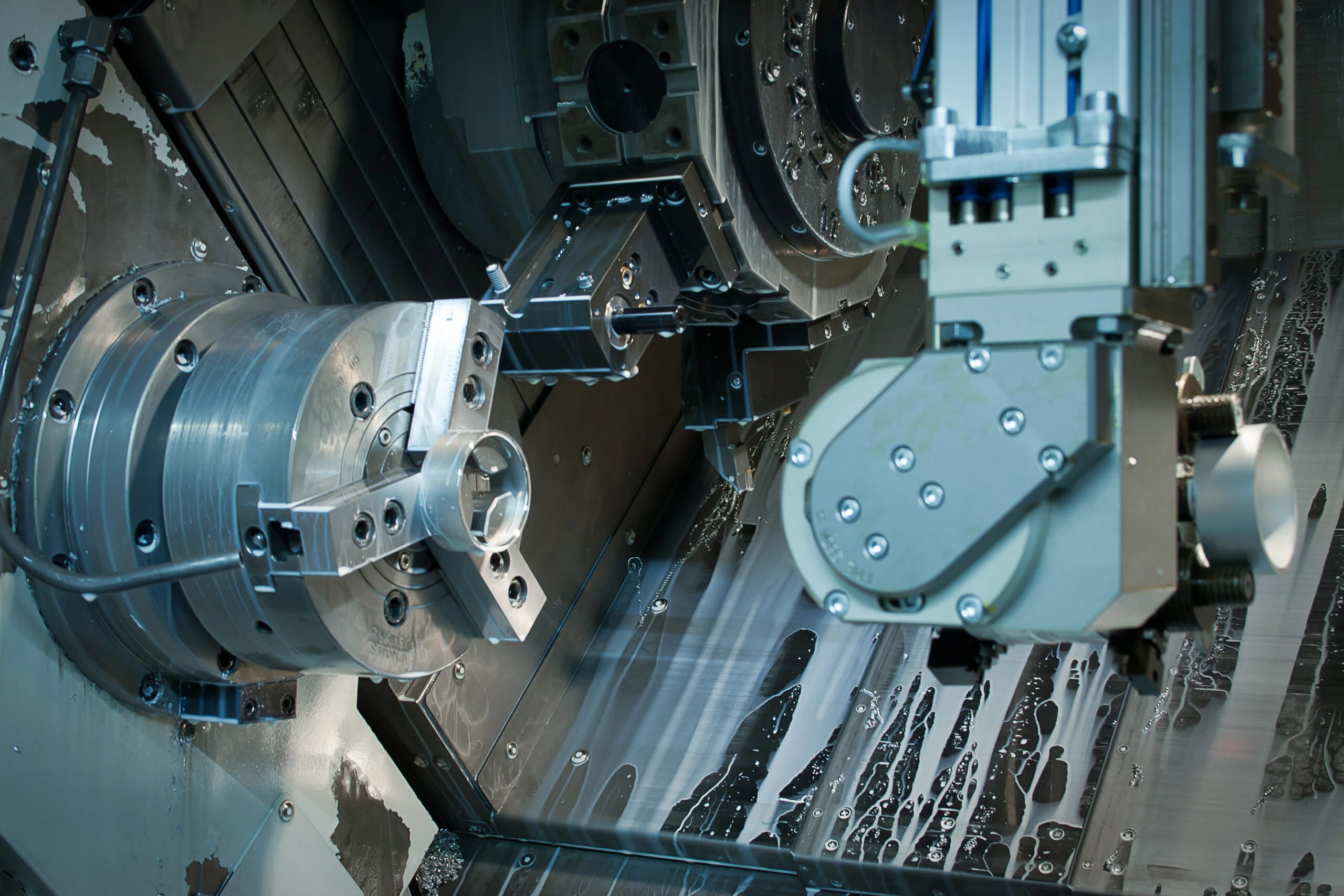

Turn-Mill and Mill-Turn Centers (Multitasking Machines)
Turn-mill and mill-turn machining are terms that are sometimes used interchangeably by machine builders. Although turn-mill may commonly refer to a turning-focused platform with milling capability, while mill-turn refers to a milling-focused platform with turning capability.
A turn-mill center combines a CNC turning platform (rotating workpiece, non-rotating tool) with milling capability (rotating tool, fixed or live workpiece) in a single machine. In either case, a part can be turned, milled, drilled, and threaded in one setup, eliminating the transfer, re-fixturing, and datum re-establishment that multiple setups require.
Typical turn-mill platforms are described as 5-axis, 6-axis, or 9-axis depending on the combination of linear (X/Y/Z), rotary (C-axis on the spindle, B-axis on the turret), and sub-spindle axes. Complex rotational parts with off-axis features such as cross-holes, flats, milled slots, and eccentric turned diameters benefit most, particularly parts requiring high concentricity between turned and milled features.
Turn-mill centers can run in two modes. Bar-fed operations machine parts from continuous stock and suit smaller-diameter rotational parts in volume production, while chuck work loads individual blanks or near-net-shape preforms for larger or more complex geometries. This choice affects maximum part diameter, material form, and setup time, so confirm which mode your part suits before specifying turn-mill. Large-diameter parts with no viable bar-feed path are often better served by separate turning and milling operations.
Parts designed for turn-mill should make full use of the advantages of the single-setup capability, locating all critical datums on the same surface that the tooling holds, minimize features requiring extensive C-axis indexing or deep backwork. The sub-spindle is also less powerful than the main spindle, limiting heavy backwork removal. Group similar operations, minimize indexing events, and consider relocating or eliminating features that push the machine beyond its efficient operating range.
9-Axis and 12-Axis CNC Configurations
The nine axes comprise the primary spindle C-axis, the sub-spindle C-axis, two turrets, each with X/Z linear and Y axes, and the live tooling B-axis. The axis count is additive across multiple spindles and axes in a cell, not nine independent axes on a single cutting head. This enables complete machining of complex rotational parts, including backworking, in a single clamping operation.
A 12-axis configuration is typically a multi-axis turn-mill with additional synchronized machining capability, or a dual-turret platform with extended live tooling axes. It is common in high-precision, high-volume production of complex small parts such as medical implants, fuel system components, and precision fasteners. The practical benefit is primarily cycle time, datum consistency, and work-in-process reduction.

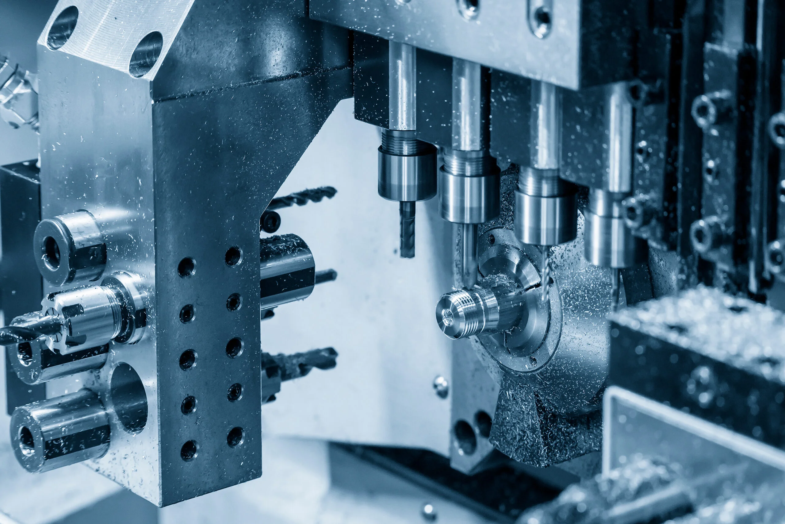

Swiss-Type CNC Turning
The defining feature of a Swiss-type CNC turning machine is the presence of a guide bushing positioned very close to the cutting zone. The guide bushing minimizes the length of unsupported bar stock being worked, which reduces deflection and vibration in the workpiece, enabling the Swiss machining process to hold tight tolerances on parts with high length-to-diameter ratios.
Live tooling on multiple axes enables cross-drilling, cross-milling, slotting, and threading to be performed in the same cycle. Many modern Swiss machines have a second spindle that holds the part before it’s cut free, so the back end can be machined precisely as well.
Swiss-type machining is the process of choice for small-diameter parts, typically under 32 mm, with high length-to-diameter ratios and demanding tolerance requirements. Typical applications include bone screws and orthopedic implants in the medical field, fuel injector components in the aerospace and automotive industries, precision shaft assemblies, watch components, and medical tubing connectors.
To leverage the full potential of the Swiss process, parts should be designed for a single feed-through cycle. Features that require the part to be removed from the guide bushing and re-chucked add significant setup cost and should be avoided.
Multi-tasking Swiss-type CNC turning
Multi tasking Swiss type CNC turning
