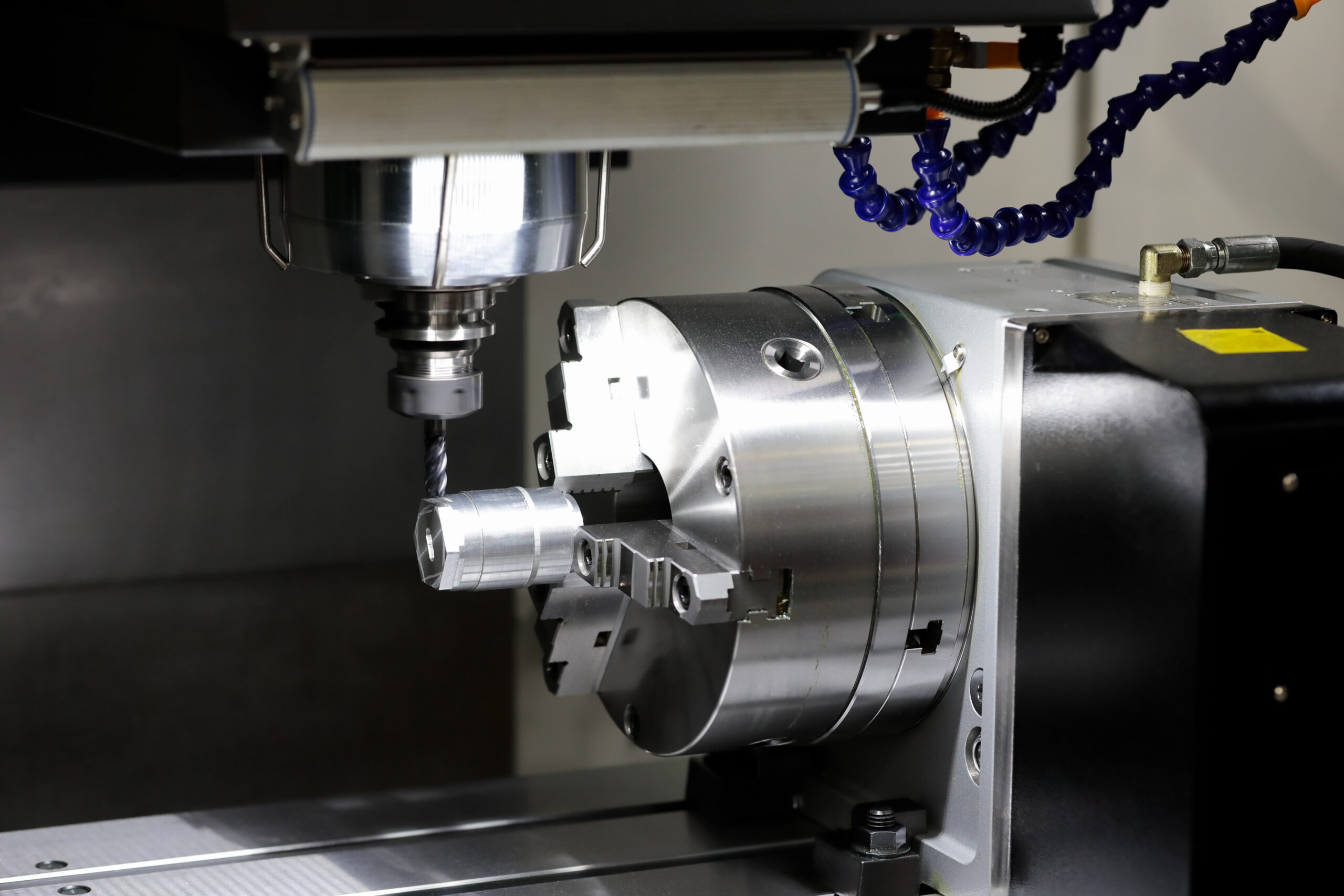

How 4-Axis CNC Machining Works
In a standard 4-axis setup, the workpiece is clamped in a rotary table or trunnion mounted on the machine bed. The CNC controller can rotate this table to a programmed angular position and either lock it in place before cutting or keep it in continuous motion while the spindle cuts.
Indexed 4-Axis Machining (3+1)
Indexed 4-axis machining, commonly referred to as 3+1 milling, treats the rotational axis as an indexer rather than a continuous cutting path. The machine uses the A-axis to rotate the workpiece to a predetermined angular position, engages a mechanical brake to rigidly lock the rotary table or trunnion, and then executes standard 3-axis linear toolpaths (X, Y, Z).
This is the most cost-effective configuration for complex, prismatic components with features distributed across multiple orthogonal or angular faces—including radial bolt patterns, off-axis cross-drilled fluid ports, and keyway flats on a shaft. By locking the rotational axis during heavy material removal, indexed machining maximizes setup rigidity, enabling deeper cuts and higher feed rates without the severe tool chatter an unbraked rotational axis would otherwise induce.
Continuous 4-Axis Machining
Continuous 4-axis milling keeps the A-axis interpolating in real time during the cut, coordinated with the X, Y, and Z axes simultaneously. This is required for geometry that wraps around the part, such as cam lobes, helical flutes, spiral grooves, and similar features where the tool must follow a path that continuously changes in both angle and position. However, it falls short in producing complex compound 3D contours, variable-pitch overlapping impellers, or undercuts that require a fifth tilting axis (B or C) to keep the tool normal to a sculpted surface.

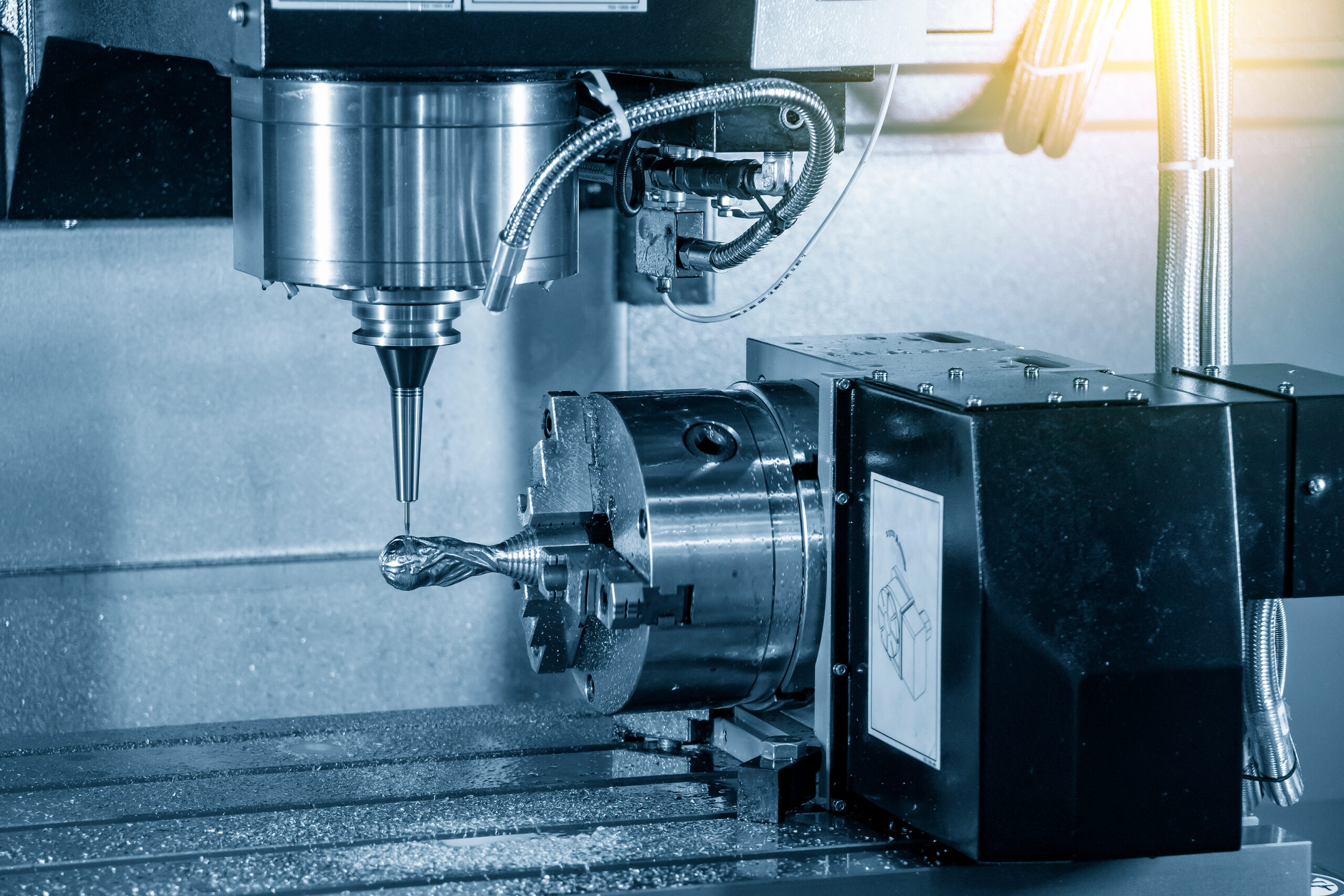

Machining complex geometry on a 4-Axis machine.

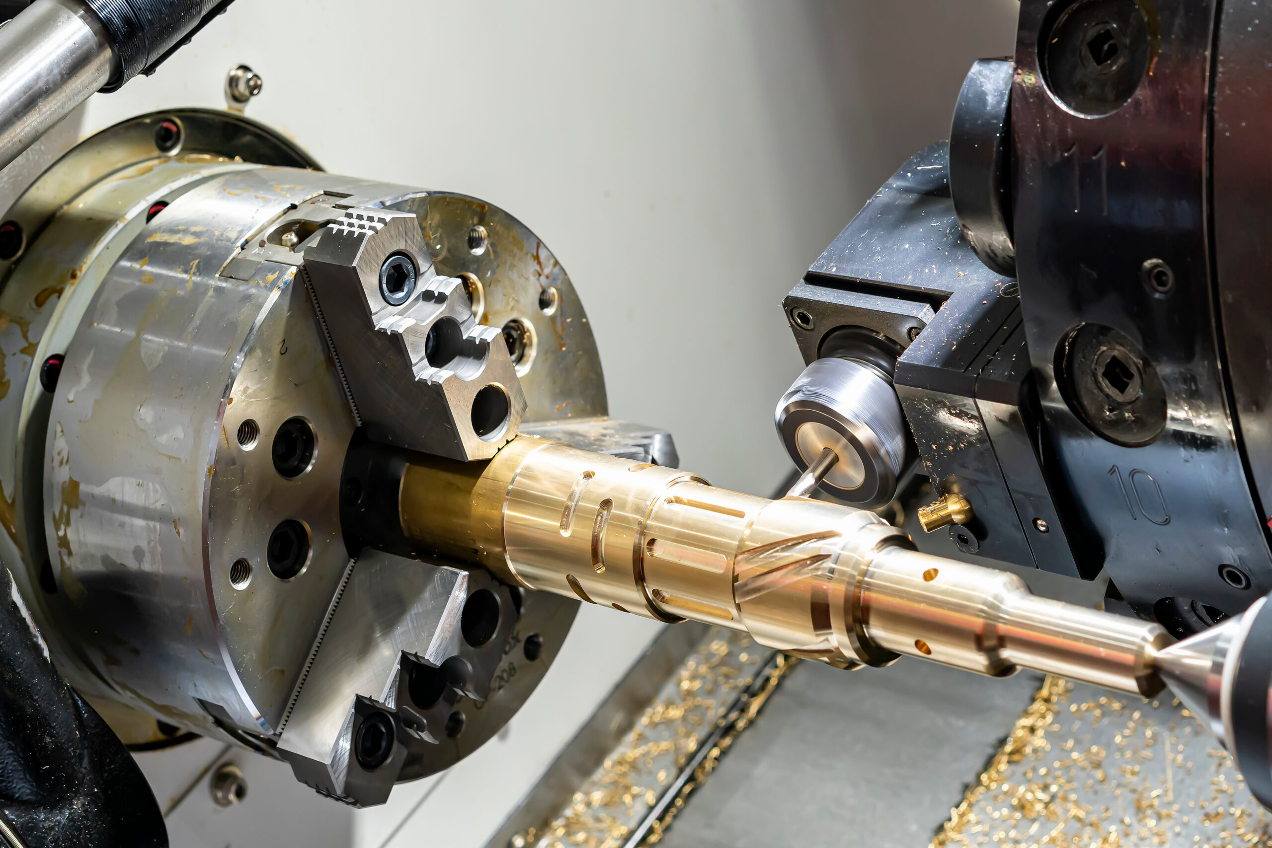

4-axis cnc machining a custom shaft
