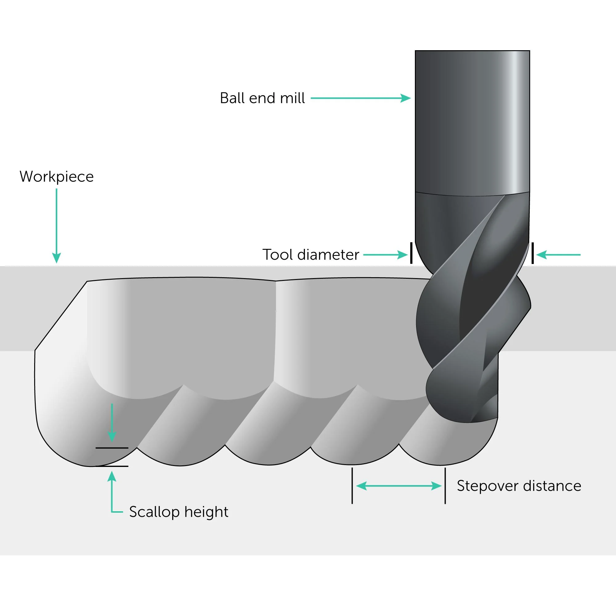

In CNC milling operations, the term “stepover” refers to the lateral distance between consecutive tool paths of a cutting implement. Typically, the recommended stepover distance is a percentage of the cutter’s diameter. A machinist can enter the calculated stepover dimension in computer-aided manufacturing (CAM) software or use a CNC stepover calculator in CAM. While an experienced machinist may be able to specify a CNC stepover based on previous projects, there is a simple stepover calculation to use with CNC milled parts.
Calculating Stepover CNC
Stepovers are typically given as a percentage of the tool diameter using the following formula.
Stepover = Tool Diameter x CNC Stepover Percentage

Smaller Stepovers
When a stepover is smaller, the distance between successive tool passes is less. This minimizes the height of the peaks and valleys left by the cutting tool, which results in a smoother surface finish. Because each pass of the tool overlaps more closely with the previous pass, there are fewer visible tool marks. Machining takes longer, however, and the speed of material reduction is less.
Smaller stepovers allow cutting tools to capture finer details and more complex part geometries. This is particularly important in finishing operations where the goal is to achieve both high precision and fine surface detail. To develop toolpath algorithms that can accurately and efficiently machine these intricate features, software developers and engineers must consider factors such as tool geometry, material properties, and machine capabilities.

Larger Stepovers
Larger stepovers have a greater distance between tool passes. The result is higher peaks and deeper valleys on the part’s surface, or a more noticeable wavy pattern, as larger stepovers also produce a rougher texture with more noticeable tool marks, which can affect the part’s visual and tactile qualities. More material is removed, however, and a larger stepover can be followed by a smaller one to smooth out the surface.

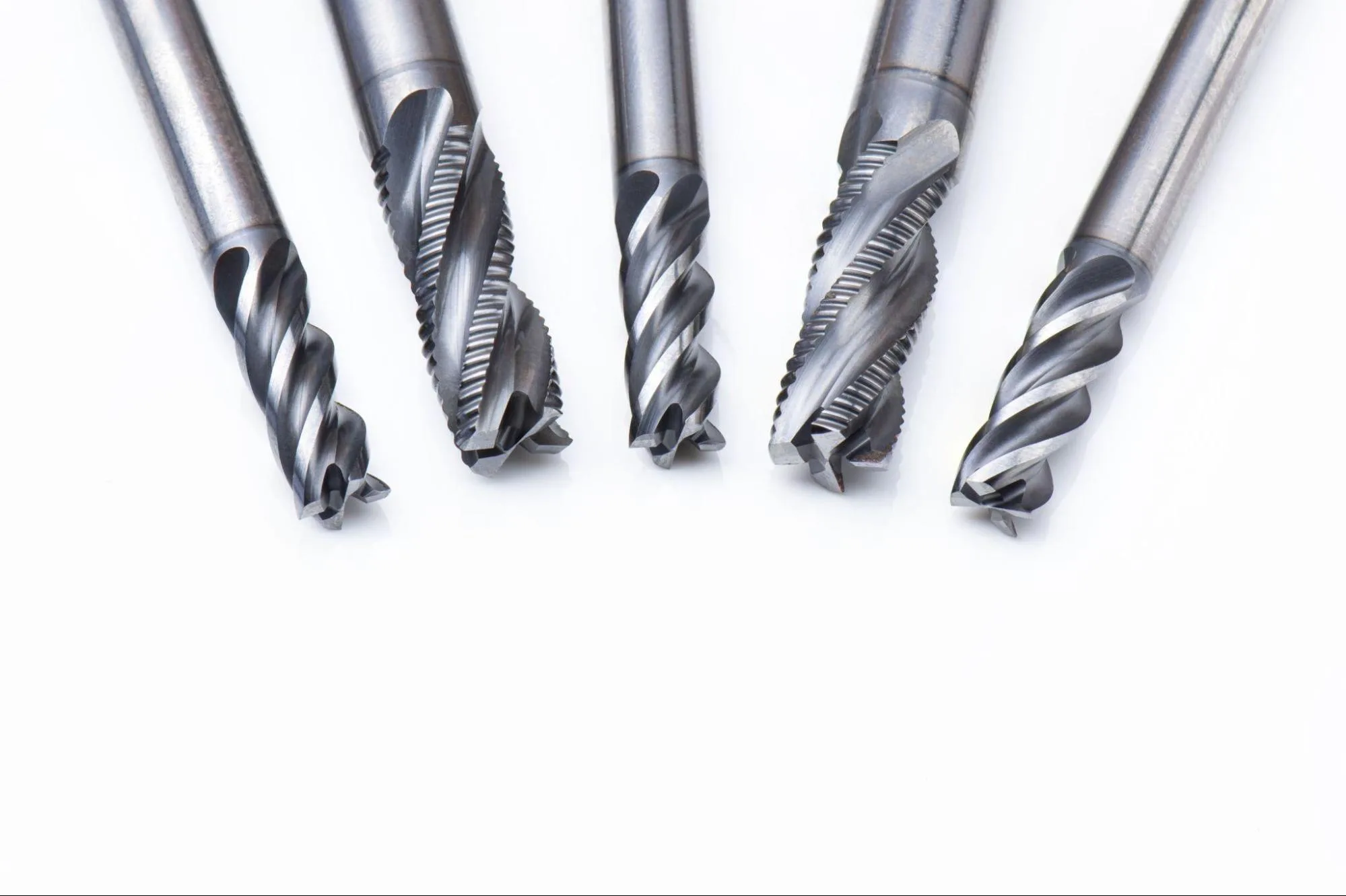

Tool Geometry
These commonly used end mills show the role of tool geometry in CNC stepovers.
- Flat end mills have a flat cutting surface. They can use a larger stepover for parts with flat surfaces but may need a smaller stepover in the corners of complex parts.
- Ball end mills have a spherical cutting surface for curved and complex parts. A ball end mill needs a smaller stepover because the cutting action occurs over just a part of the tool’s end. Additionally, when working on curved surfaces, the effective cutting diameter changes with the stepover, impacting both surface finish and machining time. It’s crucial to calculate the stepover carefully to avoid excessive scalloping or inefficient machining, especially in finishing operations.
- Bull nose end mills have a flat cutting surface with round corners. They can use a larger stepover on flat surfaces.
