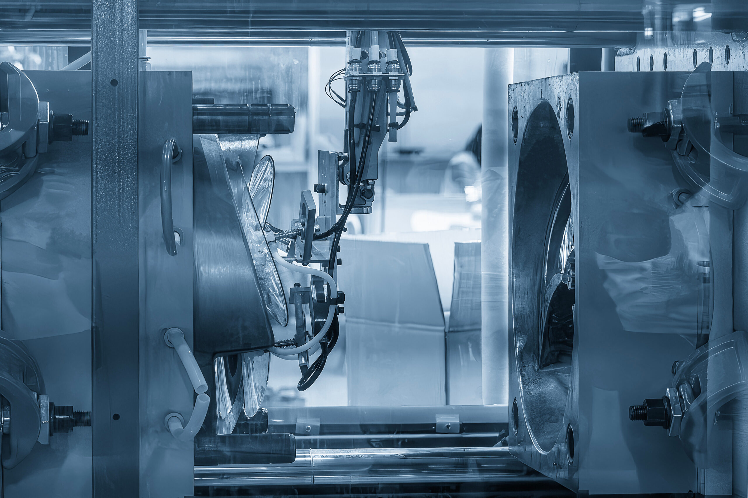

  • Injection Molding: Requires uniform wall thicknesses to prevent sink marks, draft angles (typically 1° to 3°) to allow part ejection, and careful management of undercuts, which may require complex side-actions in the tool.

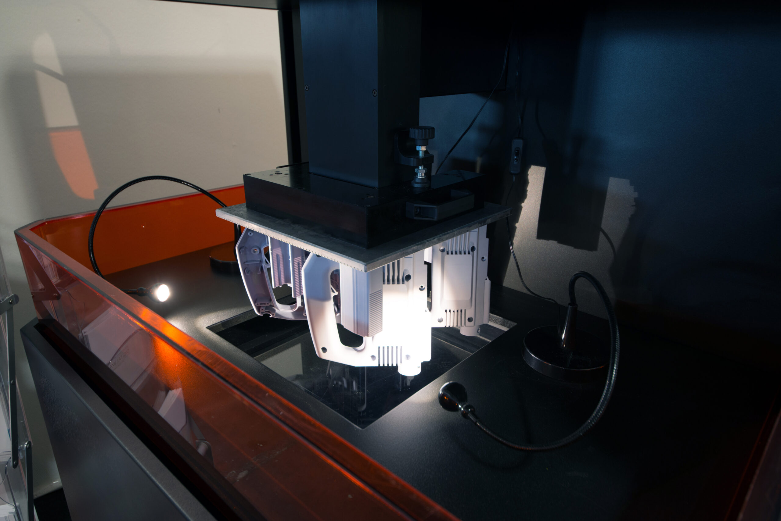

  • 3D Printing: Offers unparalleled geometric freedom, enabling complex internal channels and enclosed lattice structures. Limitations include layer-based resolution, material property limitations, and temporary support structures.

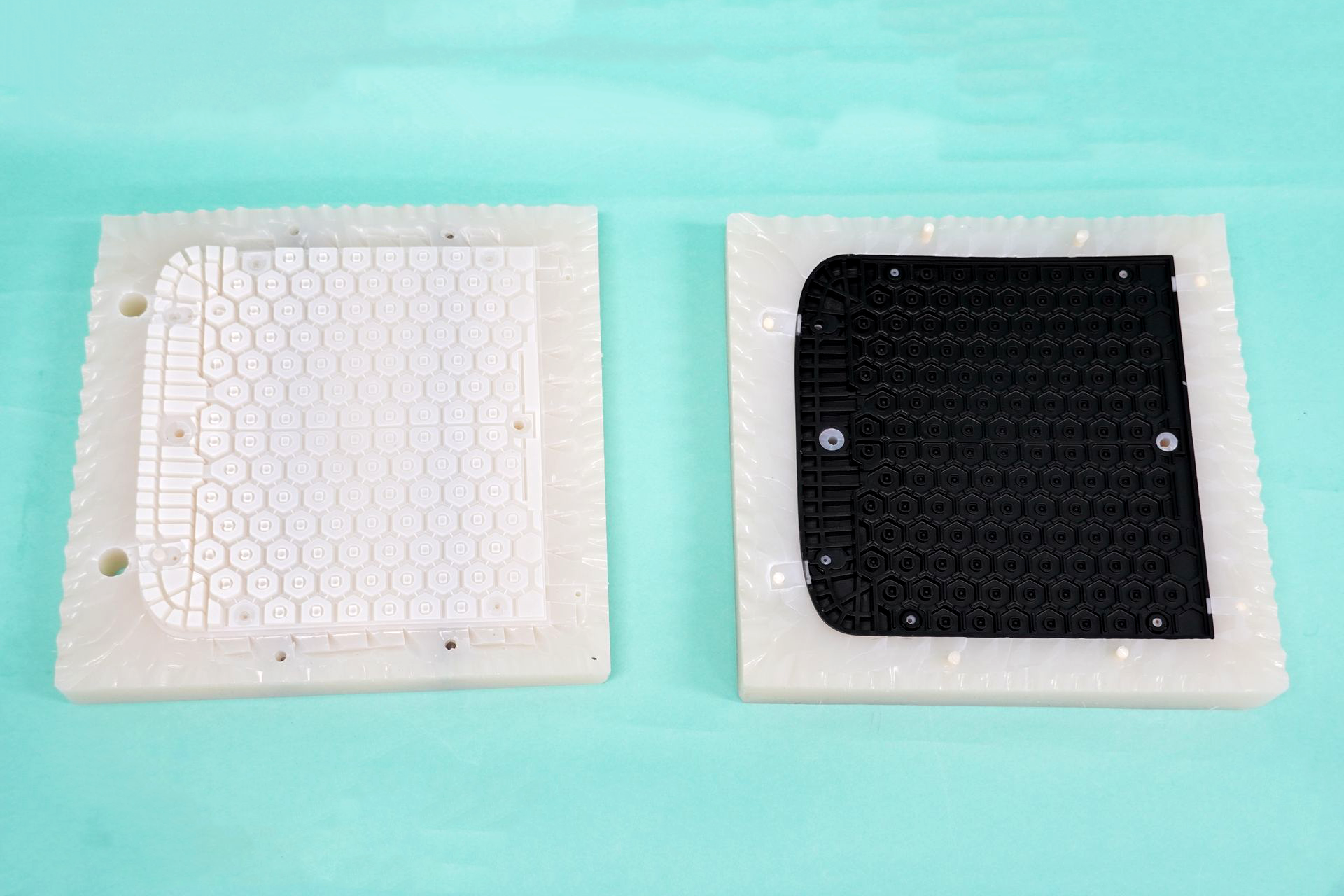

  • Urethane Casting: Mirrors the geometry of a master pattern via flexible silicone molds. It accommodates moderate geometric complexity, including slight undercuts and zero-draft walls, because the flexible mold stretches during demolding. However, it cannot reliably produce ultra-thin walls or high-precision internal features.

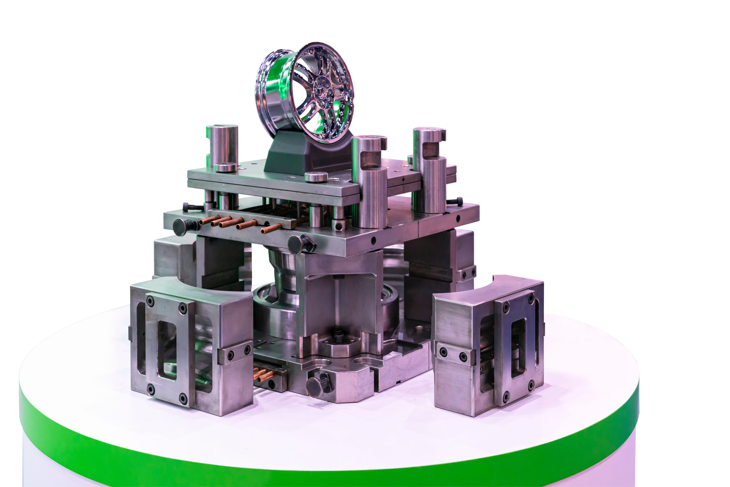

  • Metal Casting (Die Casting): Yields high-density, metallic parts with thin walls and fine surface details at high volumes. Like injection molding, high-pressure die casting requires draft angles, uniform wall transitions, and minimal internal undercuts unless sacrificial cores or moving dies are used.

Injection molding is a formative production process where molten thermoplastic resins are injected under high pressure into a precision-machined steel or aluminum mold cavity, where they cool and solidify into net-shape components.
  • Best For: High-volume plastic part production, complex net-shape geometries requiring high repeatability, structural enclosures, and consumer product components.
  • Limitations: Imposes substantial upfront tooling costs and long initial lead times (typically 2 to 12 weeks), while requiring strict adherence to DFM constraints such as mandatory draft angles and uniform wall thicknesses.
  • Key Specifications: Maintains tolerances down to +0.05 mm, serves production volumes from 1,000 to millions of units, and provides the lowest per-unit cost structure at scale.
  • Typical Product Applications: Consumer electronics housings, automotive interior trim, medical disposables, appliance components, and high-volume packaging.

3D printing or additive manufacturing creates three-dimensional parts layer by layer directly from digital CAD models, utilizing diverse energy sources and material formats (FDM, SLA, SLS, MJF, DMLS/SLM).
  • Best For: Rapid conceptual modeling, low-volume functional prototyping, highly complex internal topologies, organic geometries, and bridge production.
  • Limitations: Produces anisotropic mechanical properties (varying strength along the Z-axis) in certain sub-processes, exhibits layer-based surface artifacts, and has a high per-part cost that limits scalability.
  • Key Specifications: Achieves tolerances typically between ±0.1–0.3 mm, requires zero tooling assets, and delivers the shortest time-to-part cycles (often under 24 hours).
  • Typical Product Applications: Surgical guides and anatomical models, custom prosthetics and orthotics, aerospace ducting, quick fixtures, and complex assemblies requiring internal channels or lattice structures.

Urethane casting is a low-pressure molding process in which a two-part liquid polyurethane resin is poured or vacuum-drawn into a flexible silicone mold cavity that has been formed around a high-accuracy master pattern (typically produced via SLA or CNC).
  • Best For: Low-volume functional prototyping, cosmetic verification runs, bridge production requiring production-grade surface finish and elastomeric tactile response, overmolding validation, and multi-durometer subassemblies.
  • Limitations: Silicones degrade mechanically and chemically under the exothermic reaction of urethanes, limiting tool lifespans to 25–50 shots per mold. Resins simulate but do not match the exact mechanical properties of injection-molded polymers. It is unsuited for high-volume execution or structural metal parts.
  • Key Specifications: Turnaround lead times of 1 to 2 weeks (including silicone mold fabrication), typical tooling costs of $500 to $2,000 per mold, and practical production limits of 250-300 units with multiple molds.
  • Typical Product Applications: Sales samples and pre-production appearance models, soft-touch grips and overmolded components, cosplay armor, and low-volume medical device housings.

Metal casting methods like die casting involve mechanically forcing or pouring molten metal into a mold cavity to solidify. The family includes high- and low- pressure die casting, gravity casting, and investment casting to accommodate varying volume and alloy requirements.
  • Best For: High-volume metal component fabrication where minimizing per-unit cost is paramount, structural housings, complex automotive or industrial chassis components, and net-shape geometries in aluminum, zinc, or magnesium.
  • Contextual Offerings: High-Pressure Die Casting (HPDC) represents the primary high-volume production casting offering. Alternative foundry techniques like investment casting or gravity casting serve lower-volume production involving complex geometries or specialized alloys; such options will likely warrant detailed appraisal.
  • Die Casting Specifics: Highly optimized for thin-walled aluminum or zinc structural parts; delivers fast cycle times and good surface finishes; requires tooling investments of $10,000 to $80,000+; minimum production thresholds generally exceed 10,000 units.
  • Limitations: High tooling cost for permanent molds; die casting alloys differ substantially from wrought or billet equivalents; internal gas porosity must be managed to avoid defects; internal complexity is more constrained than injection molding.
  • Typical Product Applications: Automotive transmission housings and engine components, power tool bodies, robotics and consumer electronics structural frames, and lighting fixture housings.

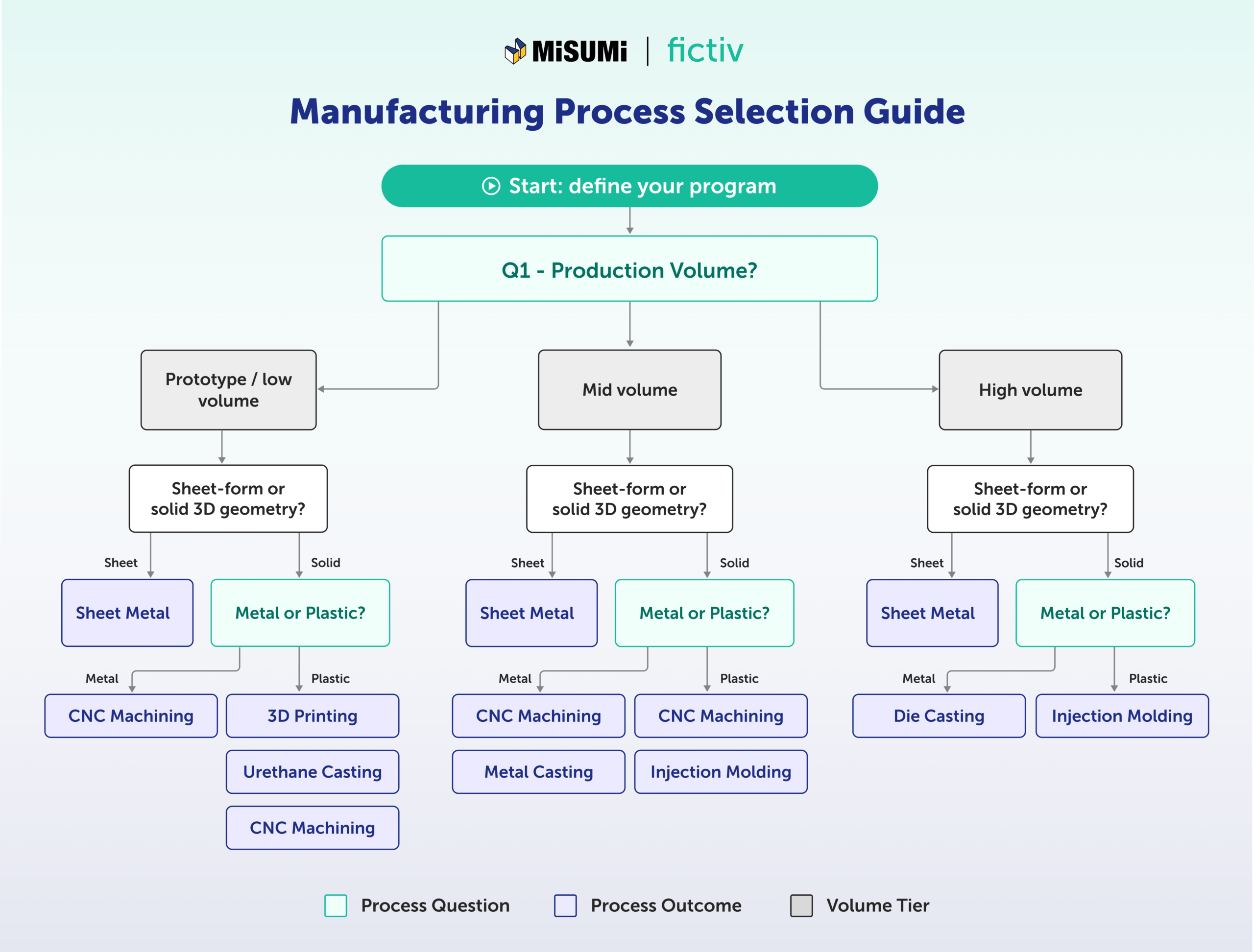

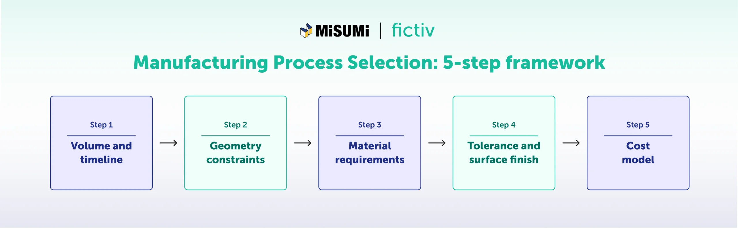

5-Step Framework: How to Select a Manufacturing Process
Manufacturing Process Selection: 5-step framework’ with five connected steps: Step 1 Volume and timeline, Step 2 Geometry constraints, Step 3 Material requirements, Step 4 Tolerance and surface finish, Step 5 Cost model.
Step 1: Define Your Production Volume and Timeline
Volume and lead time are your primary filters. Use the thresholds outlined in this guide to instantly eliminate methods that aren’t ideal for your volume requirements. If your engineering verification testing requires 10 functional metal parts in hand within 4 days, CNC machining or metal 3D printing are your best options.
Step 2: Identify Your Geometry Constraints
Map the physical part shape to the process best aligned with those profiles:
  • Uniform, flat sheet structures generally favor sheet metal fabrication.
  • Complex internal channels or undercuts often favor 3D printing, while injection molding may require side actions (at additional cost), and CNC machining may require multi-axis capabilities or multi-part splits.
  • Thin-walled components or parts with organic surface geometries are well-suited to die casting and injection molding.
Step 3: Confirm Your Material Requirements
Verify whether your material choice dictates the process:
  • CNC machining or DMLS: Certified metals/alloys.
  • Injection Molding: Production engineering thermoplastics at volume.
  • High-pressure Die Casting: High-volume nonferrous structural metals.
  • Urethane Casting (using polyurethane resins of production-matched Shore hardness): Ideal for producing prototype elastomeric or overmolded parts with production-like tactile feel (10–200 parts).
Step 4: Define Your Tolerance and Surface Finish Requirements
If critical features require tolerances tighter than ±0.05 mm, CNC machining should be used as either the primary process or a secondary machining operation.
Step 5: Run the Cost Model
Evaluate total program cost rather than individual part prices using the following formula.
C_total = C_unit + (C_tooling / N)
(Where N is the total production run volume)

Manufacturing Process Selector
Answer a few questions to find the right process for your part.
