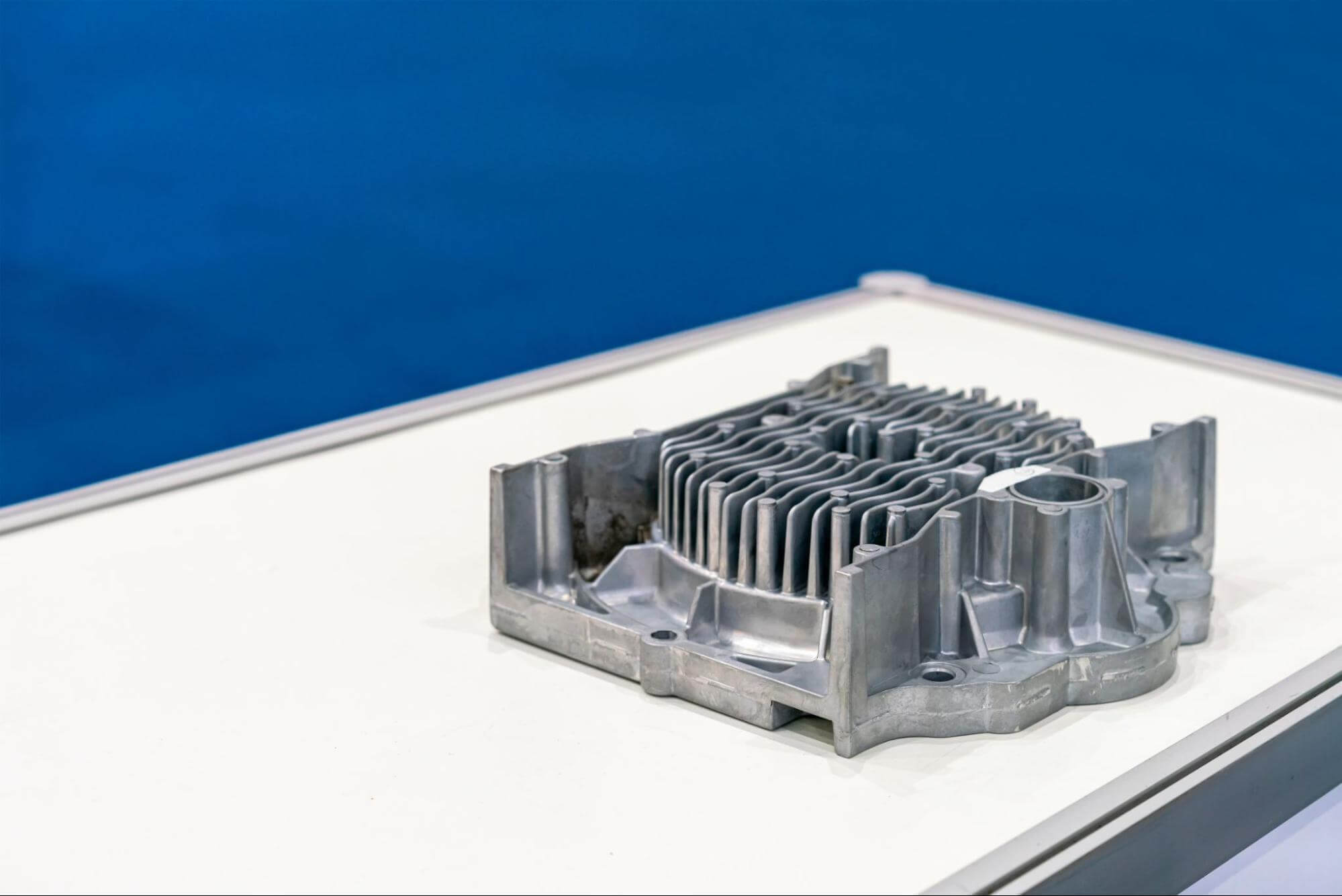

High-pressure die-cast part

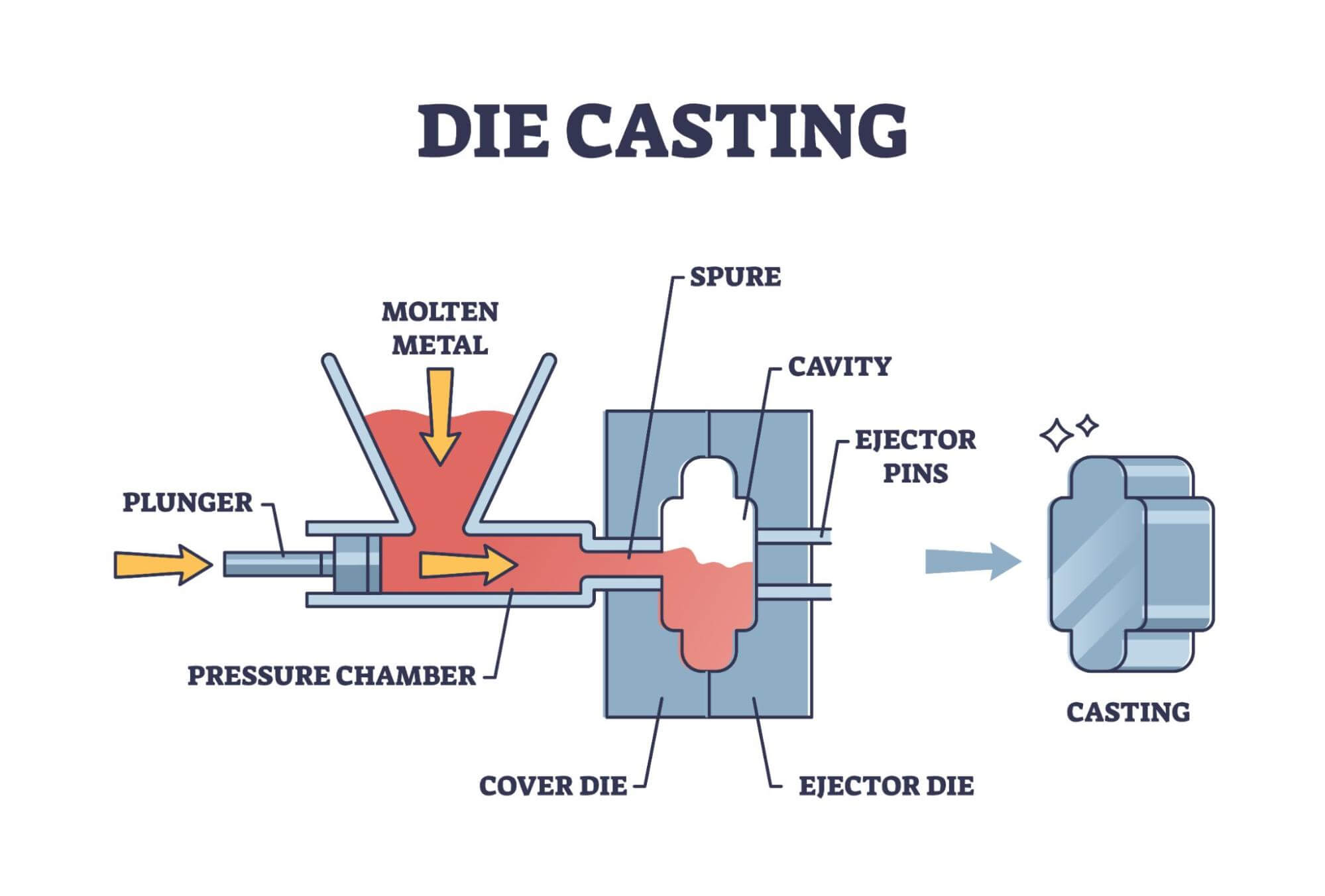

High-pressure die casting (HPDC) is essentially the equivalent of injection molding for metal manufacturing. It’s a manufacturing process in which molten metal is injected into a steel mold cavity at very high pressure (typically between 10,000 and 20,000 psi). This forceful injection enables the molten metal to quickly fill intricate mold features and solidify into precise, high-quality components. Hardened steel molds allow repeated use, making HPDC an ideal choice for mass production of complex parts with excellent surface finishes and dimensional accuracy.
Die casting process diagram.

1. Molten Metal Preparation
Metal ingots (commonly aluminum or zinc) are heated in a furnace until they reach the ideal casting temperature. Maintaining this temperature is crucial to achieving optimal fluidity and avoiding casting defects.
2. High-Pressure Injection
Once the metal is at the casting temperature, it is injected into a steel mold cavity at extremely high pressure, typically between 10,000 and 20,000 psi. The high injection pressure pushes the molten metal into the closed dies in a matter of milliseconds. The high-speed mold fill, in conjunction with proper gating and vent design, minimizes the likelihood of air entrapment in the solidified casting and ensures that the molten metal completely fills intricate mold details.
3. Solidification and Cooling
As molten metal enters the mold cavity, the first liquid to enter solidifies when it contacts the cold mold walls. As more liquid metal follows to completely fill the mold, heat continues to be conducted away by the mold surfaces. The entire casting solidifies rapidly, allowing premium surface finishes and tight dimensional tolerances.
4. Part Ejection
After solidification, the mold opens and the part is ejected using mechanical ejector pins mounted on a steel plate that is electrically or hydraulically actuated. These pins help release the component without damaging the delicate surfaces or compromising dimensional integrity.
5. Trimming and Finishing
Once the part is removed from the mold, any excess material or flash formed at the mold’s parting line is trimmed off. Depending on the application, additional finishing processes, such as machining, coating, or surface texturing, may be performed to meet specific quality or aesthetic requirements.

Ability to Form Complex Geometries
The high pressure used during the injection phase allows molten metal to flow into intricate features and thin sections of the mold that would be difficult or impossible to fill using other casting methods. This makes HPDC especially valuable for lightweight structural components with complex internal features, such as ribbing, bosses, or undercuts. As a result, engineers can design parts with more innovative shapes without compromising manufacturability or structural integrity.
High-pressure die casting can form complex geometries.

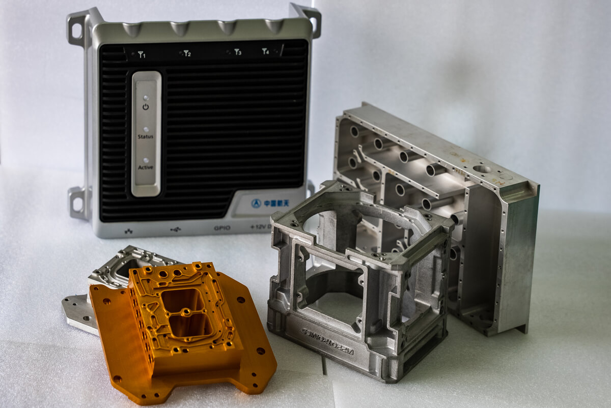

Electronics and Consumer Goods
Electronics and consumer goods also utilize HPDC for items such as laptop and smartphone housings, as well as heat sinks used in thermal management. These parts require fine details, good surface finishes, and high-volume production, all of which HPDC delivers proficiently.
Medical Equipment
Medical equipment manufacturers rely on high-pressure die casting for components that require both biocompatibility and precise dimensions. Surgical tools, diagnostic device enclosures, and other medical parts benefit from the dimensional accuracy and repeatability that the process offers.
Die casting is used for consumer electronics housings and other applications.

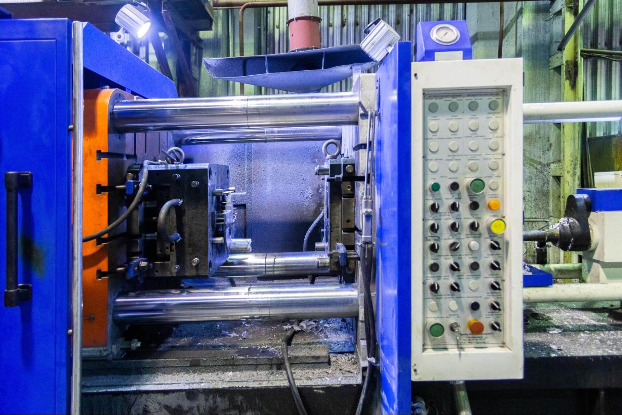

High-pressure die casting machine.
