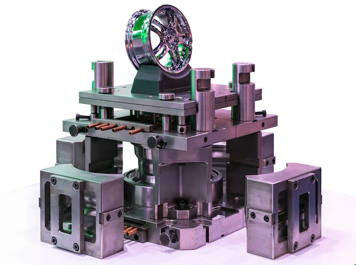

low pressure die casting mold and metal wheel
Low pressure die casting mold
What Is Low-Pressure Die Casting?
Low-pressure die casting uses permanent molds (dies) and applies a low positive pressure of 0.3–1.5 bar to push molten metal slowly into the dies. The controlled pressure minimizes turbulence and air entrapment as the metal fills the mold, producing cast components with minimal porosity and heat-treatable properties.

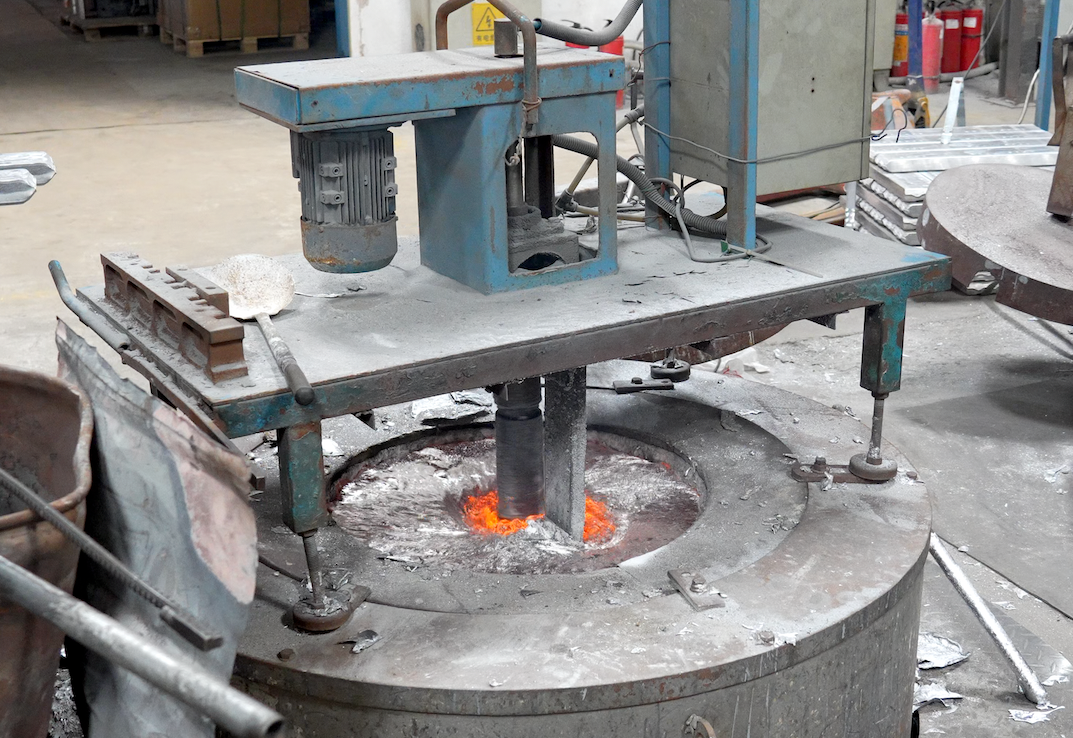

The first step in the LPDC process is to prepare the molten alloy (e.g., A356). The metal is heated in a crucible to about 150°C above its melting point, then degassed to release trapped hydrogen, which would cause porosity in the finished casting. Rotary degassing, or bubbling an inert gas (such as argon or nitrogen) through the molten metal, allows hydrogen to diffuse out and be released.
Temperature control of both the molten metal and the receiving molds is important. If the melt temperature is too low, the die may not fill completely before the metal begins to solidify; if it’s too high, there may be shrinkage after casting. The melt needs to be held to a particular temperature, usually within the range of 700-730°C for alloys like A356, and the dies are typically preheated to 200-350°C.
Molten metal degassing
