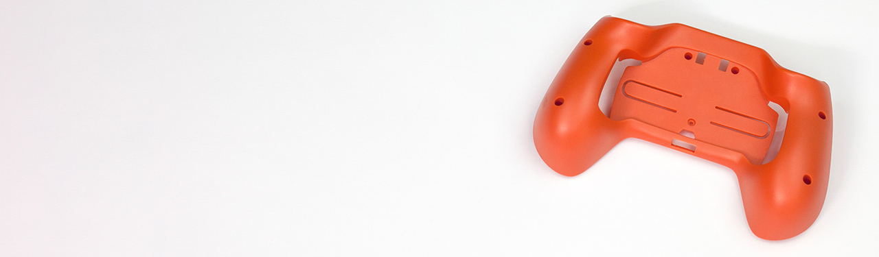

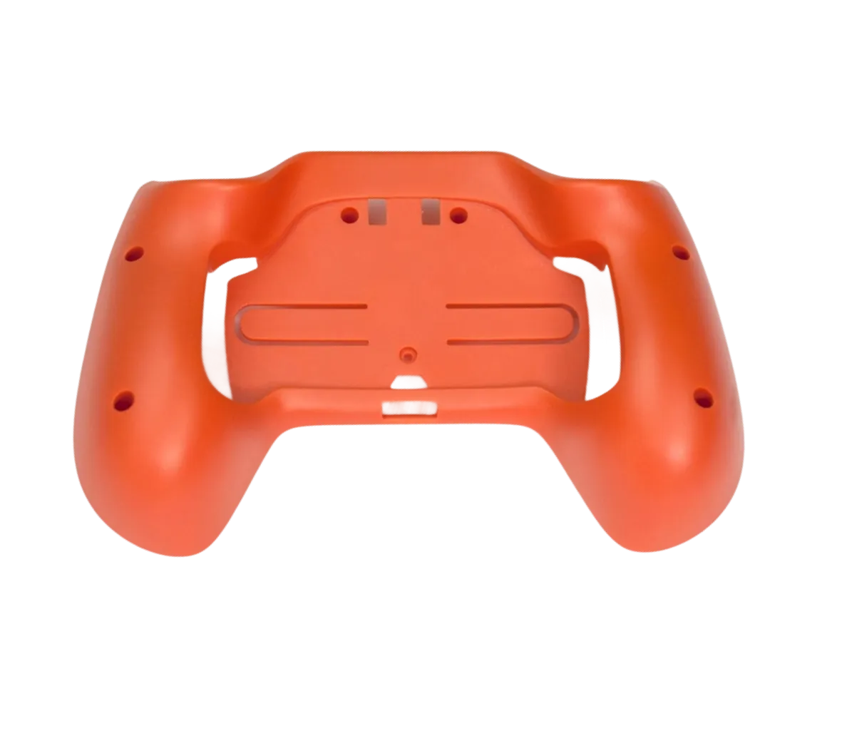

ABS-Like is a general purpose polyurethane plastic that simulates ABS thermoplastic. This material is a great choice for most product enclosures.
