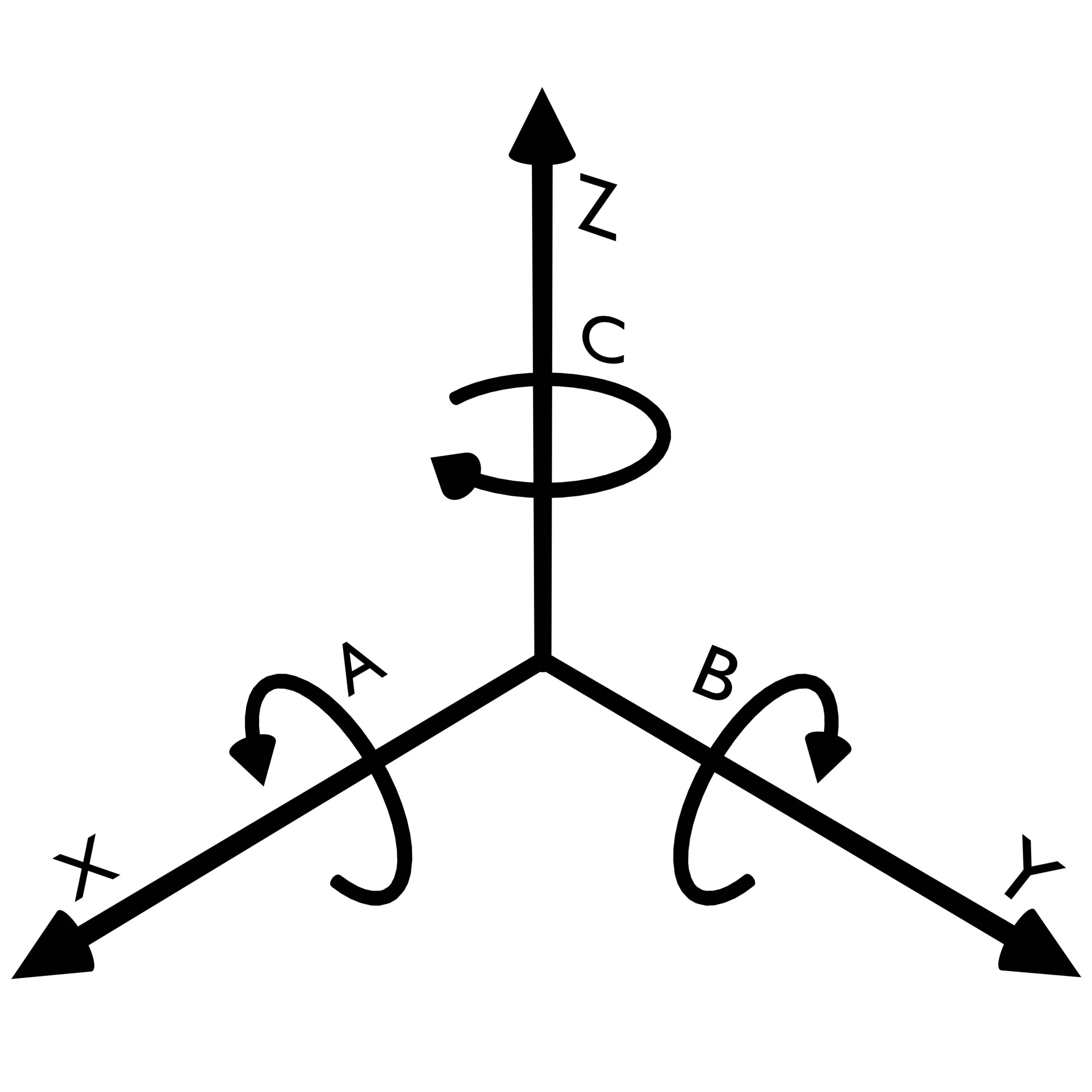

How Many Axes Does a Typical CNC Machine Have?
Most CNC machines operate on 3 to 5 axes, while advanced multi-axis systems can have up to 12 axes, depending on complexity. The foundational 3 axes are linear motion in X, Y, and Z directions; the next two are rotations about two of these axes.
Advanced systems can scale up to 7 axes or more. Going beyond 5 axes doesn’t just mean adding more directions of movement—it usually means combining entirely different manufacturing capabilities into a single machine.

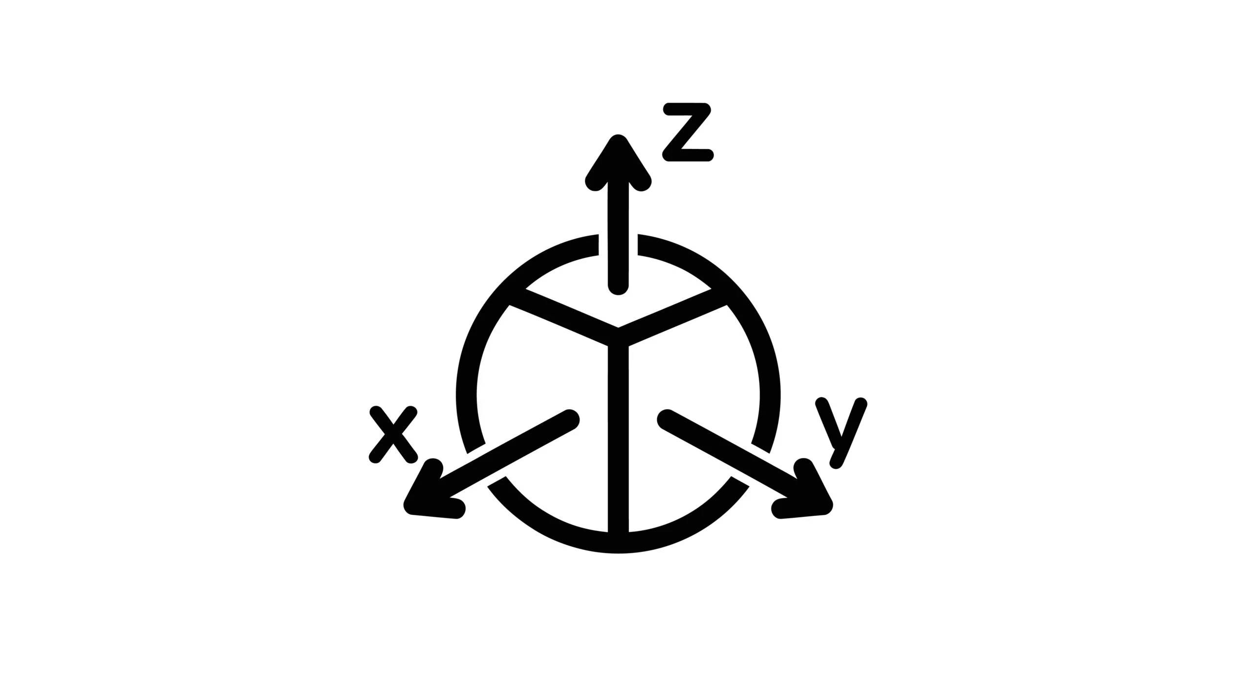

The three axes of movement in 3-axis machining are:
  • X-axis: Linear horizontal movement from left to right.
  • Y-axis: Linear horizontal movement from front to back.
  • Z-axis: Linear movement in the vertical direction.
In 3-axis machining, the workpiece is typically fixed, and the cutting tool moves in the three linear directions described above. Alternatively, the workpiece could move in one or two axes, with the tool moving in the remaining axes. As the cutting tool moves relative to the workpiece, it removes material, cutting it to the required dimensions. Multiple passes across the workpiece are usually needed to achieve the overall dimensions.

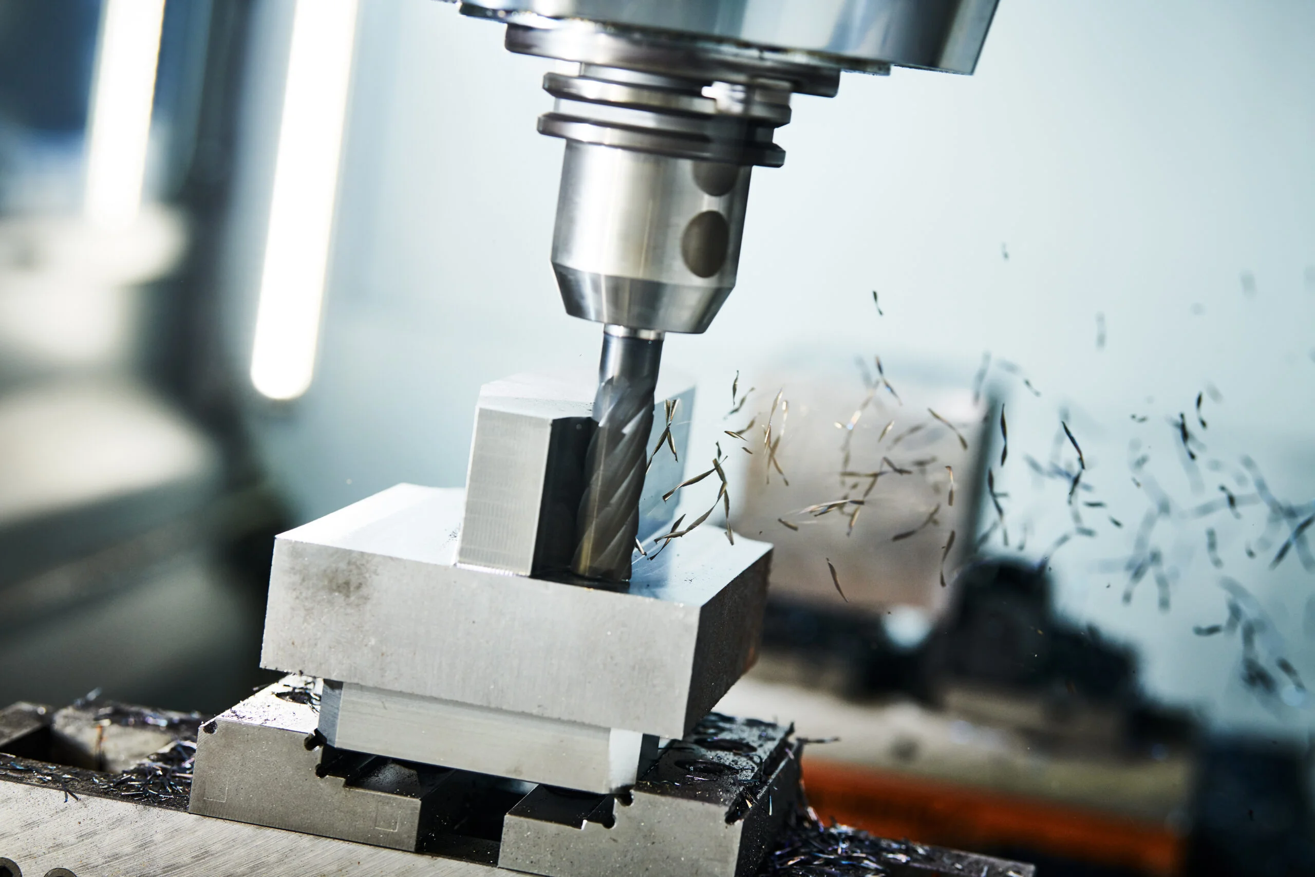

The primary operations for a 3-axis CNC machine include flat-surface milling, facing, drilling, and tapping holes. However, its capabilities extend far beyond basic flat geometries into complex structural and organic shapes.
For standard industrial parts, a 3-axis milling machine is commonly used for 2.5D machining. In 2.5D applications, the machine cuts features at varying depths, such as pocketing, slotting, and step profiles. While the finished part is three-dimensional, the cutting tool typically moves simultaneously in only two linear dimensions (X and Y) while stepping down incrementally along the Z-axis.
Modern 3-axis machines are also fully capable of true, simultaneous 3D surface contouring. By interpolating the X, Y, and Z axes at the exact same time, a 3-axis mill can use a ball-nose end mill to carve smooth, organic geometries like consumer electronics enclosures and injection mold cavities.

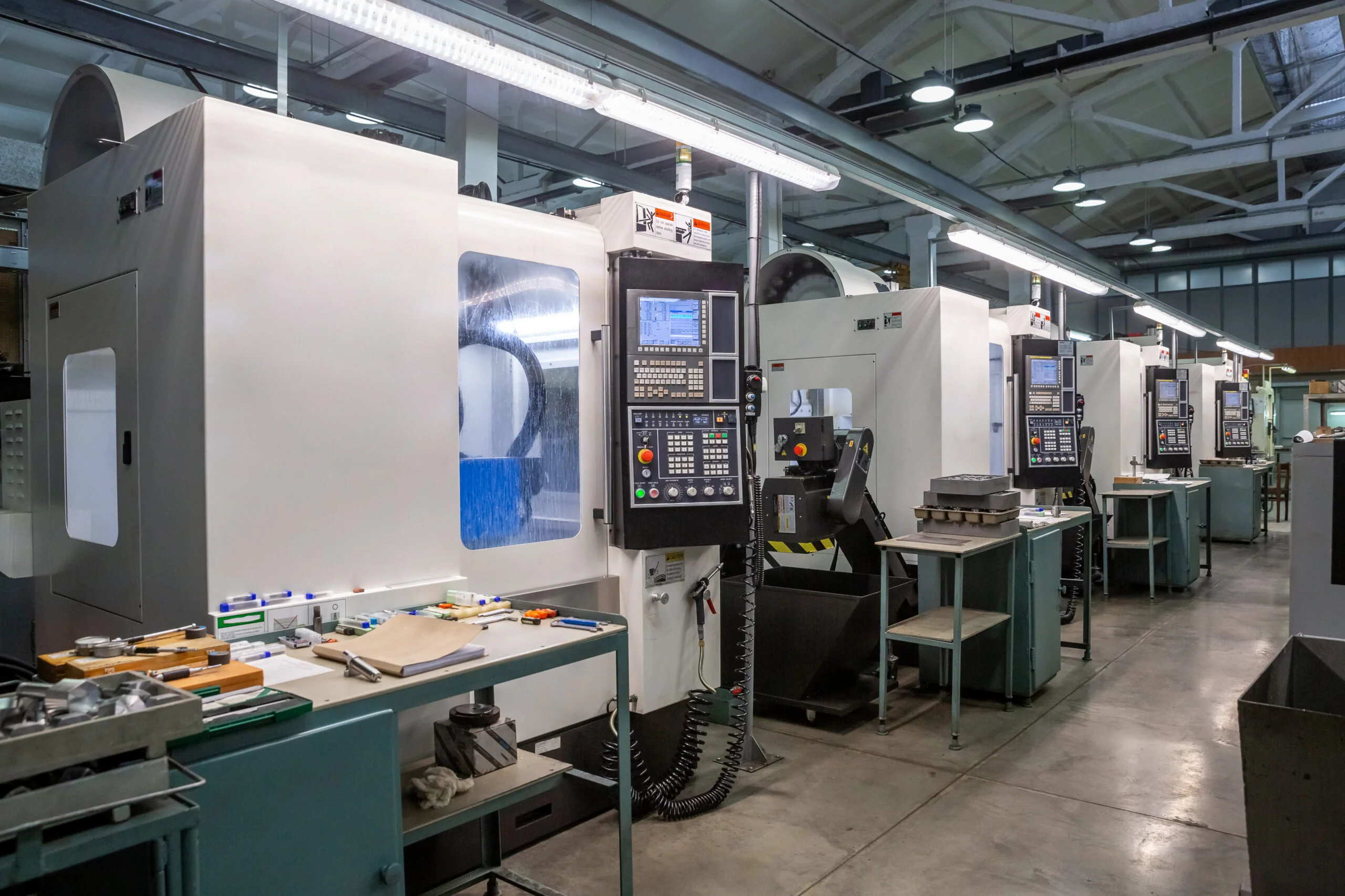

Industrial 3-axis CNC machining center
Industrial 3-Axis CNC Machining Center vs. CNC Router
Sourcing professionals often evaluate different tiers of three-axis equipment. It’s important to distinguish between a commercial 3-axis CNC router and an industrial-grade 3-axis CNC machining center.
  • 3-Axis CNC Routers: Typically designed for soft material execution (wood, plastics, and thin-gauge aluminum sheets). Routers rely on a moving gantry system over a fixed bed. While highly efficient for large, flat-surface areas, they lack the structural rigidity required for tight engineering tolerances or hard metal alloys.
  • 3-Axis CNC Milling Machines: Engineered for rigid, high-precision fabrication of metal and structural plastics. In these industrial milling machines, or mills, computer numerical control drives heavy-duty spindles into fixed or indexed workpieces. If your design requires tight geometric dimensioning and tolerancing (GD&T), mold finishes, or heavy material removal in alloys like titanium or 4140 steel, the job should be dedicated to a 3-axis CNC milling machine.
