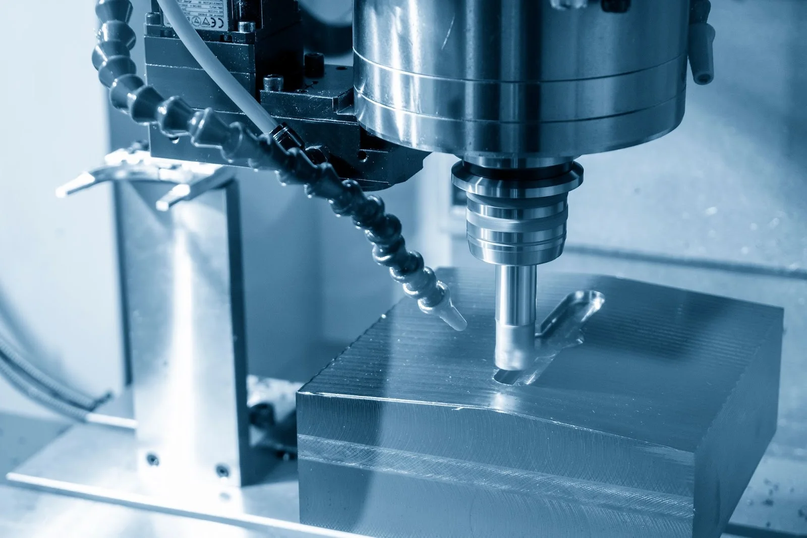

surface roughness from machining
Surface roughness, also known as surface finish or surface texture, is a critical feature that can distinguish a rough looking prototype from a polished finished product. In this article, we’ll explain what surface roughness is, how it’s measured, and identify some typical finishes to showcase what can be accomplished with CNC machining, and when post-processing is needed.

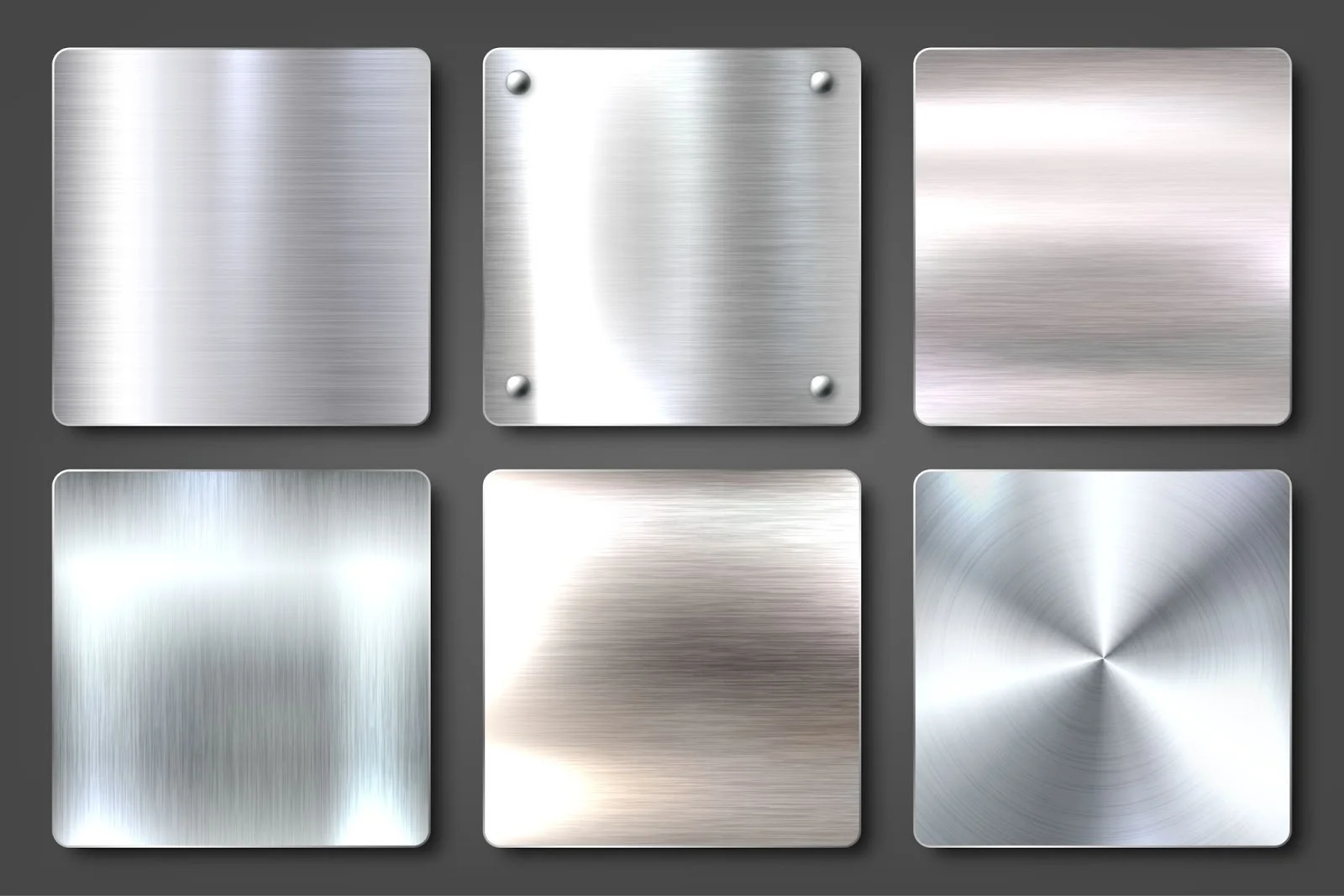

Lay is the direction at which the surface pattern is observed. An easy way to visualize the lay is looking at the direction of the machining or sanding marks on the part. For example, if you use a circular grinder on a surface of a cylinder, the grind marks follow a circular pattern, or, in other words, have a circular lay. Lay not only directly impacts the cosmetic appearance of a surface, but can also provide physical advantages such as increased sealing capability. For example, a circular lay for a metal-to-metal circular flange interface helps seal at the micro level due to the direction of the micro indications on the surface.

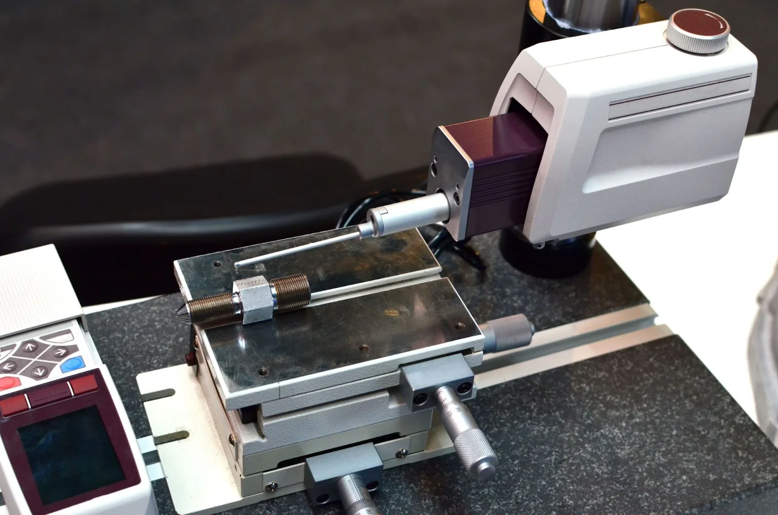

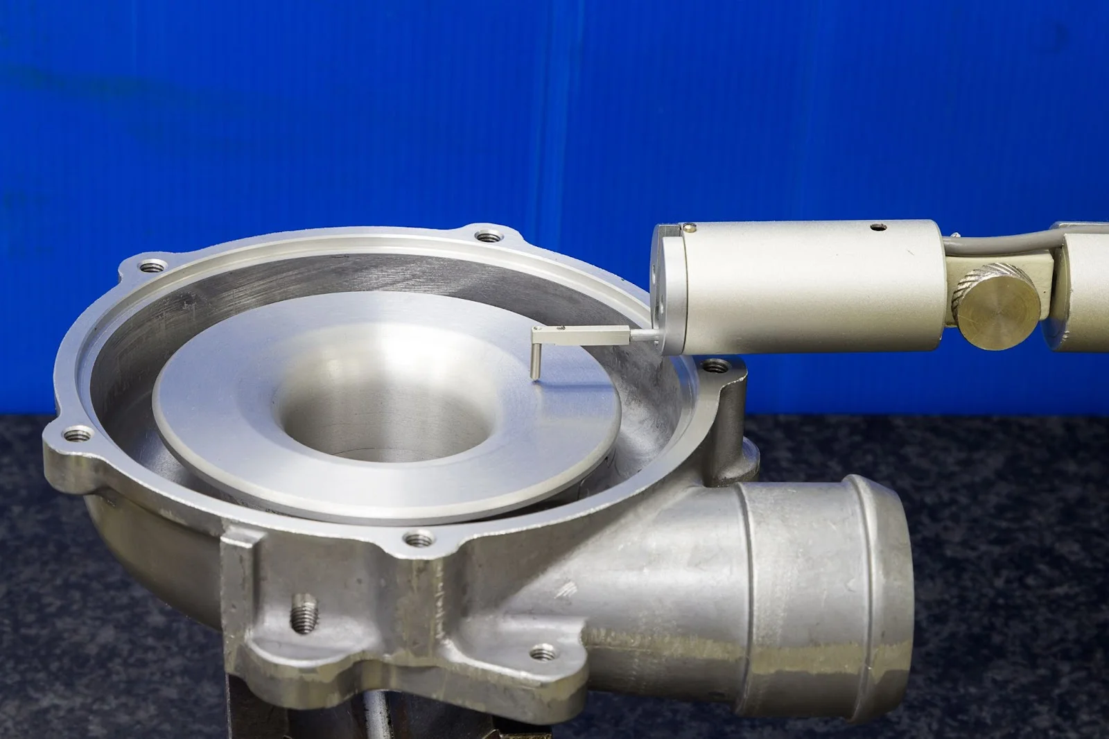

Profilometers are the most common method if high repeatability and accuracy is required to meet a specific surface roughness requirement. A profilometer — often called a surface roughness tester or surface roughness gauge — is a device with a highly sensitive probe designed to be dragged across a surface to precisely measure its peaks and valleys at a programmed length. The device then calculates the surface roughness value. More expensive and elaborate profilometers also allow the user to modify the calculation parameters or output other characteristics such as peak-to-peak distances and total wavelength amplitude.Using this method, there are several surface roughness terms you need to know in order to understand the results produced.
  • Ra is the most commonly used surface finish unit for typical surface roughness requirements. Obviously the ‘R’ stands for roughness, but the ‘a’ stands for average. In other words, Ra describes the average surface roughness of the part. Ra is the standard value found on drawing requirements and surface finish charts and standards. When you see “125 surface finish, or 63 surface finish,” this number refers to the Ra value.
  • Rmax describes the “max” distance between a peak and valley in a measurement range. This provides another characterization of the surface which is glossed over if you only consider the average. For example, if you have an area where a machining insert was dulled and caused a small rough patch, it drives down the average surface roughness, and is otherwise difficult to detect. A clearly defined Rmax would flag this as this rough patch and cause a high amplitude of roughness outside the acceptable range.
  • Rz is also another way to interpret results, as it provides five instances of individual measured distances and averages the average value between the highest peak and the lowest valley in these sections. This allows for more impact from extreme outlier sections (see Rmax above) in the case for critical roughness requirements.
  • Mu (μ) is the Greek letter representing the micrometers symbol, which is .000001 meters. This is the typical resolution of surface roughness measurements.
