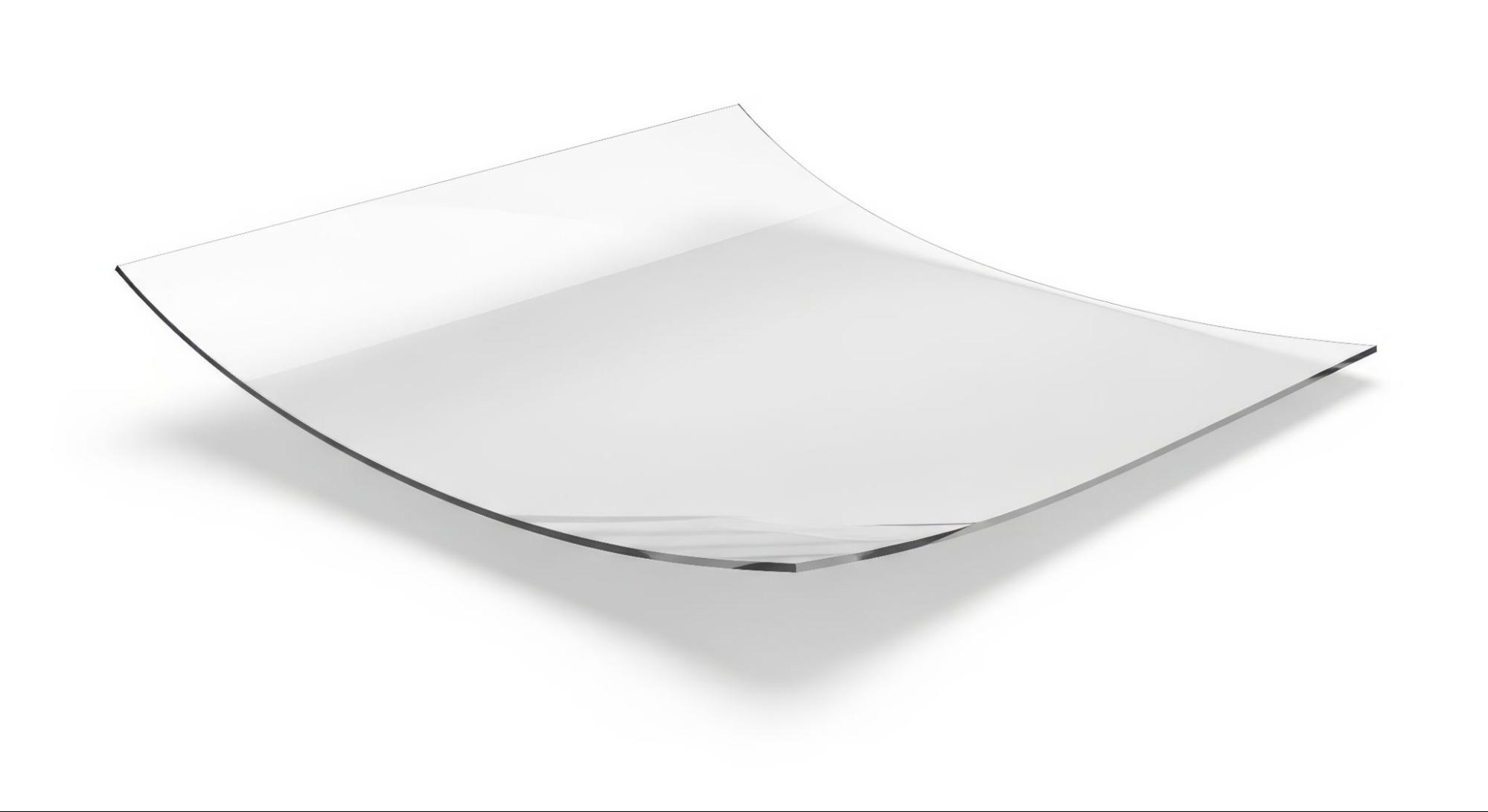

Warping is a common defect in injection molding that creates distortion of a plastic part after ejection. Warpage is caused by uneven shrinkage, as a result of residual stresses or cooling imbalances, and often appears as twisting, bending, or dimensional inaccuracy.
Root causes include nonuniform wall thickness, improper mold design, material shrinkage rates, and inadequate processing parameters. Warpage can be minimized through effective part design, optimized cooling, material selection, and process adjustments, such as holding pressure and mold temperature balance.
In CAD, it’s fairly easy to make a straight, flat surface. But in injection molding, you are dealing with much more complexity than a couple clicks of a mouse. Various design and processing factors can lead to warping and other associated defects.
Alt text: sheet.
What Warpage Means To Product Development Teams

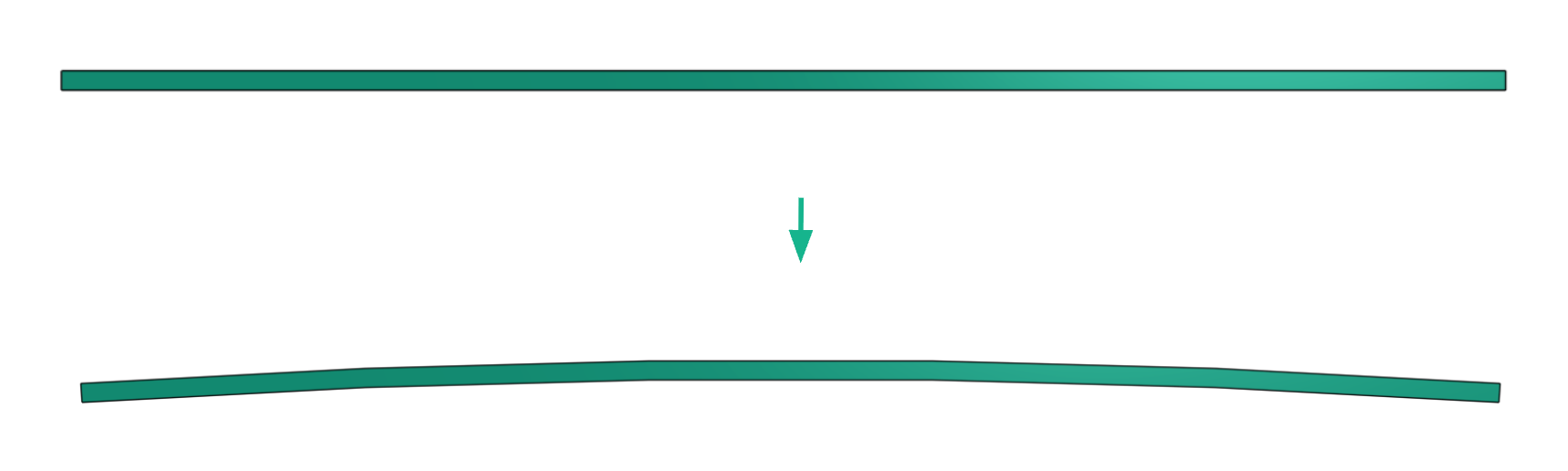

Warp occurs when a molded part deviates from its intended shape after ejection and cooling, usually due to twisting, bending, or bowing out of tolerance. While the part may appear dimensionally accurate inside the mold, it can distort as internal stresses arise during cooling or after ejection.

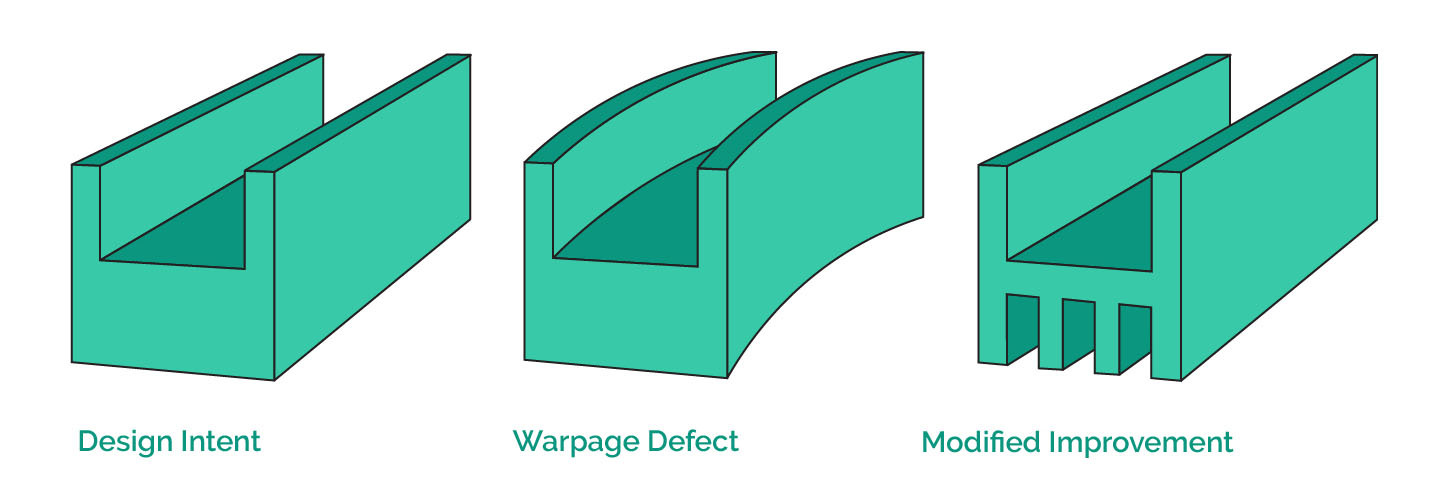

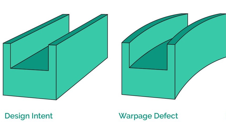

Injection molding warpage defect example and modification for improvement

Fundamentally, warpage is caused by nonuniform shrinkage. When molten plastic cools, it contracts. If different areas of a part shrink by different amounts or in different directions, residual stresses are introduced. The effects of these stresses become visible as the part warps once it’s free from mold constraints. The various causes of warpage are explained in more detail below.

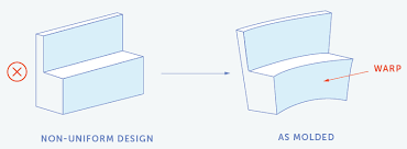

Non-uniform wall thickness can lead to warping.

  • Wall Thickness Variation: The most common design-related cause of warpage. Thick and thin sections cool at different rates, creating shrinkage gradients.

  • Lack of Structural Support: Large, flat parts without ribs or gussets tend to warp easily since there’s little geometry to resist internal stress.

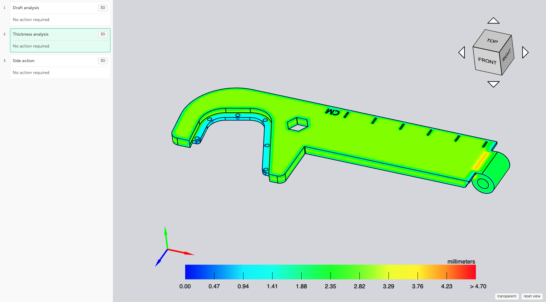

  1. Uniform Wall Thickness: Keep wall sections as consistent as possible. If variations are unavoidable, transition walls gradually, using fillets or tapers.

  3. Use Ribs Instead of Thick Walls: Ribs provide stiffness and strength without creating thick sections that cool unevenly.

Thickness analysis on the Fictiv platform.

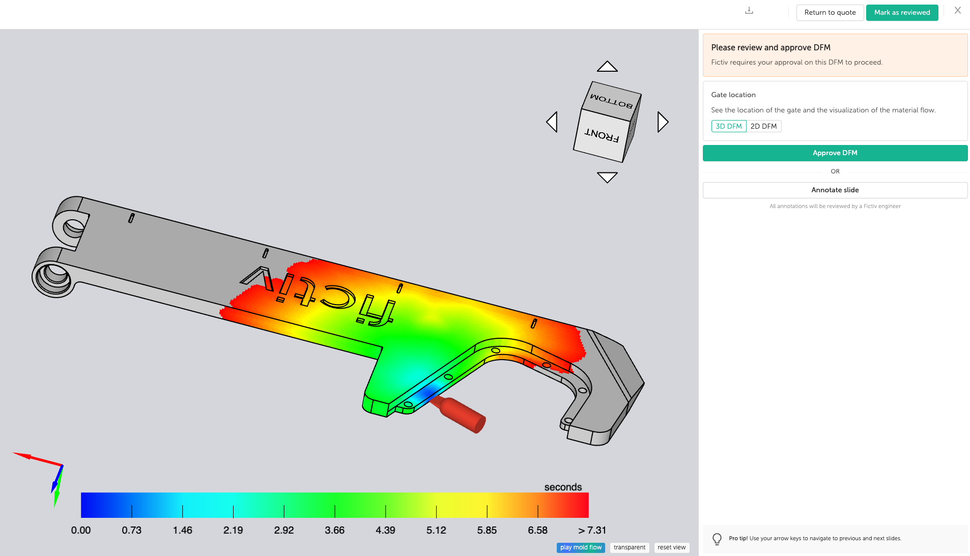

Moldflow, Moldex3D, Sigmasoft, and other software can simulate the filling, packing, and cooling phases of injection molding. These programs predict shrinkage, temperature gradients, and fiber orientation fields to give engineers insight into potential warpage behavior.
A typical workflow includes:
  • Importing CAD geometry and material data.
  • Simulating the mold filling and cooling process.
  • Evaluating predicted warpage contours and deformation vectors.
  • Iteratively modifying gate locations, cooling channels, or wall thicknesses to reduce deformation.
Mold flow simulation on the Fictiv manufacturing platform.
