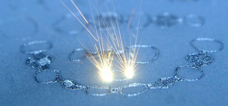

Direct Metal Laser Sintering in action

DMLS is a very new technology first developed in 1995, but not advanced enough to produce commercial products until 2006. Like all additive manufacturing technologies, building begins by slicing a CAD model into thin layers. DMLS, like SLM and EBM, works by running a heat source (laser beam) over micron-thin layers of metal powder in the shape of the design to fuse them together
With EBM and SLM, the material is fully melted whereas in DMLS, the material is heated just enough for the molecules to fuse together. All three technologies are capable of producing parts with over 98% density and leftover powder can be reused repeatedly so waste is low.
