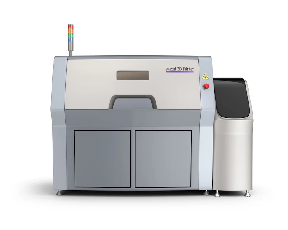

metal 3D printer
A metal 3D printer

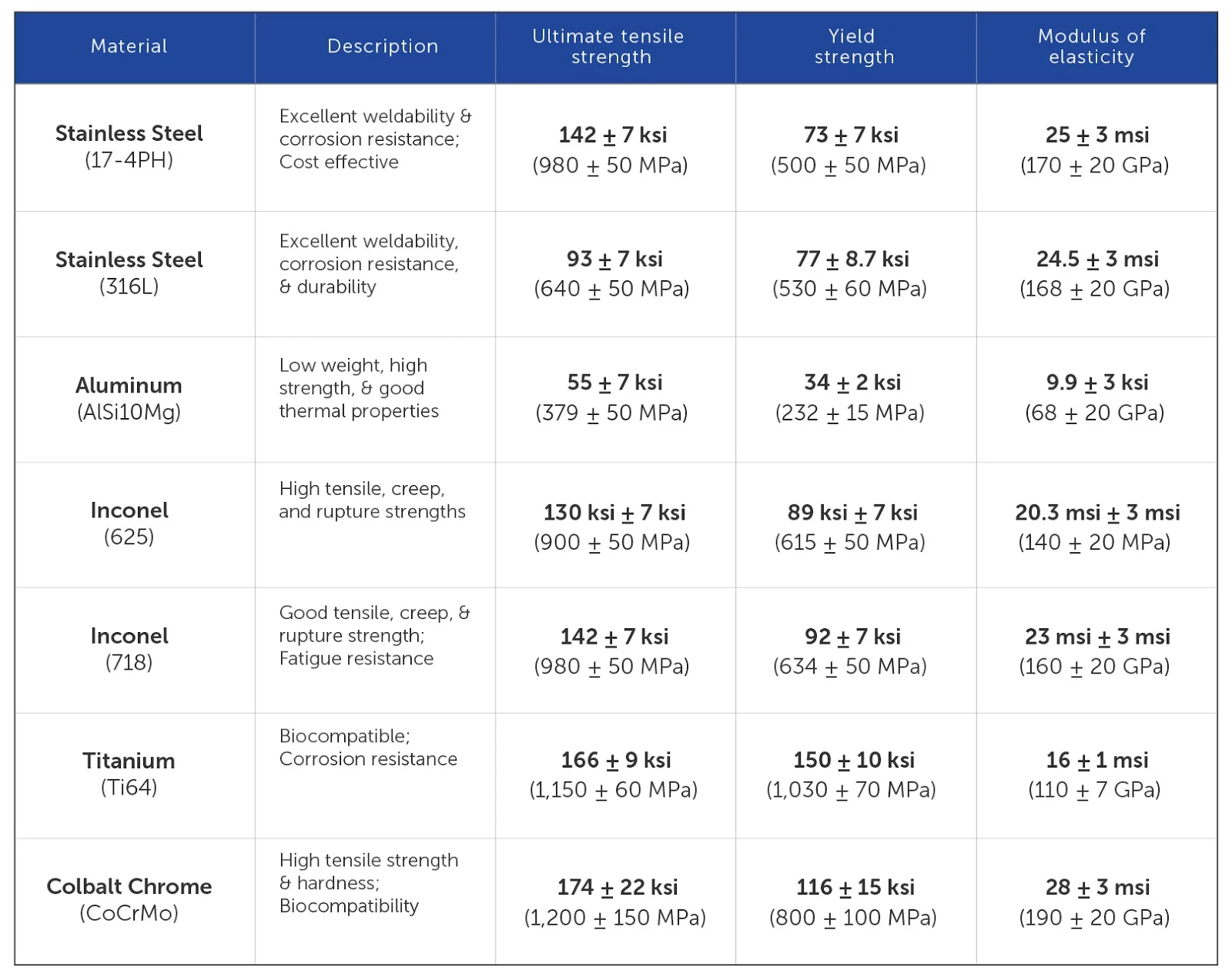

DMLS materials include Stainless Steel 17-4 PH, Stainless Steel 316L, Aluminum AlSi10Mg, Inconel 625 and 718, Titanium Ti64, and Cobalt Chrome CoCrMo. These materials are summarized in the table below, along with some of their material properties. More material property information can be found here. These materials are strong, durable, heat-resistant, and denser than investment-casted metal parts.
DMLS materials chart
DMLS materials

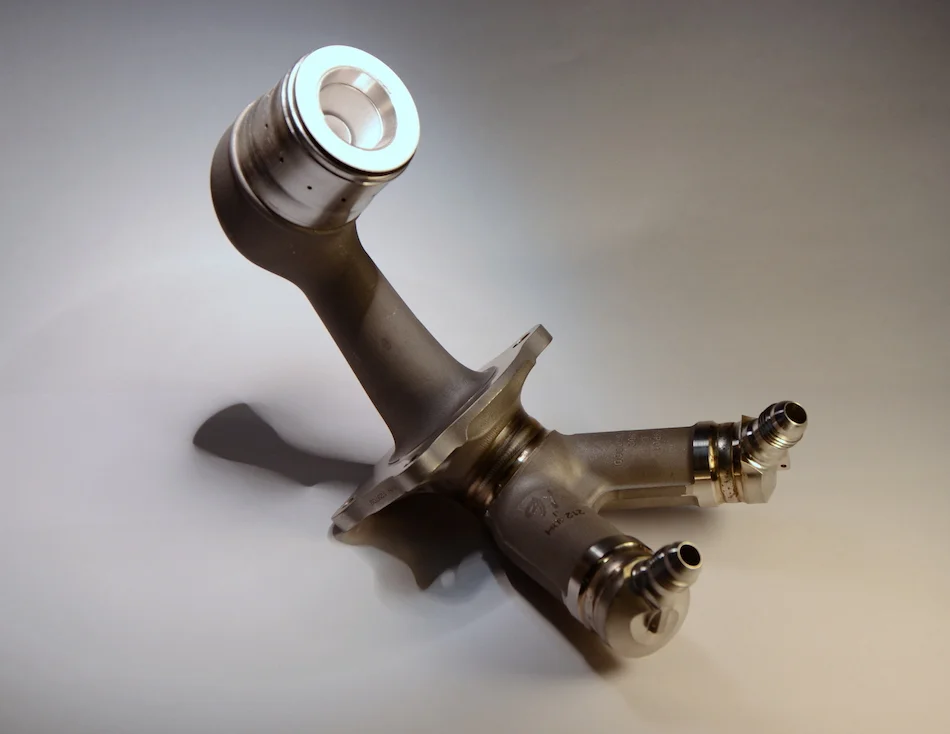

Even with its limitations, DMLS has been taking over the aerospace industry. GE is 3D printing fuel nozzles for their new LEAP and GE9x engines and have performed successful test flights with the 3D printed parts. The 3D printed fuel nozzles give the engines stronger thrust, reduced fuel consumption, and higher durability.
‍A 3D printed fuel nozzle (image source: GE)

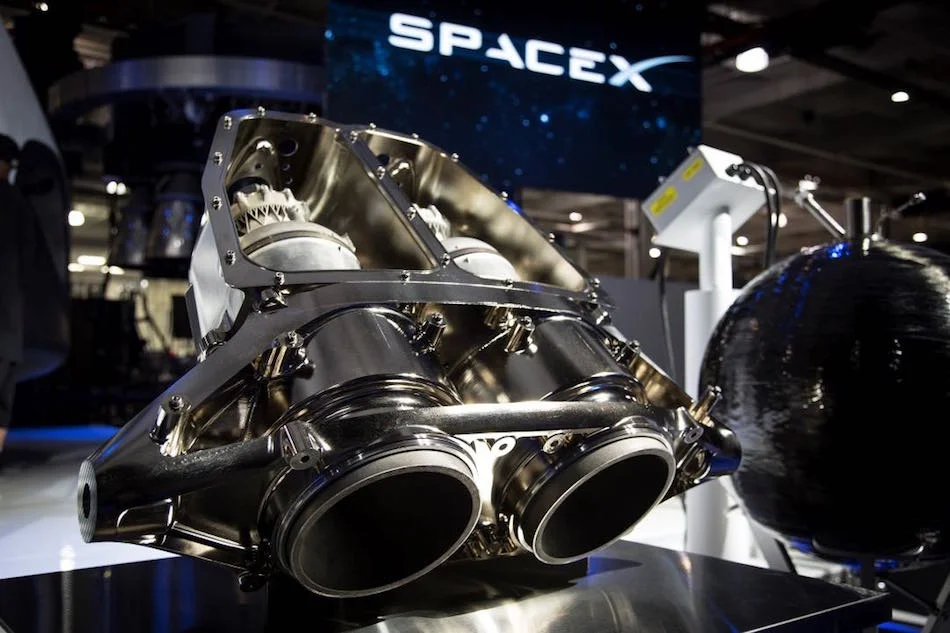

SpaceX is also using DMLS to produce their regeneratively-cooled SuperDraco Engine Chamber, which will be used on the crewed spaceflight program and the Dragon Version 2 vehicle. In 2013, the SuperDraco engine successfully fired at full thrust using the 3D-printed engine chamber.
