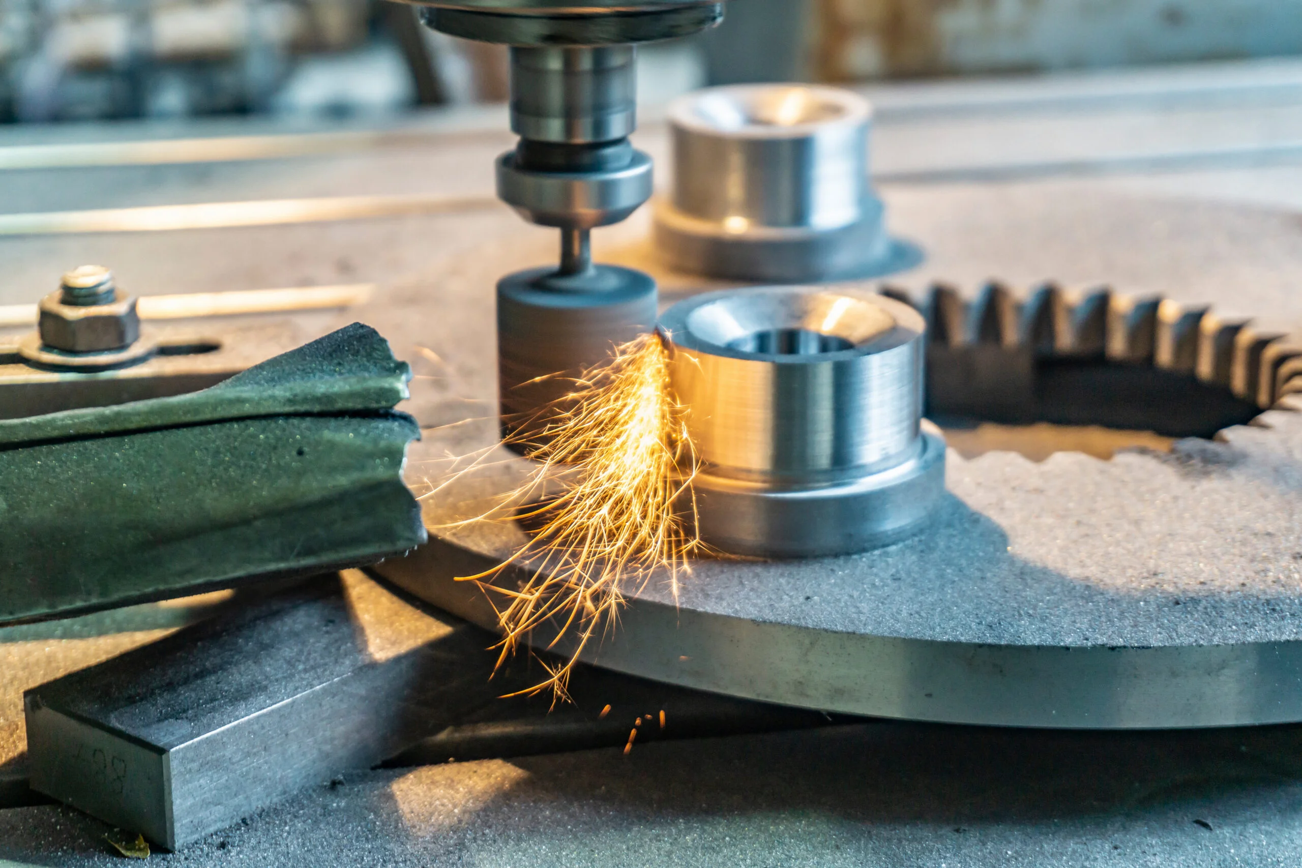

Surface grinding machined parts

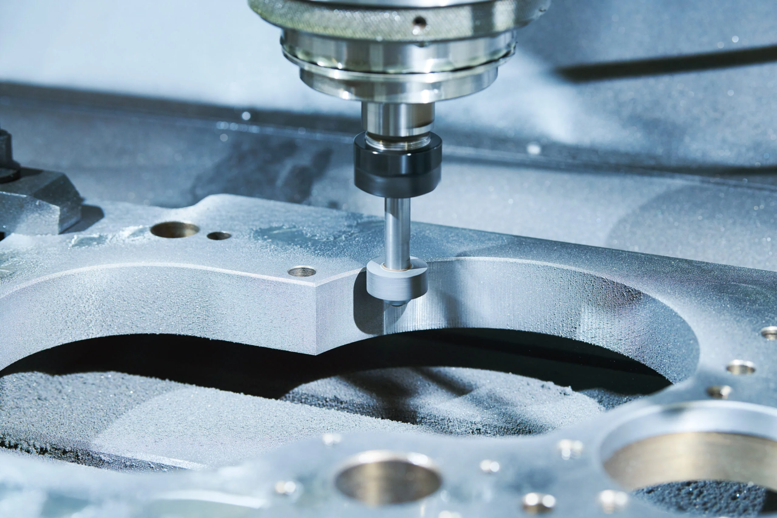

CNC milling and turning are excellent processes right up until a feature demands tighter control than the process can hold repeatably. At that point, grinding is a better choice.
Well-set-up CNC milling routinely holds a tolerance of ±0.025 mm on most features. Tighter tolerances are achievable with care, though not reliably below ±0.01 mm across a production run. Some shops can push an individual feature tighter still, into the low single-digit micron range, with the right machine, fixture, and inspection loop, but that’s a best-case result. The surface finish produced by finish milling typically lands at Ra 0.8 to 1.6 μm. You can push it down to Ra 0.4 μm with fine feeds and sharp tooling, but holding that consistently across a batch is a different problem entirely.
Even with 5-axis CNC machining capability, achievable tolerance and finish come down to tool deflection, setup rigidity, and cutting rate parameters. CNC machining reaches its limit in applications such as bearing seats needing a consistent ±0.005 mm diameter, sealing surfaces that need Ra 0.4 μm or flatter every time, gear tooth profiles with strict involute form requirements, and flat mating surfaces requiring flatness under 0.01 mm, a geometric-form spec distinct from the Ra requirement above.

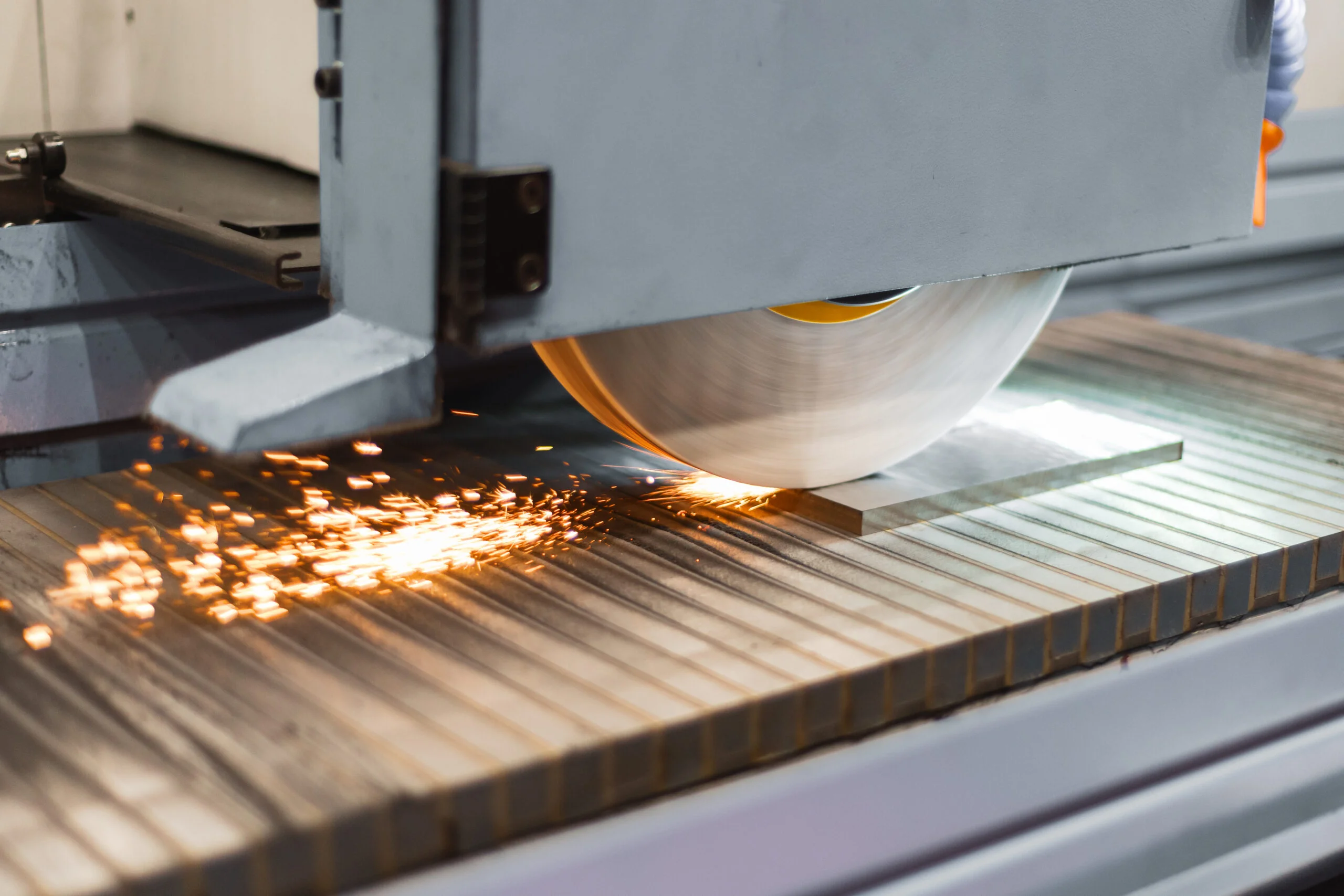

Surface Grinding
Surface grinding is accomplished by a rotating abrasive wheel that traverses the workpiece to produce a flat, smooth face. Expect ±0.005 mm or better on thickness and flatness, with surface finish in the Ra 0.1 to 0.4 μm range. It’s the go-to method to use for mating surfaces, sealing faces, tooling plates, parallels, and precision fixtures. However, it is not applicable to cylindrical or complex geometry.
Surface grinding flat stock material

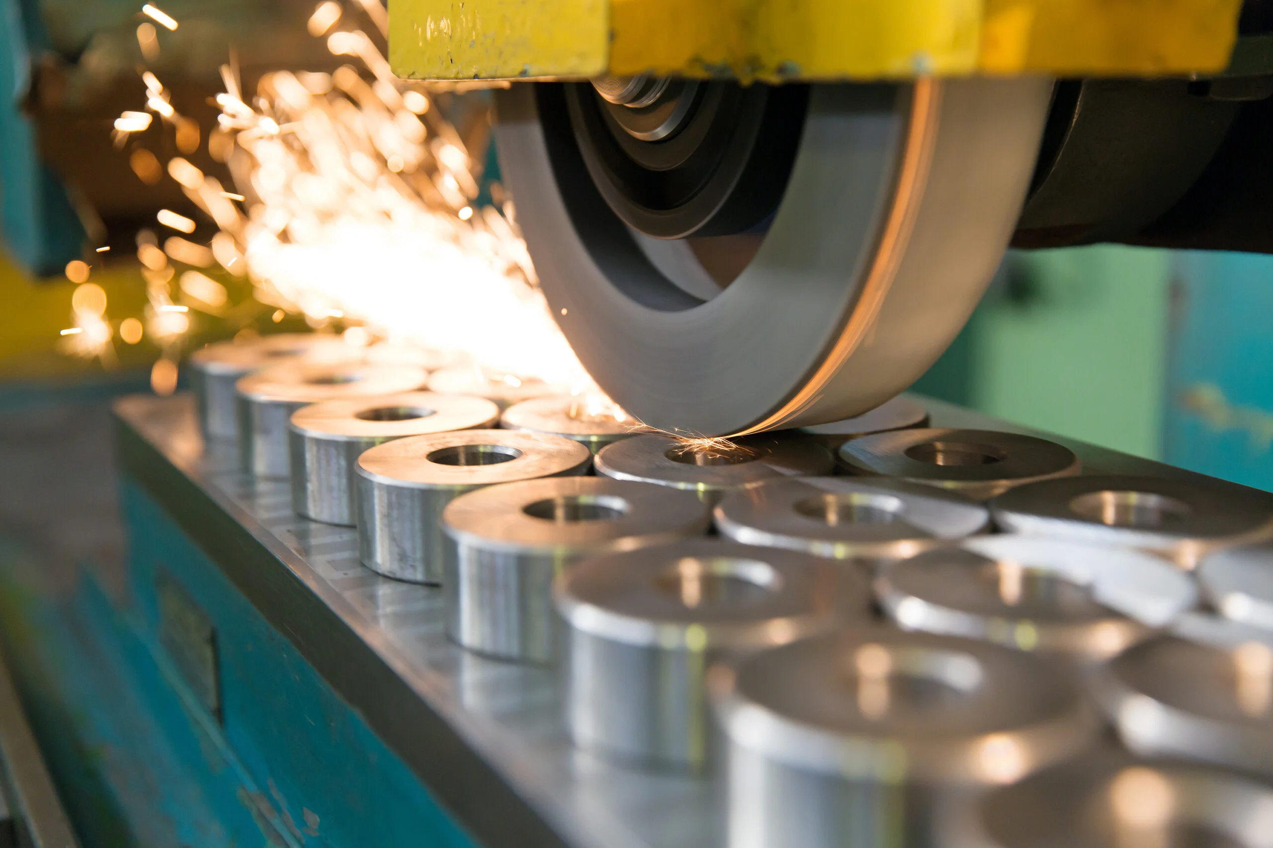

Cylindrical Grinding (OD Grinding)
In cylindrical grinding, the workpiece rotates between centers or in a chuck, while the wheel grinds the outer diameter. This process produces precise diameters with excellent roundness. Typical tolerances range from ±0.002 to 0.005 mm on the diameter, with an Ra 0.1 to 0.4 μm surface finish. Bearing journals, shaft diameters, gauge plugs, and precision pins are typical cylindrical grinding candidates.
Cylindrical OD grinding

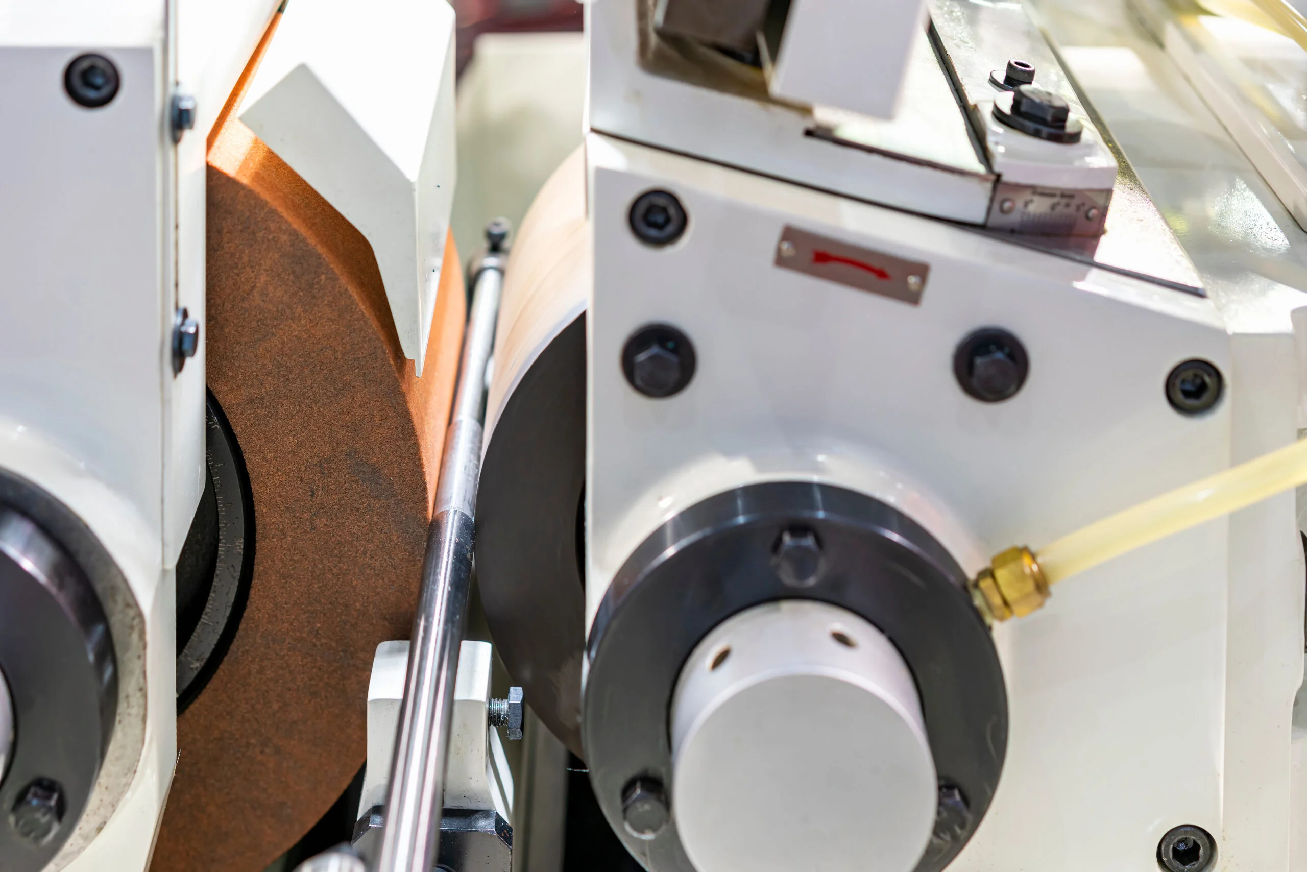

Centerless Grinding
Centerless grinding uses no centers and no chuck. The workpiece rides on a work rest blade between a regulating wheel and a grinding wheel, which makes it fast for long, consistent-diameter parts. This technique yields tolerances around ±0.002 to 0.005 mm in diameter. It’s the right call for high production of rods, pins, shafts, and fasteners where the length-to-diameter ratio makes chuck-based cylindrical grinding a hassle.
Centerless grinding a long rod metal part
Centerless grinding

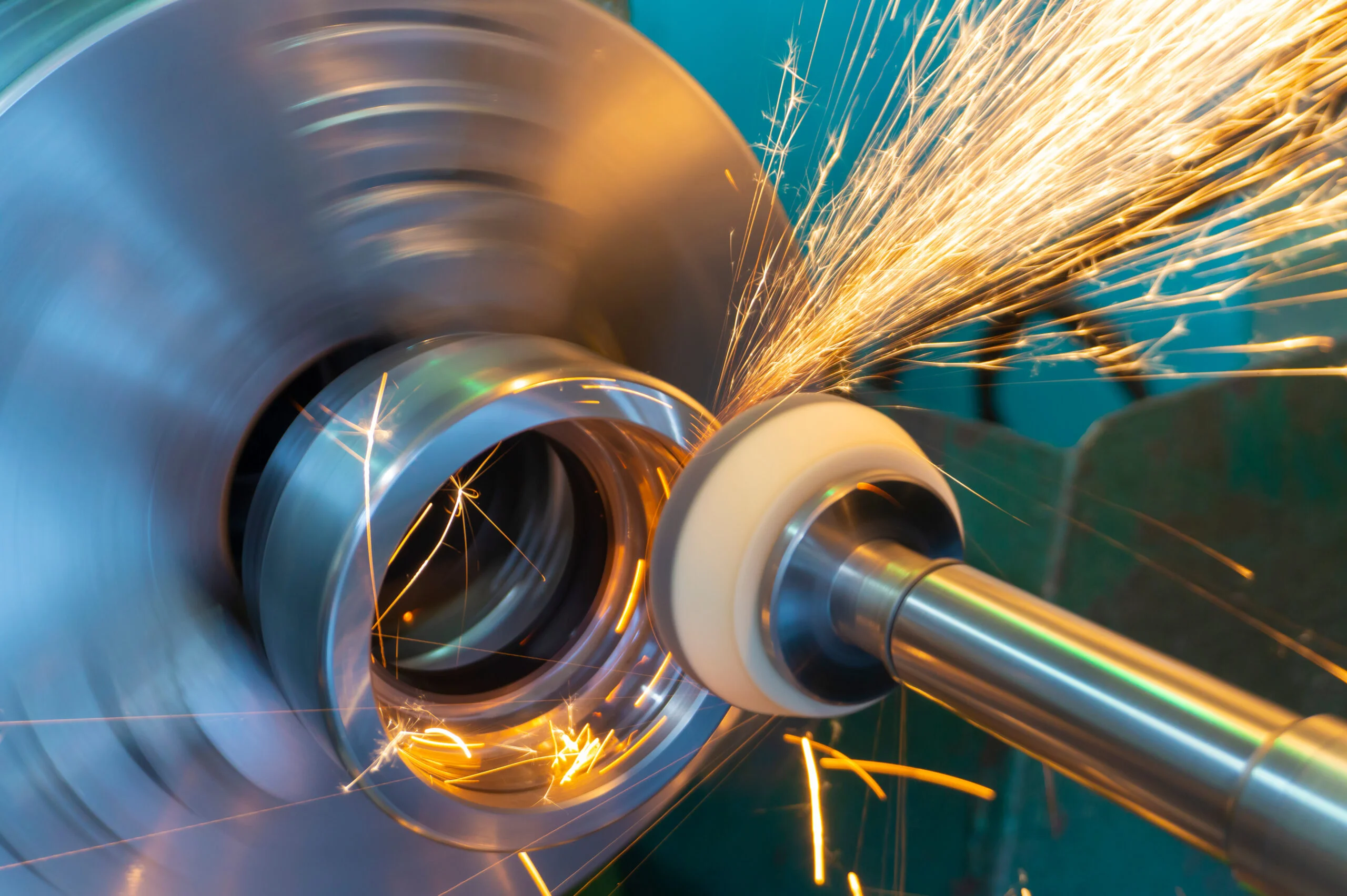

Internal Grinding (ID Grinding)
Internal grinding is used to remove material from the bore rather than the outside diameter of a workpiece, typically holding a ±0.005 mm accuracy. Bearing housings, precision bores in gears and pulleys, and sealing bore surfaces are the usual candidates for this process. Other internal cutting processes, such as boring or reaming, may get you close to what you need. If a housing bore needs a high-precision H6 or H7 tolerance, this is the process that gets you there.
Internal jig grinding
