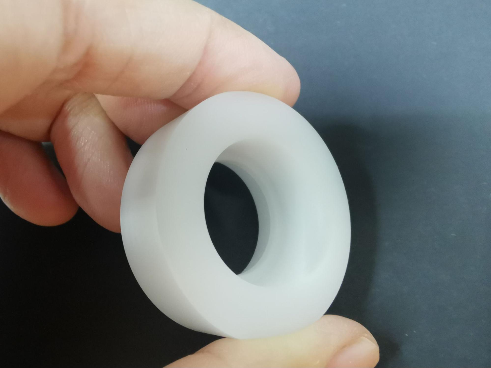

POM (polyoxymethylene), also known as acetal or the branded name Delrin®, is a high-strength engineering thermoplastic valued for its dimensional stability, ease of machining, lubricity, and excellent wear resistance. These characteristics make it a strong candidate for use in precision mechanical parts where low friction, reliability, and accuracy are essential.
In this article, we’re not talking about small dogs or pom-poms. We will explore POM’s most important physical and mechanical properties, its advantages and limitations, and how it compares with other engineering plastics, as well as key design considerations for engineers utilizing this polymer.

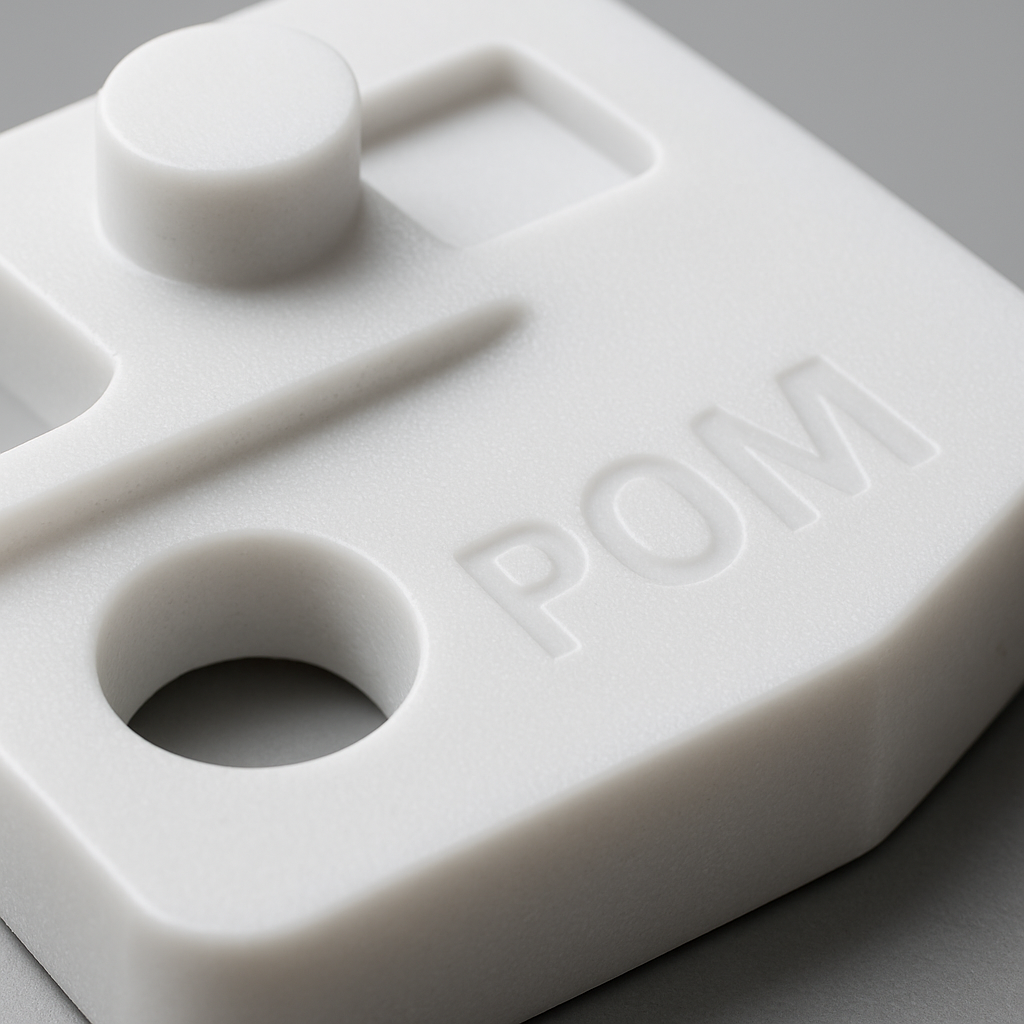

POM combines strong mechanical, thermal, and chemical properties, so engineers often turn to it for demanding applications. The natural color of this material is white, but it is widely available in a variety of colors. The table below summarizes POM’s key properties.
POM Material Properties Table
| Property | Value/ Detail |
| Tensile Strength | 6,000–11,000 psi (41–76 MPa) |
| Flexural Modulus | 350,000–450,000 psi (2.4–3.1 GPa) |
| Creep Resistance | Excellent under moderate loads and temperatures (grade dependent) ~1.5–3.0% strain over 3,000 hours at 21 MPa, 23°C |
| Melting Point | 165–175°C (329–347°F) |
| Density | 1.39–1.42 g/cm³ |
| Continuous Service Temperature | 85–115°C (varies by grade) |
| Moisture Absorption | Very low (0.2–0.5% by weight at 24h, 23°C) |
| Chemical Resistance | Resists most oils, fuels, weak acids and bases; avoid strong oxidizers |
| Electrical Insulation | Good dielectric strength (400–600 V/mil); suitable for circuit boards and electronics |
