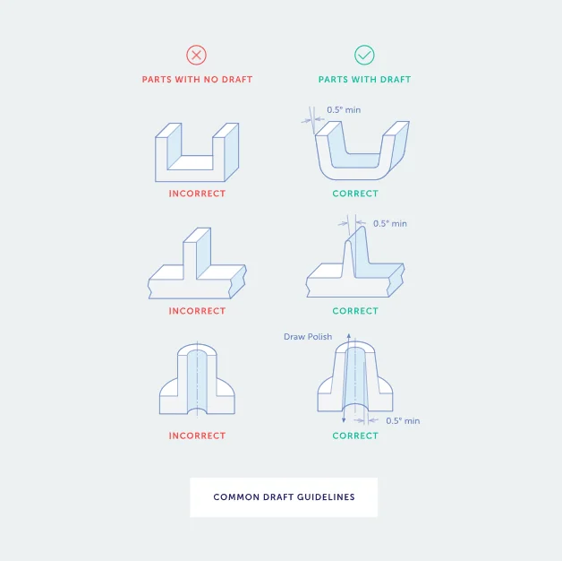

Fictiv’s Injection Molding Design Guide contains advice about draft angles for prototype injection molding. This free resource is available for download.

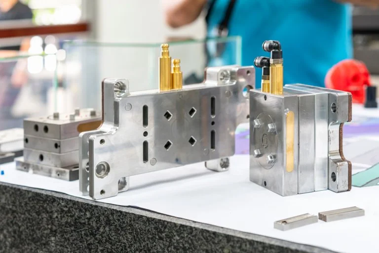

What’s the difference between a prototype injection mold and a production injection mold? It’s not about the metal that the mold is made from. Production molds can be made from aluminum or steel and prototype molds can be made from aluminum or steel. And it doesn’t end there. There are several different steels that are used in injection molds – and there isn’t just one kind of aluminum.

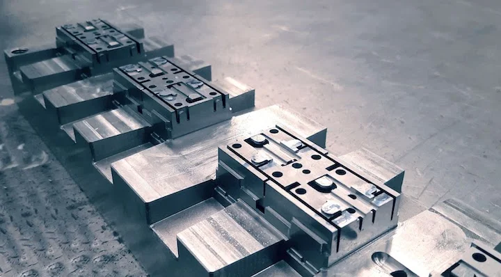

Aluminum is your least expensive choice, but it won’t produce injection-molded parts with tolerances that are as tight, or precise, as those with steel molds. That’s an issue if tight tolerances are required, but it can also affect tolerance stack-ups in assemblies with several injection molded parts. Aluminum injection molds can be machined to tolerances of +/- 0.005 inches, but steel molds can be machined to tolerances as tight as +/-0.001 inches.
Soft and semi-hardened steels typically cost twice as much as aluminum but don’t rule them out for prototype injection molds. These steels can achieve tighter tolerances and aren’t so difficult to machine that it takes months to cut a tool. When you work with Fictiv, you can get prototype steel molds in as little as 10 to 14 days.
Generally, hardened steel is used with production injection molds. It’s more expensive than soft or semi-hardened steels, but hardened steel lasts longer (i.e., more cycles) and can achieve tighter tolerances. Prototyping doesn’t have to produce millions of parts, of course, but what if you need tight tolerances for medical, aerospace, or other demanding applications? Aluminum just won’t do.

Fortunately, injection molding supports the use of multiple mold materials. For example, the base of a prototype mold could be made of aluminum or soft or semi-hardened steel. The inserts could then be made of soft, semi-hardened, or hardened steel. If your mold requires moving components such as lifters, those components could be made of steel as well.
There are also master unit die (MUD) inserts with a standard mold frame and customized, removable inserts.  MUD molds, as they are called, can lower the cost of initial tooling by as much as 66%. Yet they still support the complexity that many designers need for prototyping. If you need to modify your design, as is often the case with prototypes, a toolmaker can modify just the insert.

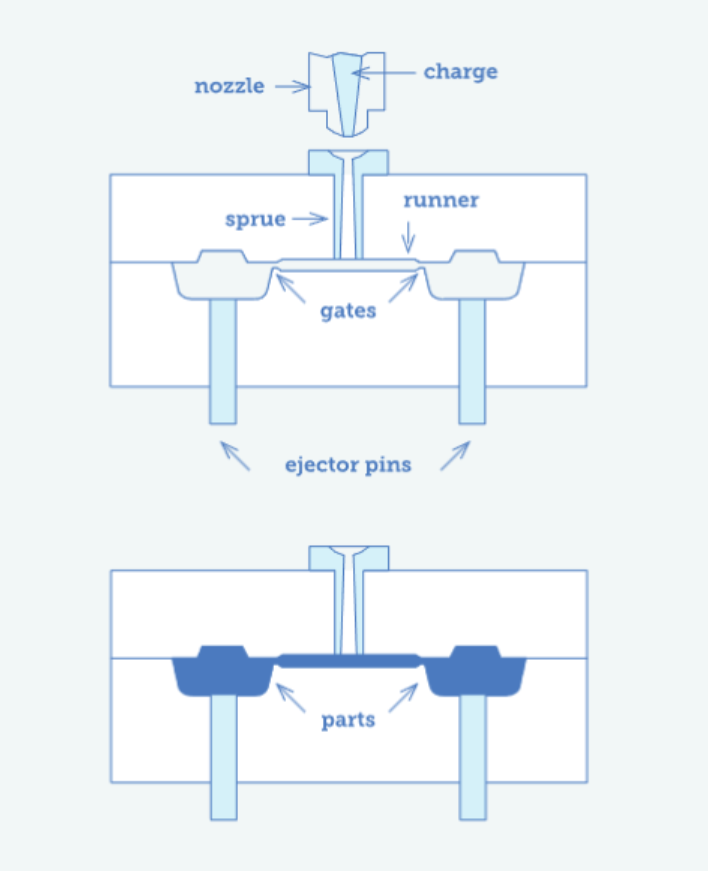

Finally, prototype injection molding ensures that your mold uses the right gate type and location so that the mold cavity fills evenly and the plastic is held under pressure long enough to produce parts with consistent quality. An injection molder can use mold-flow-analysis software instead, but that won’t put a part in your hands now, will it?
